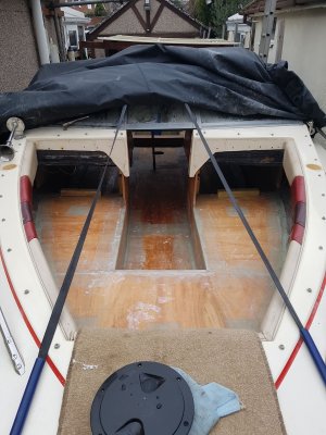

On inspection I found that whilst the hull was in excellent condition, the internal wood work was not. ‘Tide’ marks showed that the boat had been full of water for some time but due to the slope it was stored on, the engine was saved from immersion.
So I set about removing that which was rotten.
That turned out to be pretty much all of it.

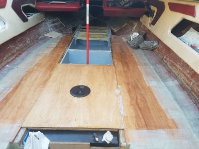

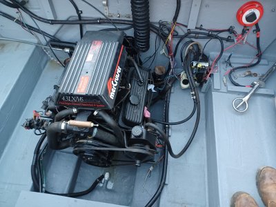

The engine was not much better:
The engine needed new cylinder heads, pistons, rings, crank regrind and bearings…. Amongst other stuff but it is now completed and sits in the garage ready to go back in the boat. At least there were a bunch of new parts that came with the boat, namely the water pump, and a complete new exhaust system… so that helped.. a bit.

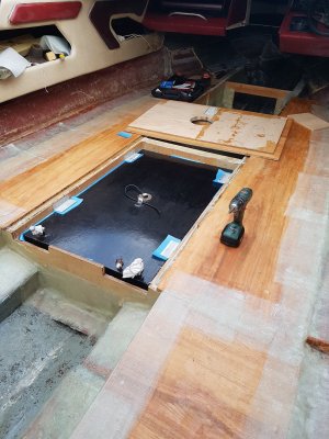

There then came a period of learning whilst I worked out how to replace the stringers, frames and floor in the boat. Plenty of Youtube vids on the subject as well as books and websites, all with different takes on what to do. I have extracted from all this information an approach that I have gone with which is to simply make the wooden bits from exterior grade hard wood ply, and pressure treated timber all glassed in using a mixture of chopped strand and woven mat.
So far I have managed to replace all the stringers and frames so that the floor is ready to go in.
The transom has been rebuilt also.

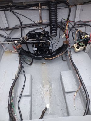

Brief update.....
12 months or so on and the stringers and floor are complete, fuel tank installed and the engine is back in the boat though not all connected yet.
Also new sunpad and seats are constructed but not fitted yet.
Trailer is refurbished.... found to be in remarkably good shape for 40 years of age.
Soon I will just need to replace the leg to have a test run.... and that is a problem.
The leg is about ten years old and looks great from the outside.
Turns out the inards are rusty, lower leg just about turns by hand, top leg is seized solid. Top off reveals rusty interior.
