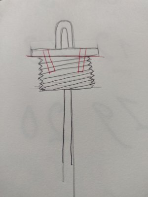

Could this be epoxied and make a decent repair, bearing in mind the force to do up and undo ?
Mine failed in exactly the same place years ago. The plastic seemed soft and had absorbed oil, making an adhesive pretty much out of the question. I managed to drill through the top and get two self-tappers into the thread section. Still going strong.
