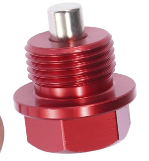

You can probably use an aluminium drain plug, M18 x 1.5, similar to M18 x 1.5 Ally Drain Plug.png to do a DIY repair
Out of interest could you measure the stick part of the dipstick and post up the dimensions, I may look into making some sensible priced replacements

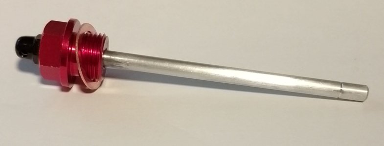

Could this be epoxied and make a decent repair, bearing in mind the force to do up and undo ?
@Caladh This happened to mine too. I went with a Cariblue replacement in the end - excellent quality, and although pricey at the time you soon forget about it once you stop worrying about how long it will be until the next plastic one breaks again.
Which gearbox do you have? I did buy a replacement Yanmar dipstick initially, which ended up being the wrong length for my gearbox. I think I still have it unused in a packet somewhere. If it is the right size for your gearbox, I'd be happy to let you have it for a more palatable price than a new one! Feel free to send me a DM if interested.

That very kind but I splashed out last week on a new Yanmar one. I’ve glued the old one and sprayed the s/s to use as a dipper so I can actually see more clearly the level. Yes I know I could have just bought a “plug” as posted above.
