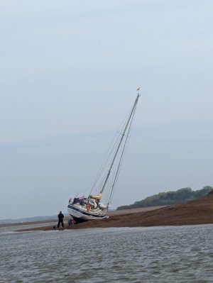

Photo of the first grounding this morning just by the Deben buoy.
Oops.
