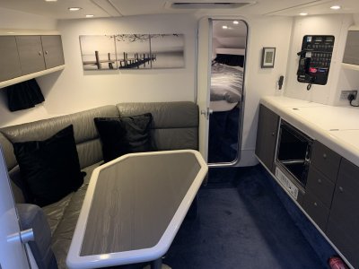

The saloon ceiling is now up and in:
It needs some warmth to get the last few dimples out from installing it, The bedroom ceiling took a few weeks for all the low points from handling the panels to drop out, It is now very smooth. The saloon ceiling has only been up for a few days and so far the saloon ceiling is looking pretty flat. Gravity and some warmth let the foam expand and flatten out the vinyl.

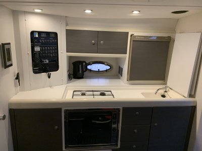

Then back down in the galley. A lot of small bits behind the scenes. The upper cupboards are pretty much done and the air fryer/oven in place for trial fit etc.
The other cupboard now has a plywood lining too. So it looks a lot more hygeneic and the cupboards are a lot bigger and tidier than the originals. I have built most of the frame for the lower level cupboards too. So will be making doors for them this week, hopefully.
The airfryer is a cupboard. It will have a shallow drawer below the airfryer/oven.

Galley cupboards made, doors on, they need adjusting a tad to get the lower ones properly square to each other. That's just a few turns on the hafele hinges. I should order the new worktops but I quite like the OSB now (Mrs A does not!) The big wide drawer doesn't look right so will turn that into two drawers - well it will look like two drawers to line up with the cupboards below, but will be one big on inside.

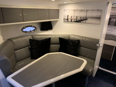

Then boxed in the port side saloon window to try out hiding/disguising the 1980s window frames. Looks OK to me. Then attacked the rather odd saloon "sideboard" which is pretty big with loads of interior space, but it had a weird sticking out section in the middle (see earlier pics). Fairline seem to have built bits of furniture then adapted them to a specific boat. My sideboard had a kind of "extension" added which made it stick out @ 5 inches. easy to remove but then discovered the two original doors are completely different sizes - so it's back to Wicke again for more 18mm ply. Wickes mind not any of that cheap B&Q carp!
