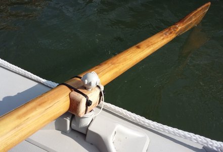

Sorry for possible thread drift, but can I ask how you adopted the wooden oars to that type of oar lock (pin through, fold down). I have a similar type of inflatable
Achilles Inflatable Crafts | Boats & Parts
that I would also like to put wooden oars on.
(For the OP: Very pleased with my dinghy, but it is not a budget choice).
Hi, see photo below. the little wooden blocks were initially held on with cable-ties until I was happy they were in the right place, then inserted two horizontal 4mm stainless screws in each block to replace the cable-ties. There is not a lot of load on the screws.
Thank you, interesting! That was an idea I hadn't thought of.

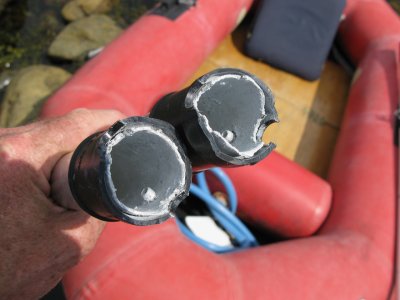

Agree, I have one of those Achilles inflatables too. OK it only gets light use but mine is 40 years old! I think it is made from Hypalon fabric, certainly not PVC. Well over twice the price of the WavEco
Yes, hypalon AKA CSM or synthetic rubber. Very hard wearing.
I also agree about the need for longer oars than those supplied.
However, aluminium tube oars (perhaps especially the type with a hole through them for the oar lock pin) have a nasty failure mode. That is why I am considering wooden oars.
