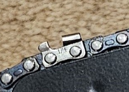

The chain is 1/4" pitch which is the smallest chain produced. The slackness is a puzzle though. You'd think they'd supply the correct chain with the saw, so check again to see if it's been assembled incorrectly. Saws come with the bar dismounted to save space, so it may have been mis-assembled when new.

That's a possibility. OP says they've been in there and adjusted it to the max, so they'd likely have seen if it was off the sprocket. Worth checking though, could have slipped off when the cover was being replaced.The chain hasn't come off the drive sprocket has it?
