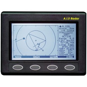

The NASA is a standalone unit, display only, no NMEA out, just little black AIS tadpoles, loosely based on a radar display
1709570570124.jpegI don’t have tablet and Navionics yet, just looking for a cheap upgrade way to get an accurate vhf based AIS overlay onto a plotter.
My 2006 Cobra plotter predates widespread AIS for leisure purposes, so it is unlikely to understand AIS info and overlay.
I’ll keep using my existing plotter under the sprayhood, but if I get a tablet as well for the overlay from a Quark, it will be bracketed somewhere viewable from the tiller when I need it.
