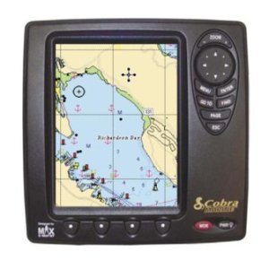

It’s a Cobra marine MC600i from 2006
I have contacted the UK tech centre for Cobra about NMEA in from AIS, but no-one works there who remembers this old unit.
There is no mention of AIS in the manual, it predates widespread leisure use of AIS.
It is working, still has plenty of valid tidal data, works very well for me for data fields, the charts are old but I rarely use them and the Coast around Pembrokeshire changes at a geological pace.
Others will know better than me but I have a hope that if it has NMEA 0183 it’ll display targets from an AIS outputting NMEA 0183 data. Tech not my strong point though.

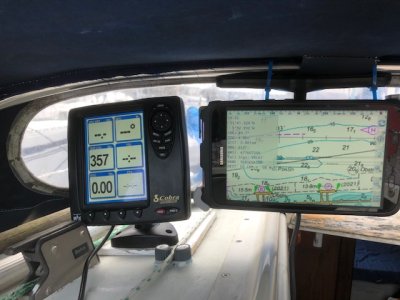

In the end I opted for a Quark024 rx, and a very cheap tablet package from London Chart plotters. Around £215 all in, and no ongoing subscriptions.
It seems to do what I want, it shows AIS targets with their headings and I can set parameters such as as safe passing distances. I have only briefly tried it though, more sailing planned over Easter. (That and a better install than cable ties onto the sprayhood frame)
I rarely use my old plotter as a plotter, it’s more for data such as SOG and VMG. I haven’t tried the plotter app on the tablet for anything other than the AIS overlay to keep out of the way of Ferries and LNG tankers, but I am very pleased with the price, quality and service from London Chart Plotters.
I haven’t had to pay an annual subscription for Navionics, but if my plotter needs ever change, and the Marine Navigator app and Raster charts don’t do it for me, the tablet is ready to download the Navionics app.

I have also connected my ancient Cobra plotter via nmea0183 out to the quark to get an accurate set of gps position, COG and SOG broadcast over the Wi-Fi network along with the AIS data.

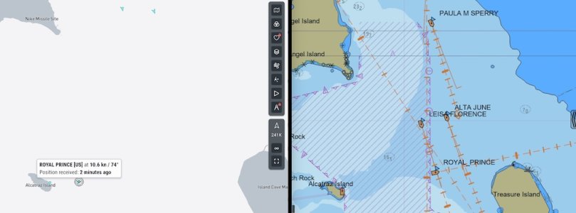

Here's just a quick side-by-side, MT on the left pane. MT suggests an update once per minute as a rule of thumb for those in range of shore stations. Do bear in mind that even live AIS is based on the other vessel providing correct data and can be subject to delay, but you can see here how even a short delay can be an issue. (Each tickmark on those vectors represents 1 minute of travel.)
