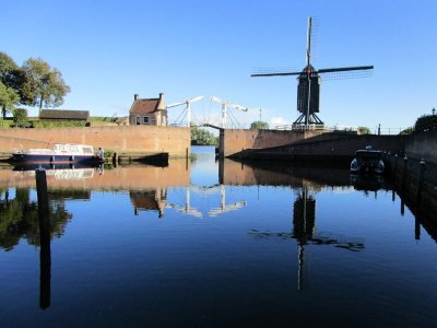

Heusden a fortified town on the banks of the River Maas (Meuse)

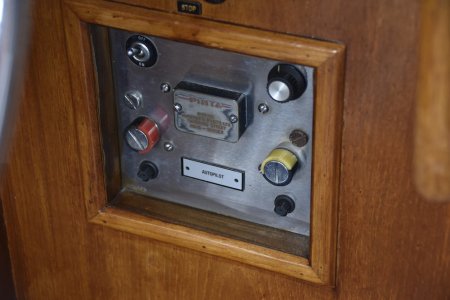

Oh the other thing was that the autopilot works, it just holds the boat on a certain heading, I was going to remove it after the previous owner said he could not get it to work, but after reading the manual for it and how it works it did work.
You have a compass in the bow with a light and a photocell, as the compass card rotates as you change heading then it generates a voltage from the photocell to the drive unit to power the motor that alters the steering to bring you back to the correct heading, but first you must set up the clutch slip on the motorised drive unit so it has just enough grip to alter the heading but not too much that it gets driven if the rudder gives an uncommanded angle change. you have to disengage the clutch to change heading and then reengage it.
Compass heading control unit under the deck in the bow cabin
Autopilot controls the "engage" "release" is repeated on the upper bridge
View attachment 183174View attachment 183175

That’s amazing 😊 worth a thread on its own.

The autopilot system is interesting - never seen anything like that. I guess it is original and has been on the boat since it was built. Worth keeping if it steers a good course as it frees you up to do other things such as navigation, radar checks etc.

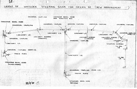

Think I might have mentioned it previously, but I loved the Whitlock steering on our Ocean. Very smooth and always had a sense that any failure was highly unlikely.

The Whitlock system is quite smooth and you don't feel any play in the system, even with all those shafts and universal joints in it.
The drive box for the auto pilot is just below the lower helm and right beside the steering shaft after the bevel gear, there there is a small cogged wheel on the shaft which is driven by the control box via a bicycle chain, I'm back onboard later this afternoon I'll try and get some pics of the bits.
The function of the autopilot differs slightly than that what I have in Pinta manuals, this looks to be a remote control system rather than the manual leaver you have to use to engage the drive, plus there is a "sensitivity" dial that you can turn up or down the amount of off course correction the system gives.
