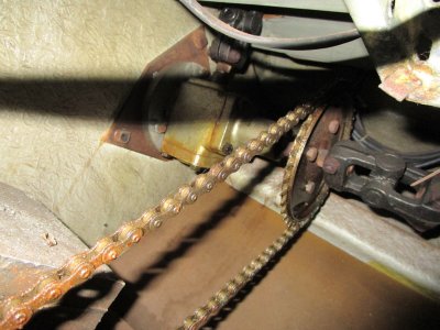

The Whitlock system is quite smooth and you don't feel any play in the system, even with all those shafts and universal joints in it.

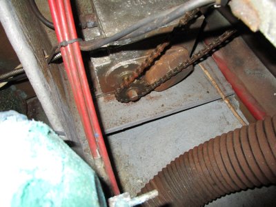

The drive box for the auto pilot is just below the lower helm and right beside the steering shaft after the bevel gear, there there is a small cogged wheel on the shaft which is driven by the control box via a bicycle chain, I'm back onboard later this afternoon I'll try and get some pics of the bits.
The function of the autopilot differs slightly than that what I have in Pinta manuals, this looks to be a remote control system rather than the manual leaver you have to use to engage the drive, plus there is a "sensitivity" dial that you can turn up or down the amount of off course correction the system gives.
This is the drive box: you can see the silver spiral wrapped cable, flexible drive really, coming into the box on the left, that takes the differential from the heading to the required heading and via the drive alters the steering via the chain drive to the line shaft from the helm
This is the other end of the chain drive where it is coupled with the line shaft, you can see the universal joint at the top of the pic it comes from the helm into the bevel transfer box, then the U-joint on the right is on the line shaft going aft to the junction box from the upper helm
I have 2 manuals for the autopilot they are similar but different and both different from how the one works on the boat but similar enough that I got it to work :)

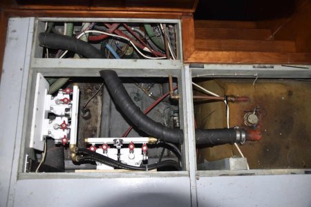

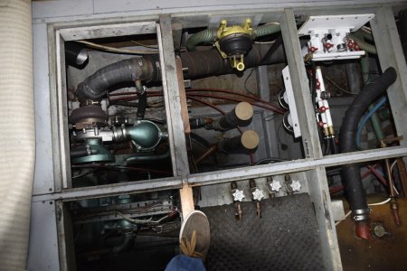

When talking about installing tanks I assume you mean the space in the keel when you say under the engines? I would think carefully about that as it does enable access under the engines with a bit of wriggling but be careful as I nearly got stuck in that space!

That thought had crossed my mind about the access to the engines, with the Racor fuel filters in way of the most obvious way to get under the engines and into the bottom of the bilge not 100% sure I could get in there.
The way in was in the centre at the front of the engines. I could lower myself in so I was standing in the bottom of the keel with my head in the saloon then drop down to a crouch and wriggle my head and shoulders aft so I ended up lying in the keel. I am 6’5” and having done it on a hot day to clean up oil under the engines I got stuck and genuinely thought that only the Fire Brigade and an angle grinder would get me out!
I got out by staying calm and ignoring the pain as I manoeuvred my carcass back to a more sensible location and never tried it again!😏
On a serious note, whilst it is doable size and flexibility are key factors so if in doubt don’t do it!

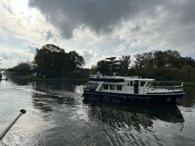

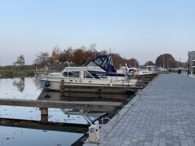

Moored up in Bocholt for the night. Youngest daughter and family came for dinner onboard

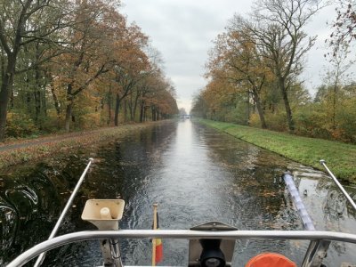

Arch down to get under the bridges and La Folie following on.
Weed was bad, normally make about 8km/h at idle, had to give a good bit of welly to get the boat above 6km/h, we let La Folie overtake as she has better protection on her rudder and propeller
