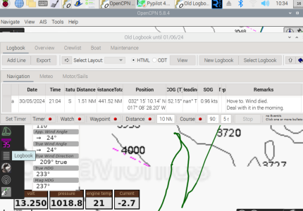

Very useful tool to have in the box for anything, make a cuppa, reef, do some nav, need a p@@? just heave too.. or like a couple days ago when enough was enough & bed was a better option.... 🙂

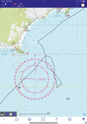

Here is me waiting for the wind down route to ease a bit. 3 hours hove too. Wind NNW boat heading was west and she just drifted SSE at 1-2kt over the ground and nothing through the water.
