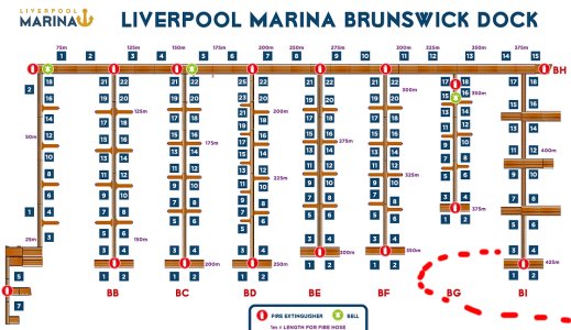

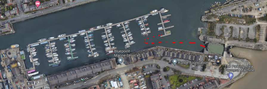

I called through to get my visitor berth a couple of days before, they said VB3. I checked on the map they have on their website and I couldn't see this berth, i called back up and we both checked the map at the same time (Both on the website. same page etc) which she then said it was BI (See image below) then Berth 3. The lock entrance is just on the right-hand side of this. So I thought Great - We can come in do a U-turn and come starboard side too as we have plenty of room.
This all went very smoothly. No issues at this point, We just put all the lines on and then the lock keeper said we were in the wrong berth, It was all the way to the other end. So now im a little unprepared as to where im going. We took the lines off and made our way to the end, Turns out it's BB3.
There is a gap in the building where the car park is and we only had a slight breeze but enough to slide the boat. It seemed very tight to turn into this bay due to other obstructions. Also by now, it's about half 9 at night so it's getting very dark.

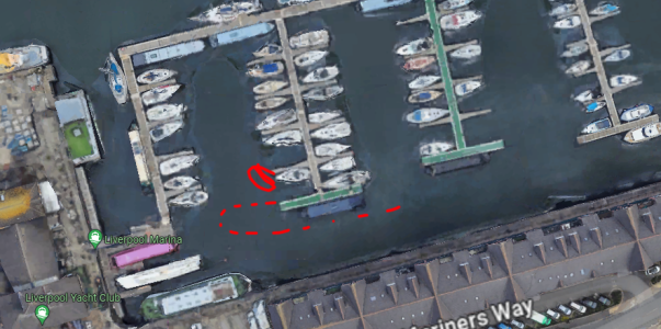

This is what happened:

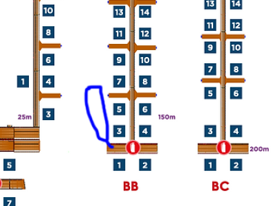

I attempted to do the same as before, come around and do a U-turn, but the breeze slid the boat over towards 5, i put it in reverse but the prop walk kicked the bow over more than 5. I tried a couple of times to get it back out but it was too late, luckily we got a fender in the gap and the lock keeper was a great help and managed to keep us off it.
This is how we ended up:
My brother managed to get off on 1 with a line and pulled us in, I managed to throw a line over a cleat and pull the boat in. So now we are in.

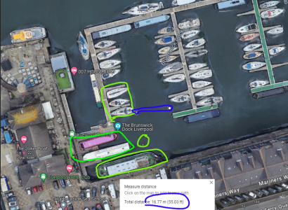

Below in Green is what currently is in the marina, The one I have circled is anchors or something, the fella told me not to get close to this as I was approaching as I was trying to take it wide to do my U-turn. The boats in Green were also in the births just to give you an idea of what I was working with. The blue with the dots in the width, its saying 16m. My boat is 11.4m.
As mentioned above I know it's inexperience but I do need to know how I could have handled this better.

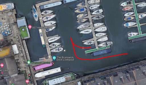

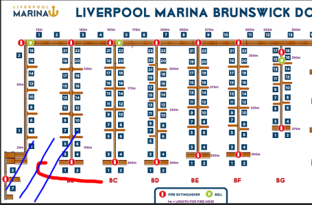

Should I have tried to reverse it like this?
Would the bow come across in time with the wind? As mentioned it wasn't much, about 8-10kts.
I spoke with Liverpool Marina on the confusion with berths, the fella said he will speak to someone to get the Map updated. I think the original pontoon I went to was the original visitor berth but they are getting work done on it so this is the new one and the map hasn't been updated.
Any help or suggestion you may have would be greatly appreciated.

I think you didn't do too badly. Your idea of reversing in might work - I notice most of the boats already in the berths have backed in. My own boat does not steer well in reverse, but if you can get your stern to the end of the pontoon, your crew can easily jump ashore and held you to get alongside.

Going in to a new marina always is a little challenging. Firstly I find it challenging even identifying the correct pontoon. I like to identify and escape plan if all goes belly up and ill have lines each side. Ill also have a long pole with something very soft on the end. Now for the Tricky bit. I actually think it just comes with time. no right or wrong way, Knowing your boat and how you can turn her in tight spots really will give you all the confidence you need. That way if it does not go to plan you can get yourself out of a impending disaster. Sound like you coped well given the small area you had to turn and the wind to contend with

If mooring next to 5 was an option, and warping across was possible, then sometimes a useful backup plan. Make sure fenders rigged both sides before coming in. Even with no lines attached, once alongside and upwind you probably won't go anywhere, and have the time then to sort things out.

I drop a line onto the end of the 'pier' that makes up the berth while side onto the end ...... use that to pivot the boat in and not let wind drift her wide onto 5. As she pivots in - drop a line from stern to stop it getting out of line ...
Alternative ... if berth 1 is OK to use .... side up to BB1 - lines over - then walk her round into BB3. Even with a boat or barge on BB1-2 ... you could do that.

On my boat it would be best not to try and motor directly in, but to point into the aisle and then reverse into the wind, ending up stationary in a position aft of the red vessel in space 5, pointing more or less into the berth. Although my boat is not that handy, it does have a big kick to port in reverse and the wind would also be helping this manoeuvre
Going forward, my prop walk would help the turn into the berth, I might end up alongside the boat in slip 5 but it would be safe.
This is with academic planning though, God knows what I might try on the day.
It is tempting to motor into the aisle, turn around to starboard and then into the berth on the way out, letting the momentum and sideslip take you in. However it looks tight and should you fail to get the bow through the wind, on the turn, you are well stuffed and end up marooned alongside the barges at the root.

Obviously without a decent understanding of the space and conditions, one option possibly could be to make a sternboard from all the way outside the main row, past the berth and up towards the end. Then, motor forwards and turn to port into the new berth, with a fender placed well forward on the starboard bow and a bow spring ready to deploy. So, effectively your alternative you suggested but going much further up.

With regard to your plan to go forwards into the lane and then reverse into the berth…..
I have a very tight berth to get into at my marina and I want to park the boat stern in first. The obvious solution is to drive down the cul de sac then reverse into my berth, exactly as you suggest.
After a couple of attempts I realised this was not working for me. This is why…….
As you slow down, stop the boat and eventually start going backwards you have virtually no control over the boat and you are totally at the mercy of outside elements for quite a long time. This is a recipe for disaster.
Now I reverse the boat all the way from outside the marina to my berth. It’s a bit challenging but at least I have control over the boat throughout.
