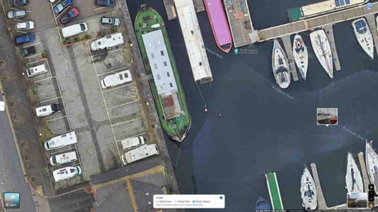

The marina numbering system looks a bit nuts, no wonder you got misled tom.
With the wind from the top left I am not feeling the love for hanging on the end of the pontoon with warps on a 37 foot boat. Poking your nose in the aisle, then reversing up towards the pink barge, then going in forward could work ok.
Hi Doug, Yes that does actually seem like a good route. Even if the wind were to push me I would end up in bay 5 and then can pull across with lines.

Excuse the slight corporate speak... but to me the biggest learning to take from this is not the specifics of how you should have got into that berth, it's that you didn't have a "go around" plan.
Whenever I set up an approach to an unfamiliar berth that looks a bit "interesting" the first thing I look for is "where's my out?" If this isn't looking right, at what point am I going to admit defeat and go around, and what does that look like?
In this case, and going only on the diagram, the bail out plan seems relatively straightforward. Essentially as you start turning into the aisle, if it starts to look like you're not going to turn all the way into the berth, then stop trying to and just aim straight down the aisle, knock the engine into slow reverse and allow the boat to weathercock with the stern into the wind. You can sit there pretty happily whilst you work out what next.
Looking at the actual plan to get in there, what you decided on, i.e simply turning round through 180 to come in forward, might look like the most straightforward option, but it is in my eyes the plan least likely to succeed.
Remember that unlike cars boats don't follow an exact turn, but they "wash out" as the boat slides sideways through the water a bit. And this is greater the tighter the turn. Therefore trying to berth on the inside of a tight turn, with the wind blowing you off, and propwalk that kicked you away from the pontoon was always going to be super tricky, every external influence was taking you away from the berth. A good rule of thumb is to look at the external influences and see if there's a way where you can get at least some of them working in your favour.
I'd also suggest that this was not an occasion for "slow and steady" but a case for plenty of power and stop the boat quickly before the wind takes charge.
Any plan that involves going up the aisle, either forwards or backwards, and then coming at the berth from that direction with the berth on the "outside" of your final turn in has a much higher chance of success, as at least then you have the "wash out" of the turn sliding into the berth. I think I'd have got the boat going astern in plenty of space out in the main "channel" then headed down the aisle almost to the end, quick burst of hard ahead to make the sure the propwash gave me control and the wind didn't take charge, then a reasonably fast approach to the berth at a relatively steel angle, final turn to match the berth angle and a burst of astern. Some relatively competent line handling and I'd think I had a decent chance of that working. And the beauty of that is that at basically any point there I have an easy out if I don't like what's happening.
