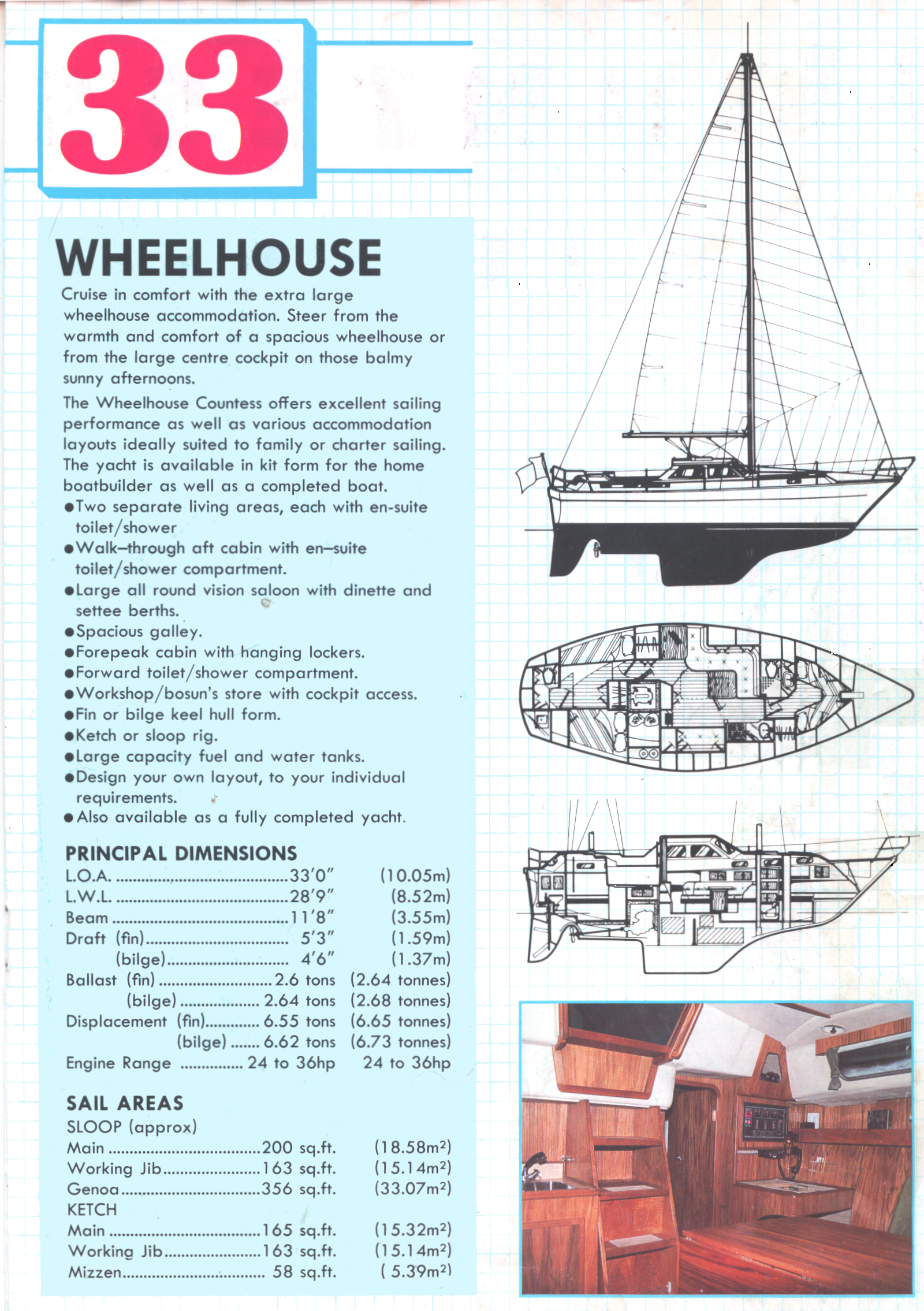

I couldn't tell from your early video, Greg, whether you've decided on an internal layout.
Thirty years ago I spent most of my time drawing layouts (not very practical) for yachts whose interiors I didn't much like...
...but I have to say, I've always found paper, pencil, eraser and ruler a lot easier to design with, than high tech equivalents.
Somebody drew a Countess 33 interior (below)...I found the layout by Googling. I reckon she's not the deckhouse version.
It's very clear, if not millimetre-accurate...she looks a lot beamier than she ought to be.
But may we see your planned interior? Just to give us an idea - I know how things evolve when difficulties emerge.
