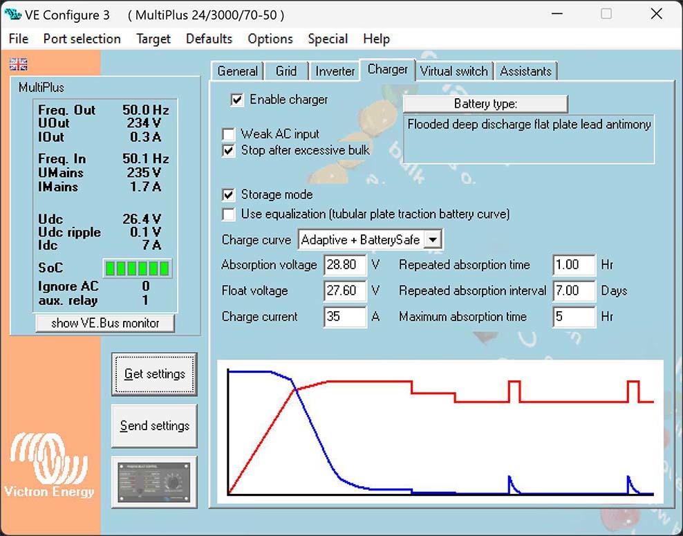

Anyway, below are the VE configure tabs that left me with some doubts:
1) "General" tab - nothing special here, just included for reference.​
Note the AC limit to 30A, as I previously mentioned.​
That aside, I left (not only in this screen, but also in the following) all the parameters I'm not mentioning in the same status I found them.​
In this screen for instance, this is true of the unflagged "Dynamic current limiter", whatever that is (?), and of the 85%​

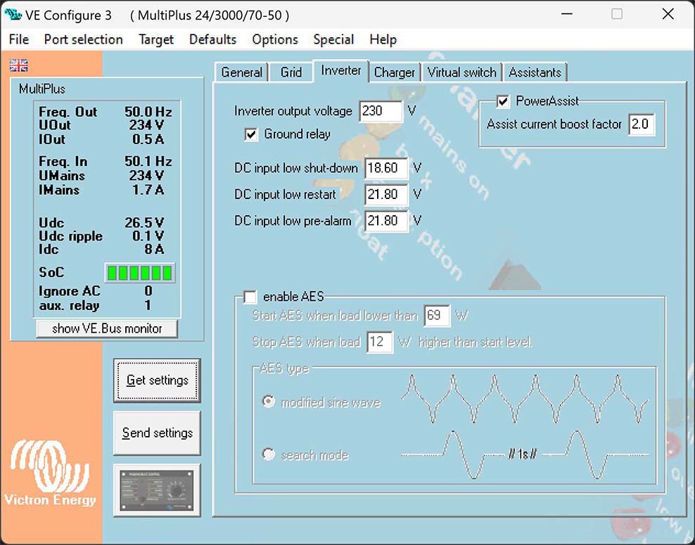

2) "Inverter" tab - what's the (default flagged) "Ground relay"?​
And would you suggest to turn on the (default off) "AES"? I found contrasting indications on that, on the web.​
3) "Charger" tab - aside from selecting the appropriate battery type, I left all default value, but also here I'm open to suggestions.​

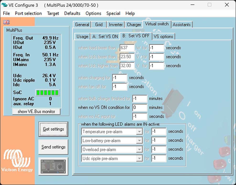

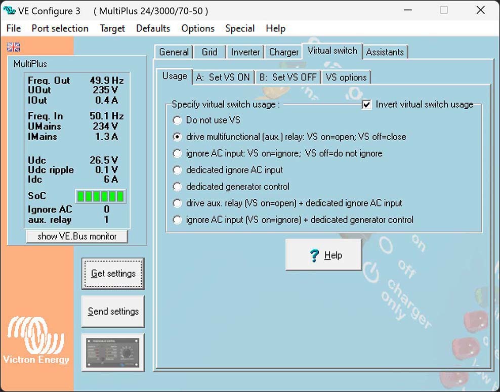

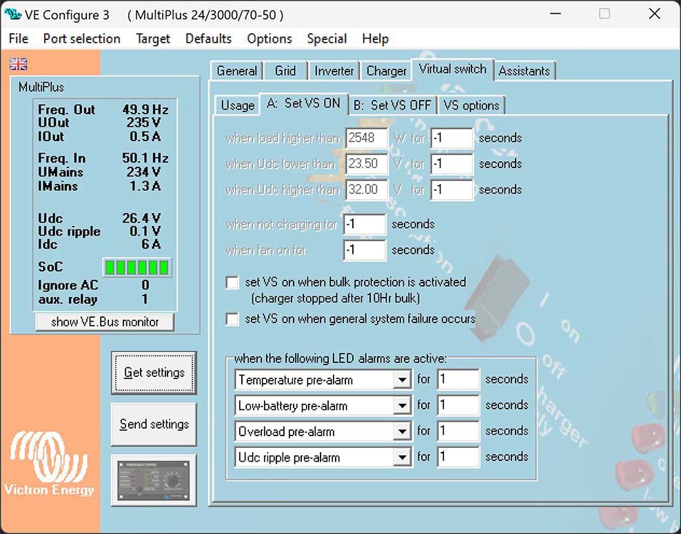

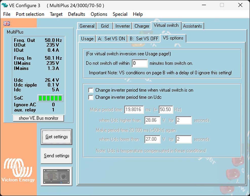

4) "Virtual switch" tab (and its sub-tabs) - am I right in assuming that if I'm using neither the automatic genset startup nor any external alarms I could as well flag the "Do not use VS" box in the first screen and forget all the rest, even if the unit came with the configuration below by default?​
5) "Assistants" tab - not much to say really, except that it suggests (sort of) that my unit is in need of a firmware upgrade?​
Which I'm willing to do, particularly if it could also eliminate the buzz, but ATM I can't find a way to make VictronConnect see my unit, aaarumph!​
Apropos, aside from possibly finding a MK3 interface and see if the MK2 I'm using is the reason why I was unable to run it, do you think the bluetooth VE.Bus Smart Dongle would work equally well?​
If yes, I guess it could be worth buying one, also as a mean to check the Multiplus status on my mobile, in the same way I'm now doing for the SmartShunt...​

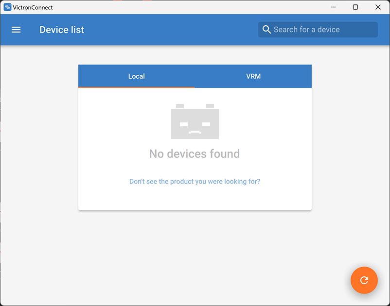

In the meantime, I can confirm that I did install on my Windows PC both the Victron Connect and the VE configure programs.
But while the latter works just fine with the MK2 USB interface that I'm using, the former doesn't see the Multiplus at all.
I feel it might be a compatibility problem with the older interface, but as of now I don't have a MK3 USB interface available to try...
I would guess that Victron Connect is bluetooth only.
As post #9, make sure you have the latest drivers installed.. Just be sure you are not running VE configure when you try to connect Victron Connect.

No, Victron Connect cannot be used on Windows via Bluetooth, it only works with a wired connection.

Missed this when i first replied, try the USB drivers. Victron connect is more modern that EV-Configure and you might find it more intuitive.
Leave this on for the RCD to work if you're not on Shore power.
No leave it off.
If it isn't needed, i turn it off.
See comment ref drivers
Victron Connect won't work on a Windows PC if using Bluetooth. I'm also pretty sure that if using it on Bluetooth you can't configure the Multi
I'd be inclined to buy the MK3. But, if you want to monitor it on your mobile you'd need the Bluetooth dongle, but a Cerbo would be a better choice, albeit more money.
The PC automatically installed some USB Microsoft driver upon connection of the MK2 interface, but I did replace it with the Victron-specific one that I found on their website.
Made by FTDI rather than M$, according to the driver details.
But coming to think of it, I might have had also VE configure already running, when I launched Victron Connect and it didn't see the Multiplus.
Tomorrow I'll give it another try running Victron Connect and nothing else, and I'll report back.
In the meantime, many thanks also for all other indications, very useful! (y)

Assuming that eventually I'll find a way to upgrade the firmware, and assistants will become available, is there anything worth considering in them?
Hard to say without knowing how you plan to use it.
Looking at the Victron Connect manuals they only mention the MK3 interface, so i suspect it won't work with the MK2.
Well, the usage I'm envisaging is actually very simple - compared to the many features of the unit, anyway. Essentially:
When docked and connected to shore power, I'm going to use it 24/7 on "charger only".
In fact, on one hand what Victron call power assist is something I never need.
And OTOH, the UPS-alike capacity of taking over AC from batteries in real time as soon as shore power goes down for whatever reason (which BTW I tested, and works amazingly well!), while very convenient theoretically, I think would be somewhat risky in practice. In fact, since we live aboard for months, we have AC equipment running at any given time, possibly including high current demand equipment like airco, boiler, washing machine, dishwasher, cooktop. So, potentially, if the Multiplus would be fully on rather than limited to "charger only", the shore power could go down while AC absorption is rather high but still within the 3Kw inverter capacity, hence killing the batteries PDQ, which I don't fancy!
So, charger only while on shore power it is - and if/when shore power is down, I'll decide what to do on a case-by-case basis, depending on needs.
While cruising or anchored, I'll fire the genset whenever we need to cook etc., and also in this case the Multiplus would be useless other than as a battery charger.
BUT, since I love the complete silence at anchor that any genset is bound to ruin (even if mine is one of the quieter I ever came across), I would use the inverter whenever AC is needed for low load equipment and shortish periods of time, like mobile chargers, TV, coffee machine.
Of course, this usage requires switching manually the mode on the Multiplus, but I don't mind doing that because it's easily reachable, and I prefer to be in control of who's doing what onboard, rather than rely on automated procedures...
So, at a guess, I suppose Vas is correct in being skeptic about the usefulness of these "assistants", whatever they are - but happy to stand corrected on that!
Yep, that's what I also suspected, and I believe it's the reason why Victron Connect doesn't see the Multiplus at all, while VE configure does.
I just tried to run the former alone, right after rebooting the PC and without launching the latter at all (based on your suggestion to NOT run both softwares together), but Victron Connect still can't see anything... :cry:
That all makes sense, for how you want to run things.
There are ways you can automatically do some of that, such as split the system into high current devices and low current devices (such as TV, chargers etc). Then, if shore power goes off, the high current loads go off but the low current ones continua working. But, if you're happy with the above, that's fine too.
Given the above, the assistants will be of no use to you.
By pure coincidence, i've been setting my own system up to maximise solar yield etc and came across this in the solar priority documentation this morning ;
"Configuration
• Via VictronConnect (requires an MK3 to USB interface)"
So that confirms our suspicions, you do need the MK3 device. I would say it's well worth having.
