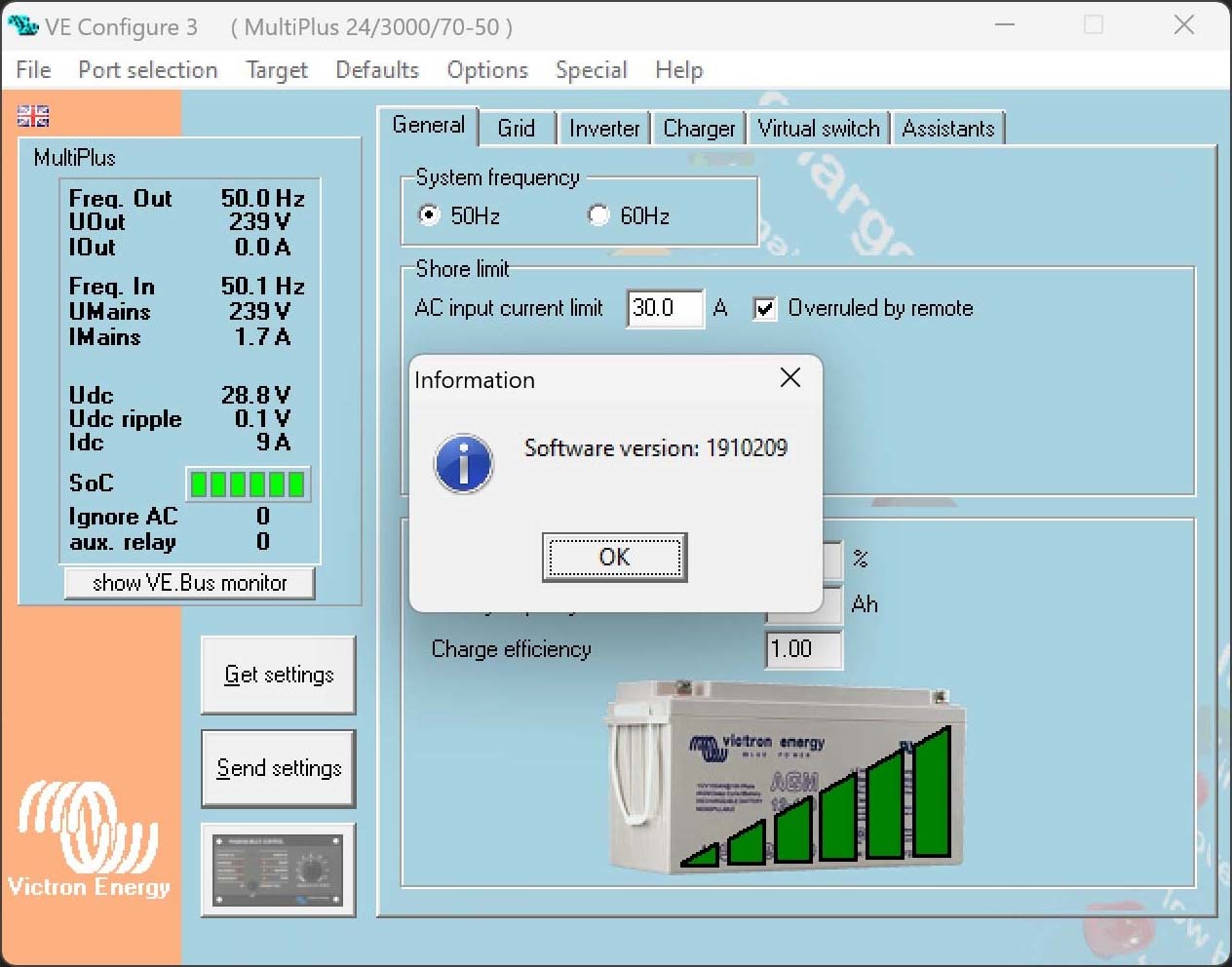

I installed the 1910209.vff firmware with VE flash, which ran smoothly.
A first check with VE config confirmed that the unit is now running on the new FW:

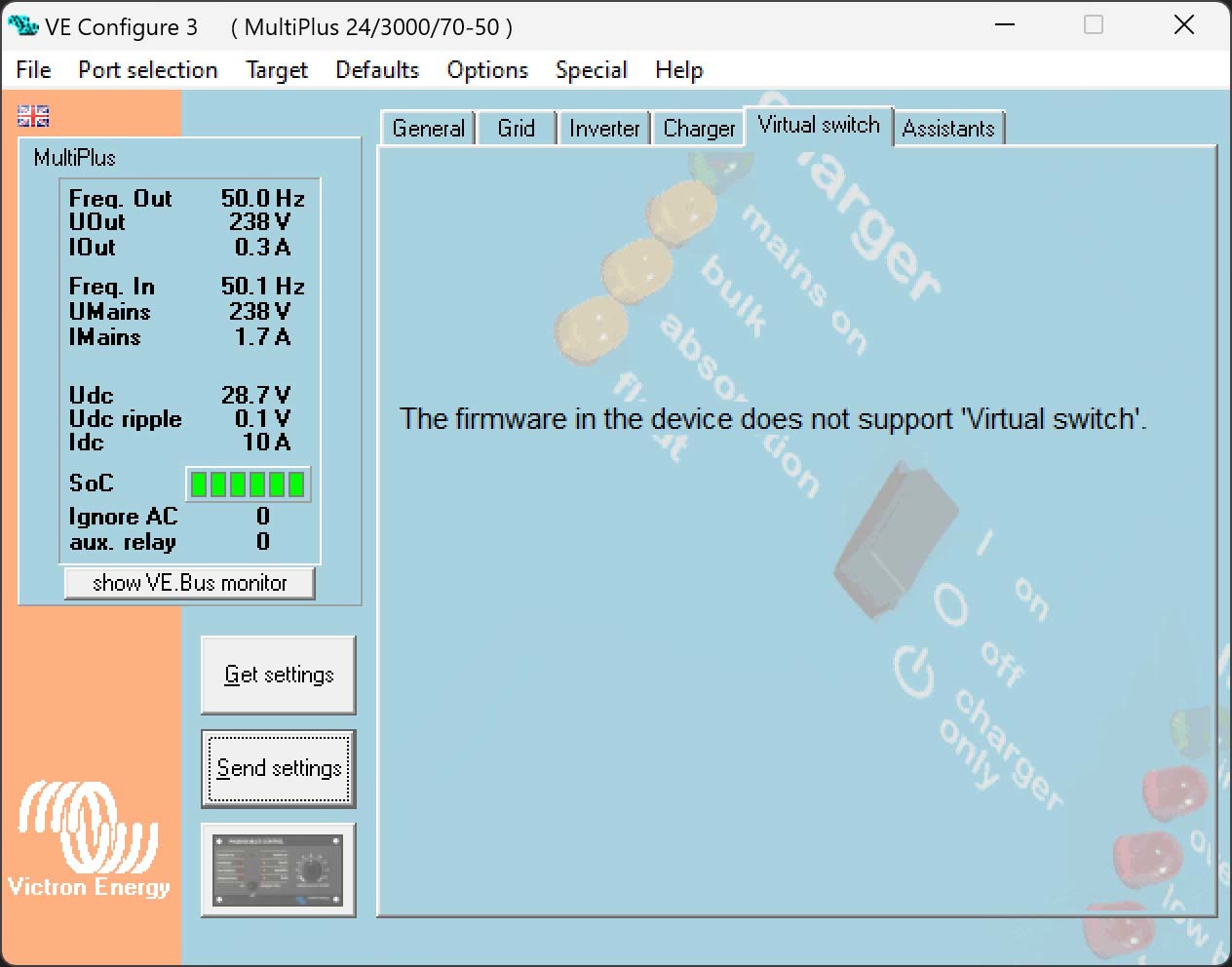

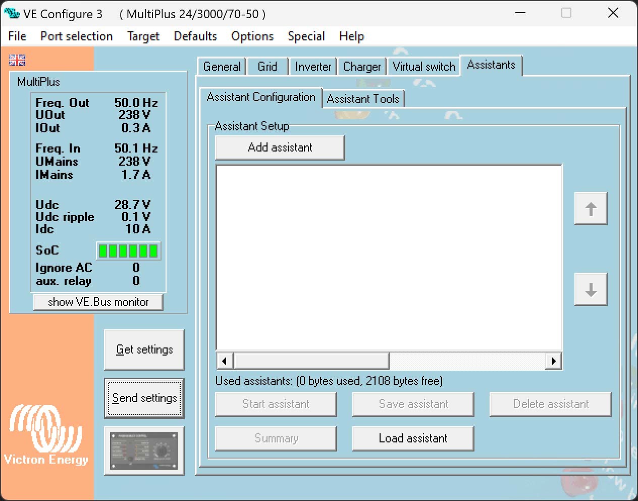

Furthermore, since according to Victron website this "200" series FW should enable the assistants but lose the virtual switch, I checked the respective tabs, which appeared consistent with what they said on the tin:

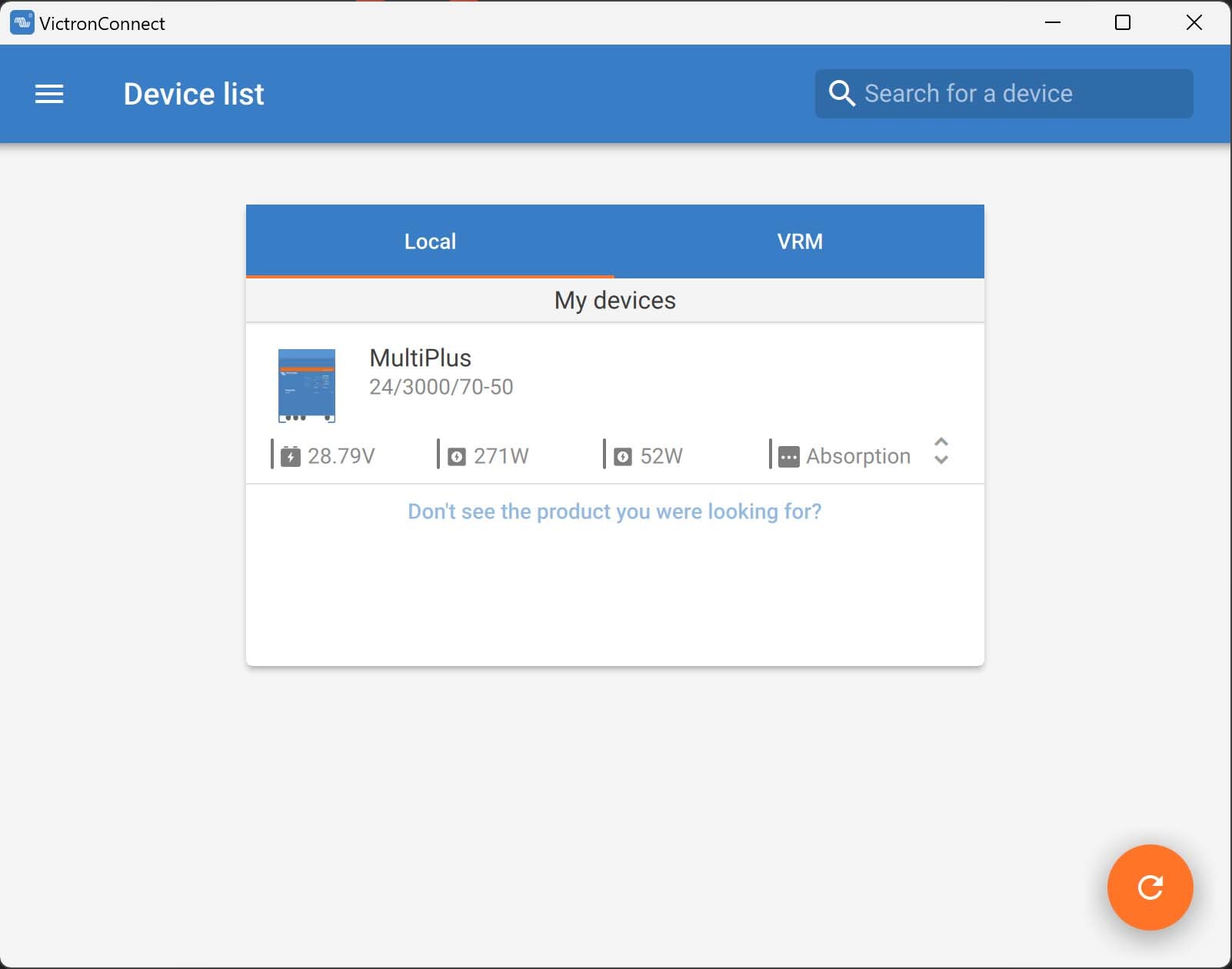

So far so good, but did this also enable the use of Victron Connect? Well, yes and no.
In fact, the software now sees the unit correctly (while previously it just said that FW 200+ was required):

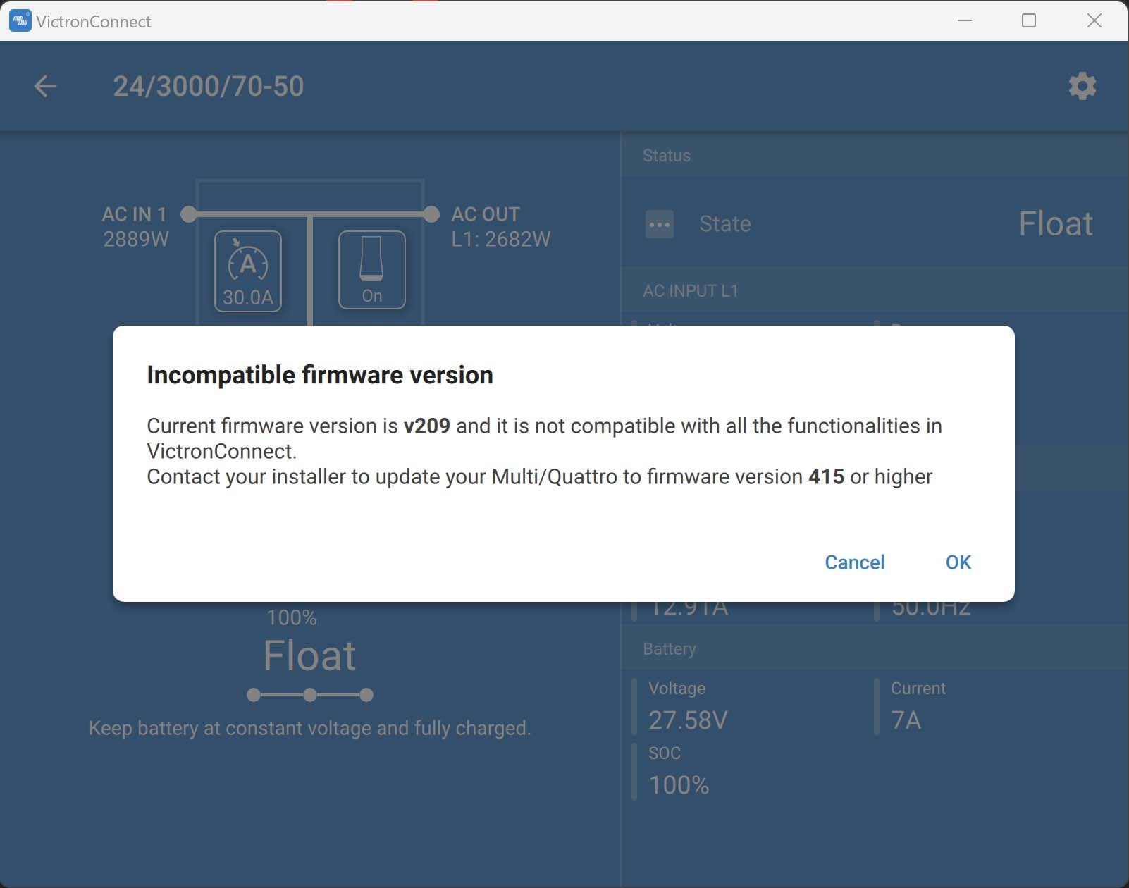

But after clicking on the unit, the following message pops up:

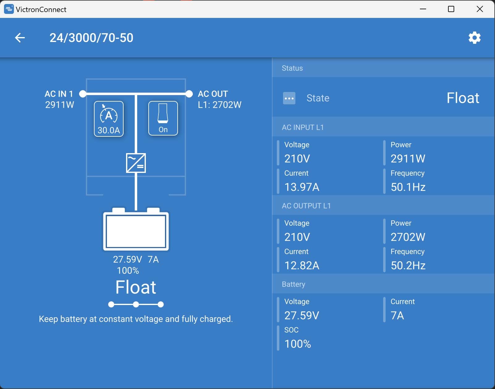

And after clicking on OK, the following screen is all I can see.
By clicking the gear icon, I only get another message confirming that Victron Connect requires 415+ firmware for full functionality.
Trouble is, 209 is the latest FW available in Victron website for the 1910 version of Multiplus, so I guess it's game over with regard to additional features available.

If I am confusing the issue, apologies! Looking at the ac IN it would appear that, if this is your shore supply it is a tad low (In the UK, the declared voltage and tolerance for an electricity supply is 230 volts -6%, +10%. This gives an allowed voltage range of 216.2 volts to 253.0 volts.) If this is your shore supply you may wish to get the marina, or such like, whoever you are connected to, to have a check as to why it is not within limits. Could of course be your cable, what is the type and Cross Sectional Area (CSA) of that?
I am assuming you are in the UK.

You're not confusing anything, so no need to apologise.
Rather the opposite, in fact: well spotted, and thanks for highlighting it.
Your only mistake is the final assumption, because I'm in Sardinia, and I can't be positive about the allowed voltage range in Italy, but nominal voltage should be 230 also here, and 210 is indeed unusually low.
All that said, it's a problem I'm already well aware of, and is neither related to the grid nor to my boat and her connection cables.
It's just that the main shorepower line along the dock where I'm based is occasionally a bit stressed by unusually high loads, all from single phase users, which potentially creates also un unbalanced load on the main 3-phase supply, depending on which sockets are being used (each pedestal having multiple single phase sockets connected to each of the 3 phases, but not labelled in such way that you can decide whether to use 1, 2 or 3).
So, when this happens, either the load exceeds the total line capacity and trips the main 3-phase OCPD breaker upstream of the dock line (but that's very rare), or we experience some voltage drops like the one you correctly spotted.
For this reason, it's all a bit unpredictable, but so far we never experienced any practical problems, so it's not something I'm too concerned about.
And IIRC, the default lower limit that the Multiplus tolerates is 200V, so it seems that they designed these units knowing that voltage drops can and do happen...
Just for the records, I'm seeing 228V as I'm writing.
But thanks again for highlighting that, anyway! (y)
