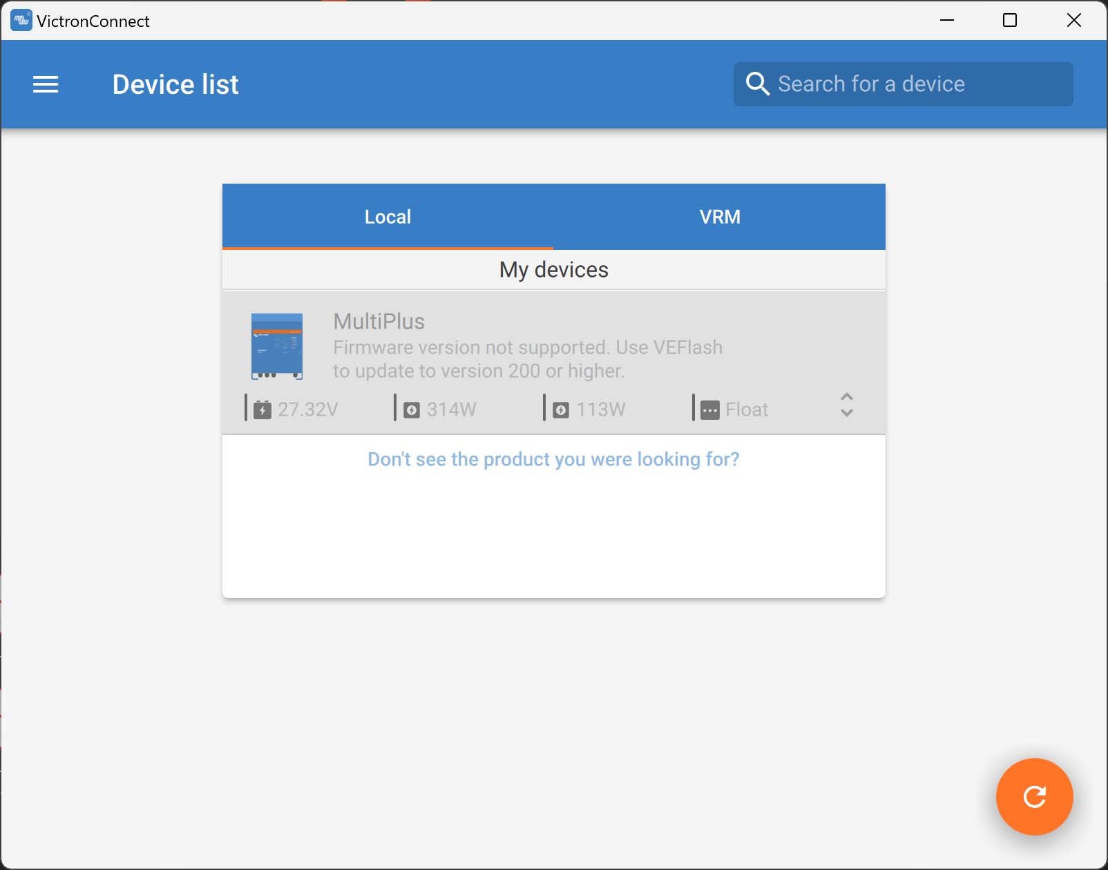

I just received the MK3 interface that I bought, and now the program Victron Connect does see the Multiplus.
So, our conclusion that I previously couldn't see it just because I was using the MK2 interface appears correct.
But that's the one and only good news!
The bad news is that Victron Connect still doesn't really handle the unit, because right after founding the Multiplus, it comes up with the following message, and doesn't allow me to do anything at all.

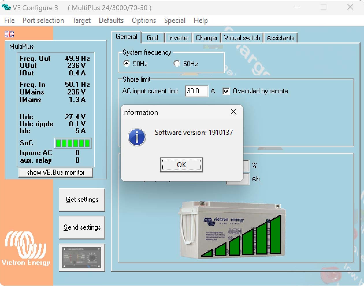

Now, VE Config (which works just fine, as it did also with the MK2 interface) tells me that the software version installed is the following, and I have no idea about how it compares to "version 200" that Victron Connect requires. Maybe it's the last 3 digits, i.e. 137 vs. 200?
Anyway, I tried also VEFlash, as suggested by Victron Connect, and the program as such seems to work just fine.
But it only allows to upgrade the firmware from a downloaded file, which I don't have and I don't know where/how to get - so, I'm stuck!
My understanding was the Victron Connect takes care seamlessly of firmare update, but Victron Connect doesn't work with the current firmware.
A catch 22, sort of!
Bottom line, if anyone can suggest where I can find and download an appropriate firmware upgrade for my Multiplus, I'm all ears.

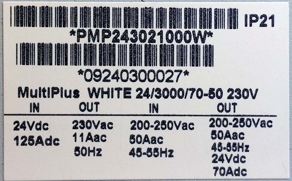

Just in case it may matter, below is the S/N label.

MapisM
11 Mar 2002
20,486
Ok, soooo... Here's what I think to have understood.
1) the 7-digits "software version" is made of the first 4 digits representing the exact unit model, and the last 3 are for the firmware version. So, it appears that my previous guess that 137 is the FW installed, vs. 200 that Victron Connect requires.
2) among the first 4 digits, the first two represent the microprocessor, which can be either "old" or "new": 19 and 20 identify the old micro (230V and 120V respectively), while 26 and 27 are the new micro (again, for 230V and 120V respectively). Third and fourth digits are for the exact model (12/2000, 24/3000, etc.), but that's not so relevant.
3) so, considering the 1910137 that VE config gives as "software version", the HW code for my unit is 1910, whereas 19 means (unsurprisingly, at this point) that it has an old micro.
4) now, the website PR linked in post #26, among gazillions of other things beyond my pay grade, allows to download a long list of firmwares (.vff files). These files are the last firwmares available for each of the unit models given by the first 4 digits. And they are also separated between "100" and "200" firmwares, whereas the former are those featuring the virtual switch, and the latter feature the assistants. As I understand, it's an "either/or" choice.
5) bottom line, I found both a "100" and a "200" FW that should be good for my 1910xxx unit: the 1910159 and the 1910209.
In both cases, the FW version (159 and 209) is above the 137 installed in my unit, and I could upgrade it to either 159 or 209 depending on whether I wish to use the virtual switch or the assistants. But since I need neither, I'm thinking to upgrade to 1910209, not so much for having the assistants, but simply because Victron Connect seems to require 200+ to work.
Bottom line, I just downloaded both these vff files on my PC, and I'm now calling it a day.
Unless anyone will tell me that I'm missing something, tomorrow I will try to run VE flash, upload 1910209.vff on the unit, and see what happens.
If you think I'm on the right path, wish me luck anyway! 😅
Should you hear of a boat exploded in Sardinia, you will know that I did miss something for good, and you'd better not replicate my attempts... :oops:
