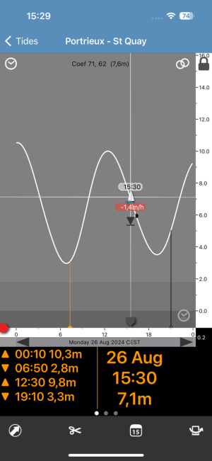

Hmmm. On my Imray tides app it shows Coefficient at the top. I guess because I have a French phone.
In Brittany the coefficient is also something of which the non-sailing public seem aware - as a useful guide to when will be good for “pêche à pied”, for promoting awareness against being stranded by the tide etc.
