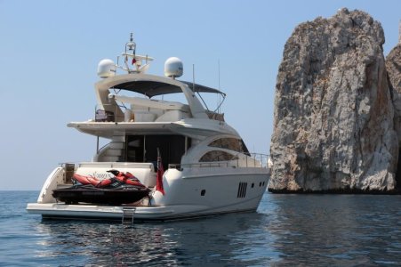

IMO, don't get too fixed on that hydraulic platform. Look at the Princess 67 - we have had ours since 2008 (bought new). A good sized bathing platform and space on the flybridge. That gives us the ability to have a Jetski AND a big tender - and boy, we have a big tender - a Novurania 430.

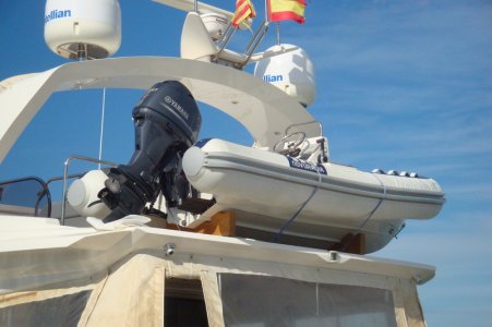

The crane on our Princess spans the bathing platform so it really isn't a problem lifting a Jetski - heavy but not an issue.
That said, we don't have the Jeski anymore - got it out of my system.
The tender is a much better alternative.
I've rigged ours so that the chocks can be positioned either on the Flybridge or the Bathing Platform.
When anchoring overnight, I like to be "rigged to go" in case the weather changes so the tender is always lifted on board and in those circumstances, it is usually on the bathing platform overnight.
Also, you need to be sure that your tender doesn't interfere with the passerelle if you are visiting a Med style berth. Our passerelle is a cassette type, hidden under the cockpit deck so I would need careful consideration to the size of my tender if I only had a hydraulic platform. In other words, I couldn't have such a large tender.
Lifting the tender onto the Flybridge is such a good place for storage during the off season months - safe from theft, less exposure to the water etc.
