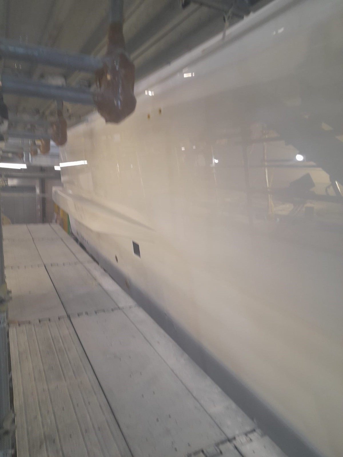

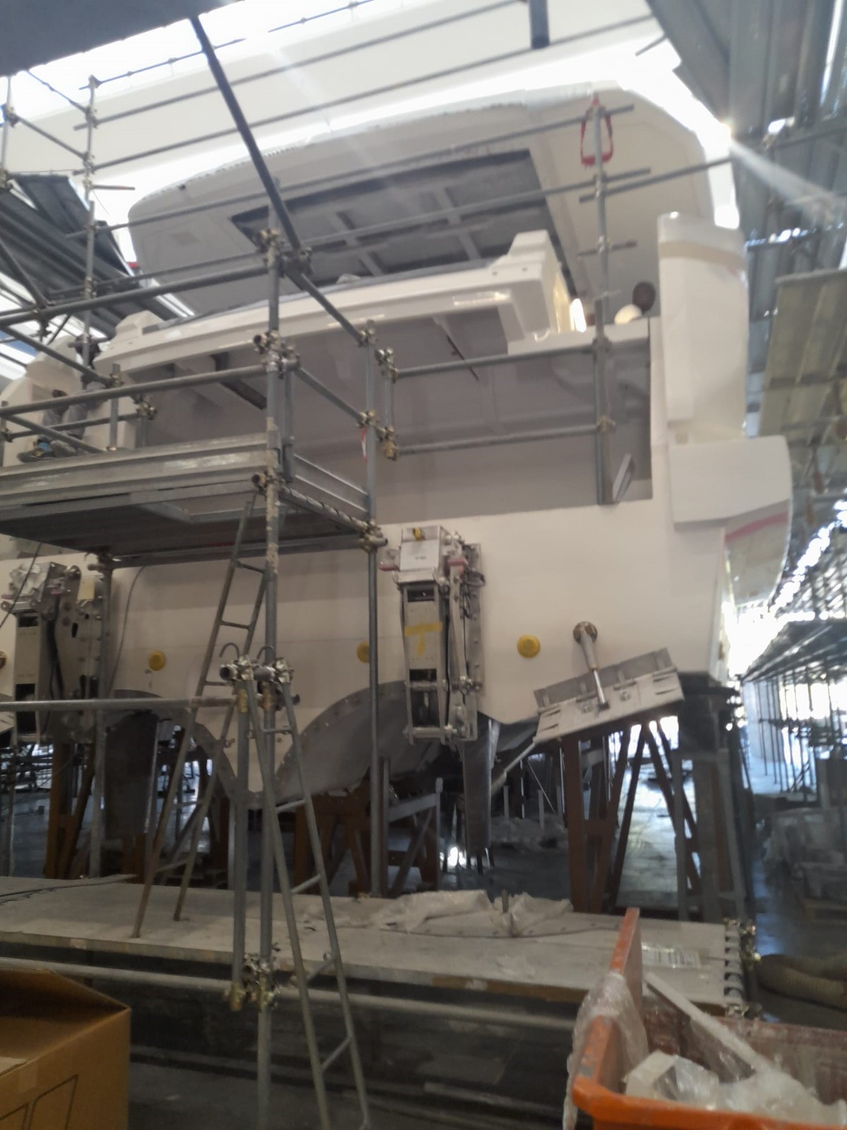

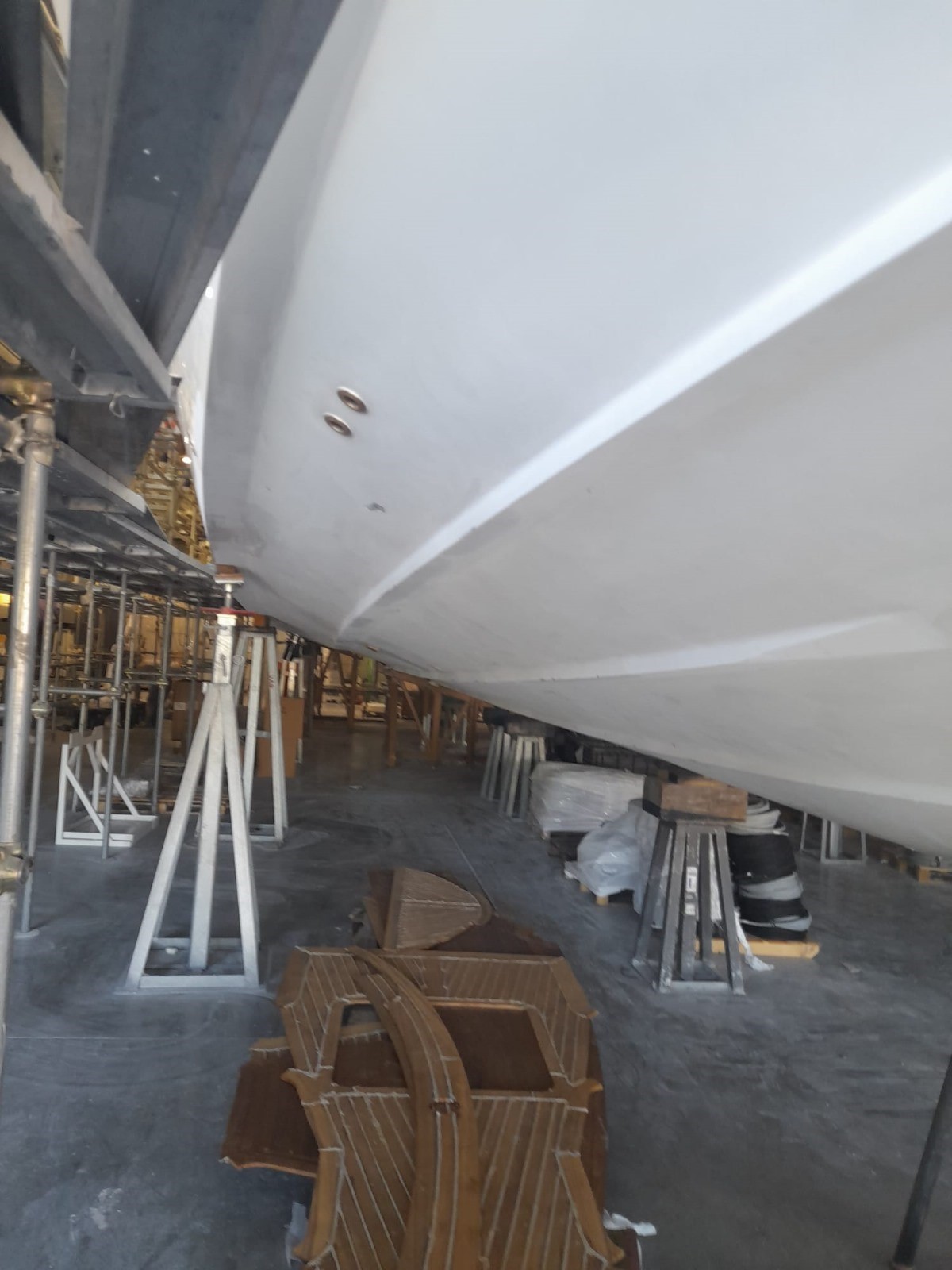

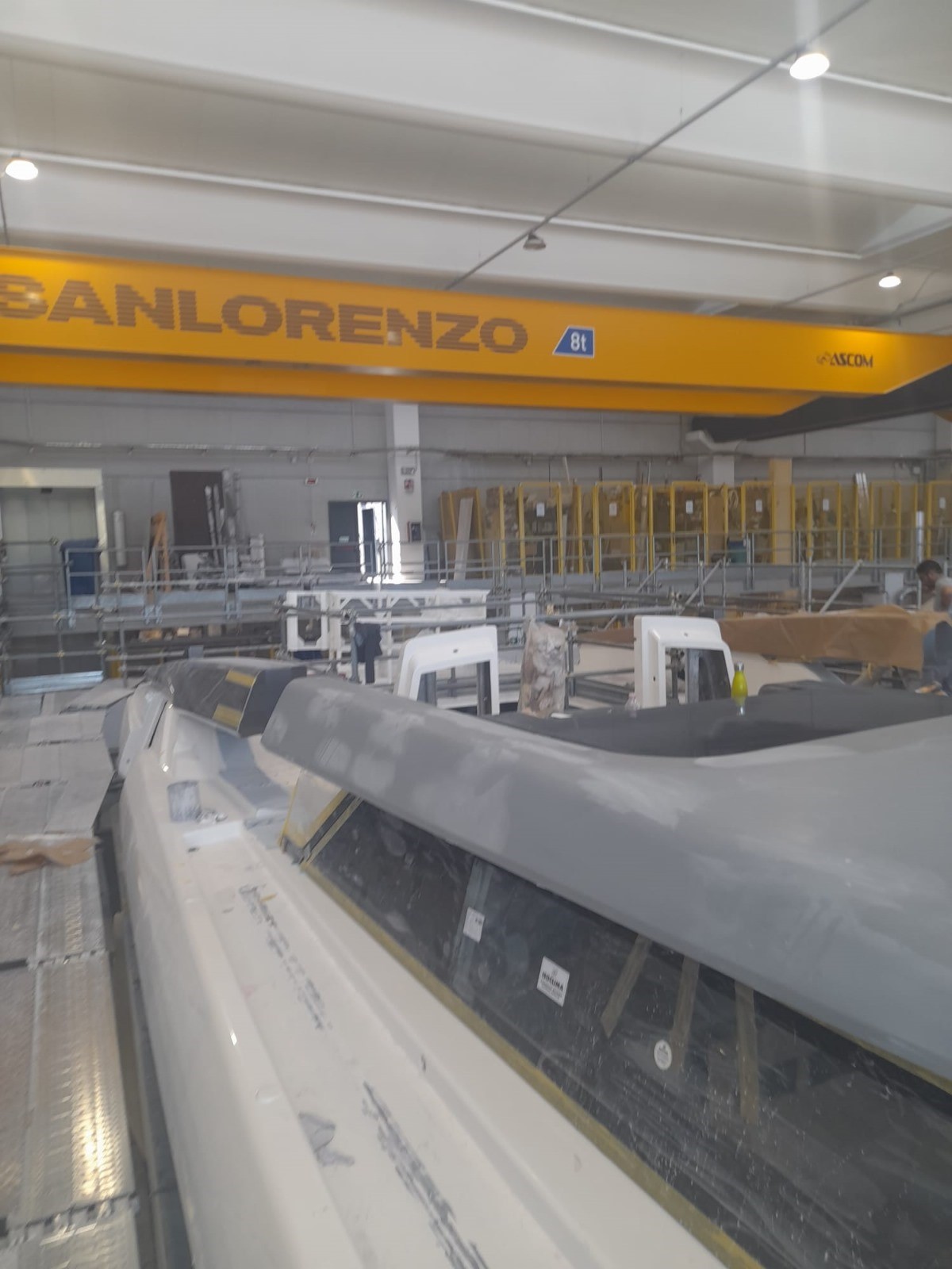

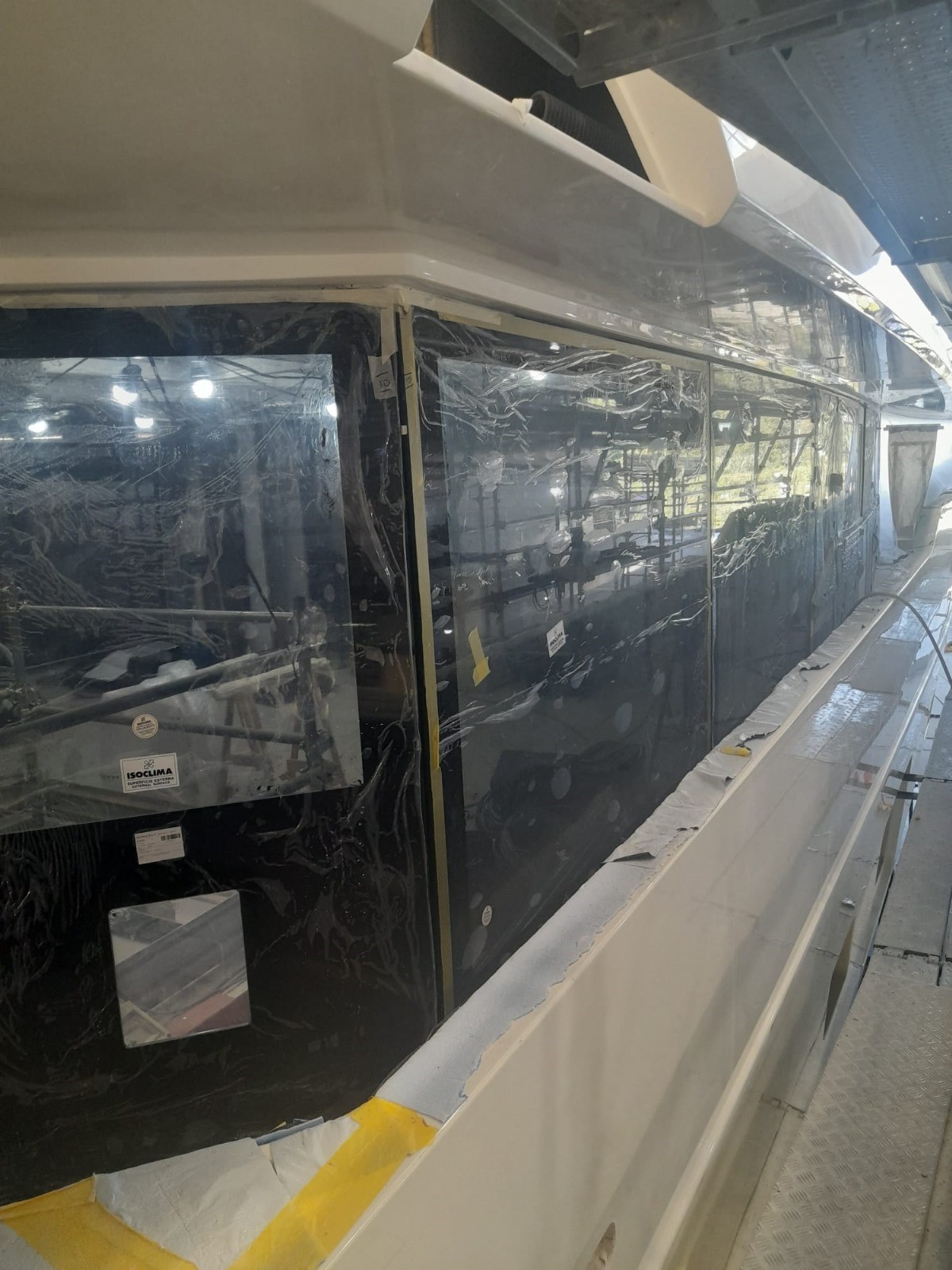

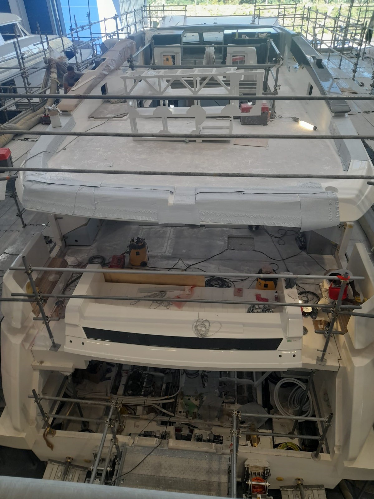

Here are a few more pics taken in the factory in Italy this morning. It's coming on!:
First some overall exterior shots. The lower aft cockpit deck and sofa are now installed. The big square holes in the deck - both flybridge and saloon - are the engine install/remove soft patches. The third pic below shows one of the upper deck side walkways, that take you from flybridge to sunbathing on starboard side, and from flybridge to foredeck on port side, without having to go via aft cockpit or or via the boat's interior.
The last pic above, of the starboard side deck, needs some scaling - that deck has loads of head clearance and two people can easily pass along the deck in opposite directions, though its not clear in that picture. Below is a picture I took of the same side deck on the SL96A at last year's Cannes show with two people in it - the guy is 6 foot and he isn't going to fall overboard standing there :)

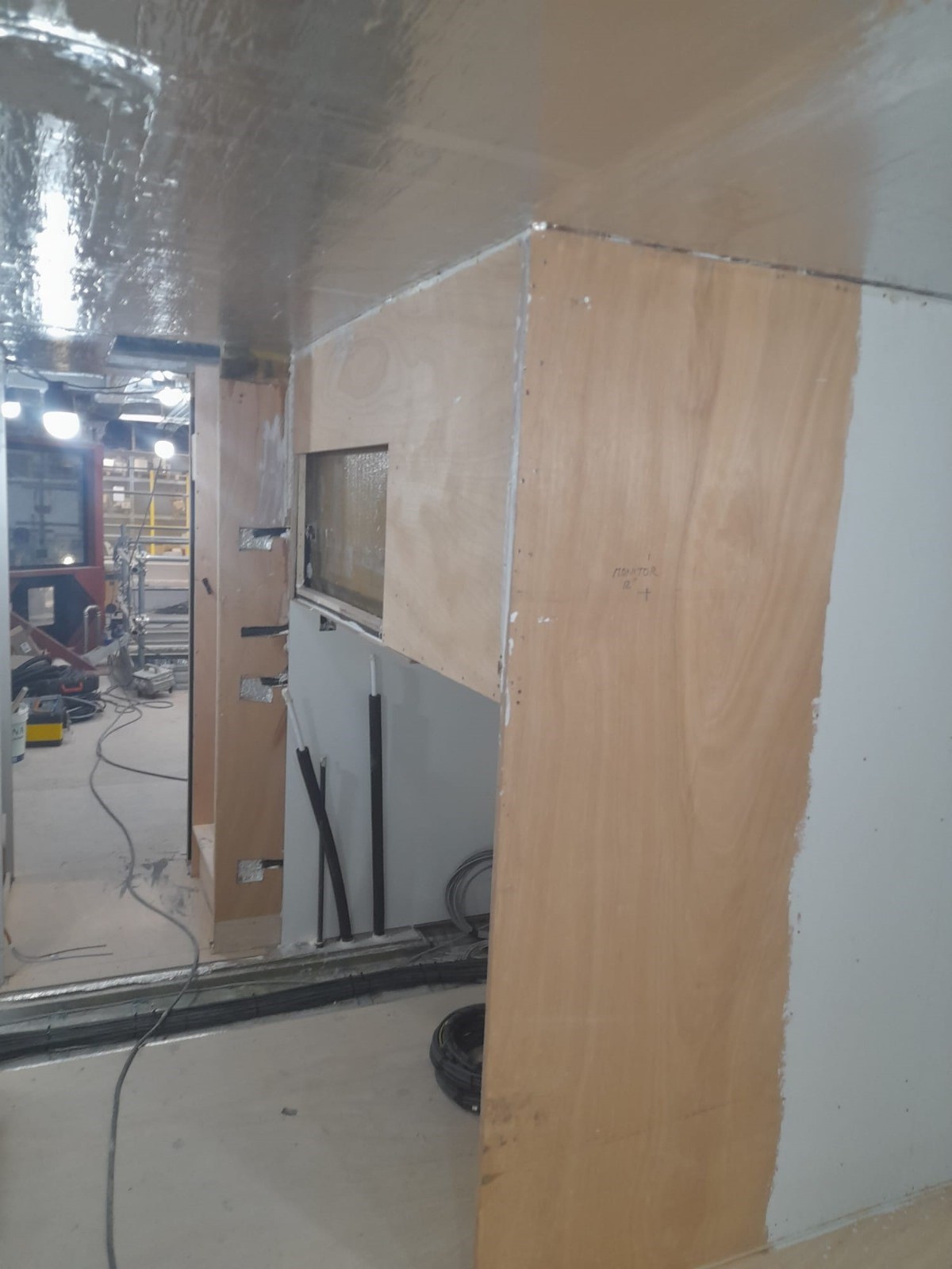

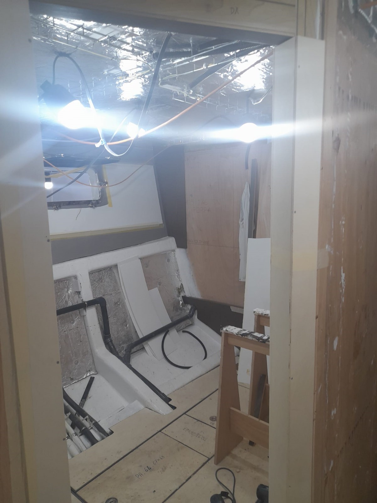

Finally some random interiors shots. As you'll see, there is foil-faced insulation everywhere, including internal partition walls and ceilings. First, below, is galley entrance lobby area, looking aft. The lower opening is where subszero fridge draws will go (close to the camera) and also a pair of doors (further away from camera) to storage under the mezzanine floor of the RPH (raised pilot house). The upper slot opening is a serving hatch twixt pilothouse and galley
continued...
Next main saloon...
Next below is port VIP followed by starboard VIP, then port guest cabin...

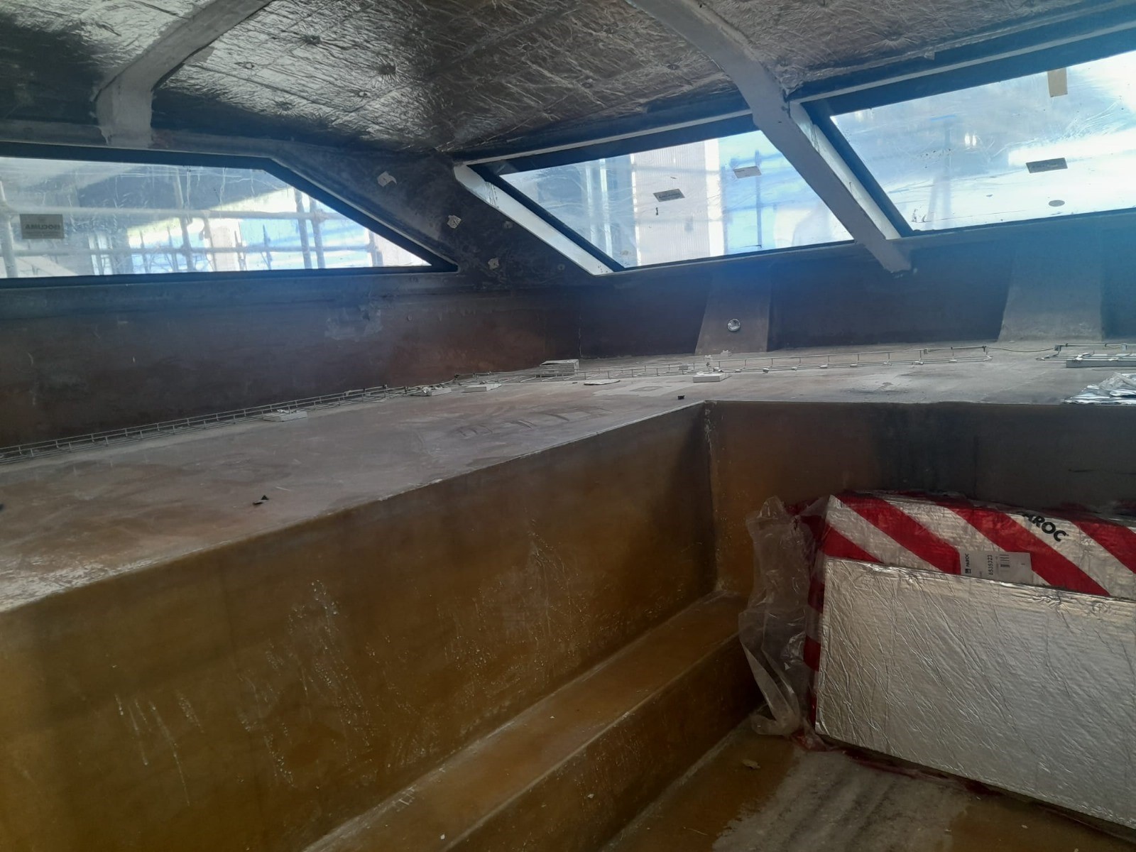

Below are two shots of the RPH

Following this build with interest. I can’t believe there is so much scaffolding and acro props not just surrounding your new toy but on it and in it.

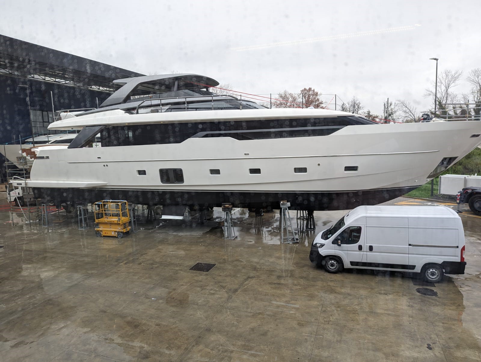

The thing is pretty high, in terms of reaching and also not falling. Pic below shows a finished SL96A at the factory, with a white van for reference, in a normal blocked position with props close to the tarmac. You can't even reach the waterline when standing on the tarmac.

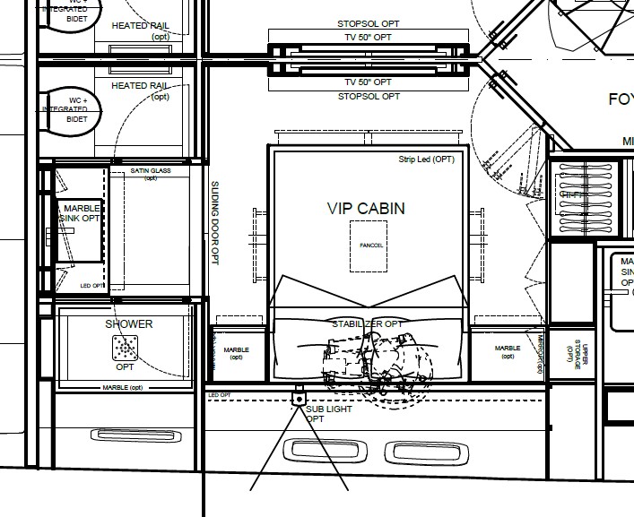

Is a fully w/tight hatch going to close the fin actuator box?
And if yes, transparent?
Yes - a flange will bonded to the top of the box, then there is a w/tight hatch with a zillion bolts. I asked for transparent but they don't want to. I might change it myself after delivery (if get round to it...). There is a 24v power supply in the spec so that if I do put a transparent lid on, I can have LED lights inside the box to allow easy/quick inspection.
Also what’s going to be above that hatch ? Presume something easy to gain access for maintenance?
Are those stabs quiet in operation?
Yes, a bed goes above it. See GA snip below. Access is therefore very easy - remove mattress and plywood panels, and you have access.
Noise is a thing here: the sleipner actuators are the closest to silent you can get but are not absolutely silent. There's no bearing noise = SKF spherical bearings with clamp devices that you clamp up to eliminate backlash. You're left with the oil flow noise, but the box in the picture will itself be lagged in sound deadening material to help with that.
There is no absolute-zero noise solution with fins on a boat this small, but this is as close as anyone will get and that will do/will have to do :)
Anyone needing total silence for overnight stabilisation while they're trying to sleep needs a gyro in the e/room. Even then, there is airco noise and slight generator hum (from 4.5litres diesel engine) in the cabin. I'm firm about wanting fins rather than gyros, at least based on the products you can buy today.
There's a picture you won't find in any sales brochure!
