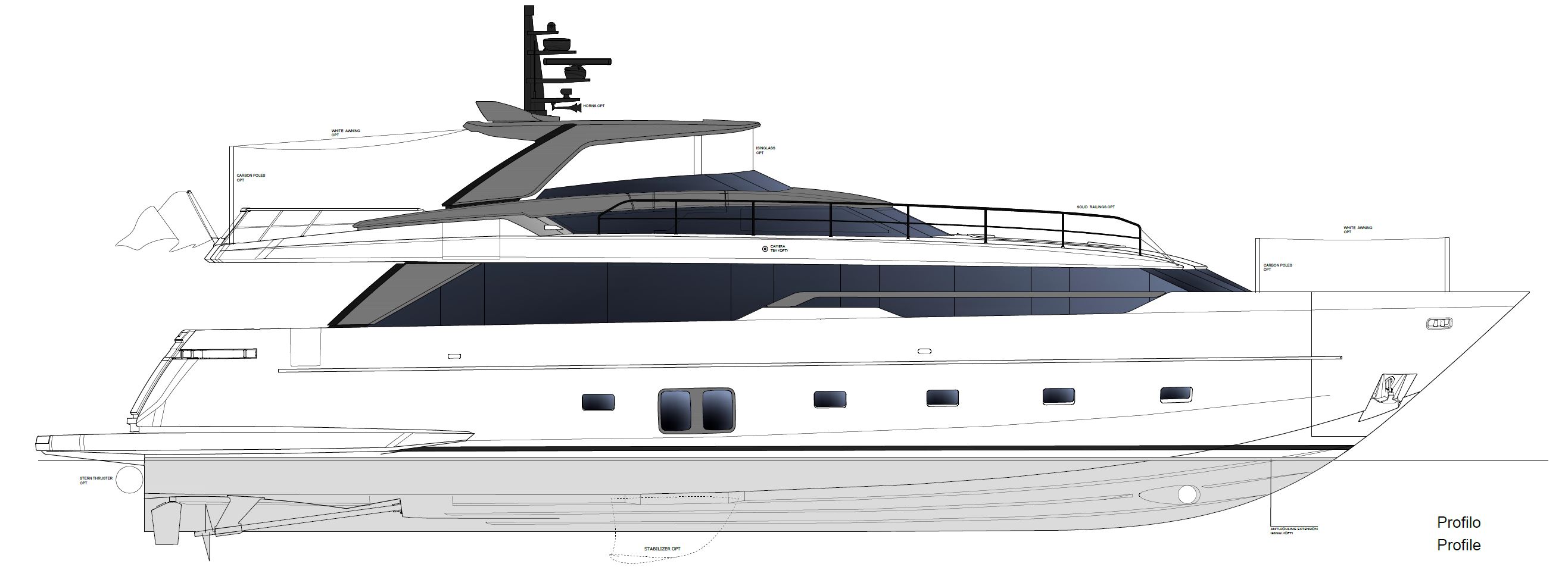

Here are some basic pictures (sistership brochure shots, obvs). The layout is slightly unusual – asymmetric. Side deck starboard side, widebody port side, but styled so it does not look widebody at first glance. Took me a while to digest, but having spent time on it I love it and think it will work really well. Also you can get from flybridge straight to foredeck without going down either fly staircase. And it has an internal staircase, via a beautiful raised pilothouse, which I need to write about later because the electronics/nav spec is interesting.

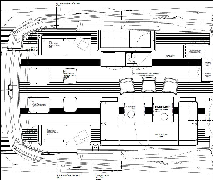

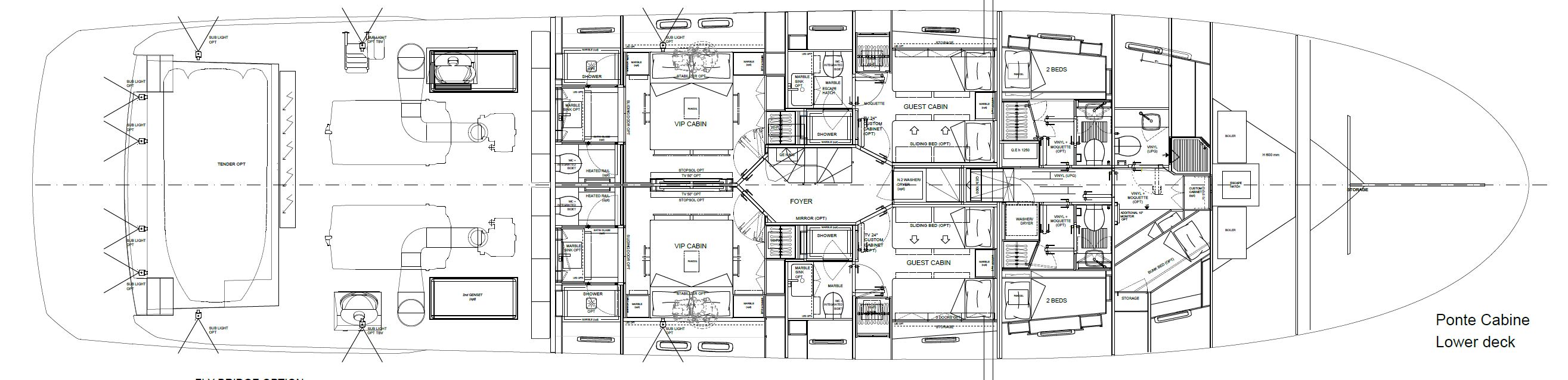

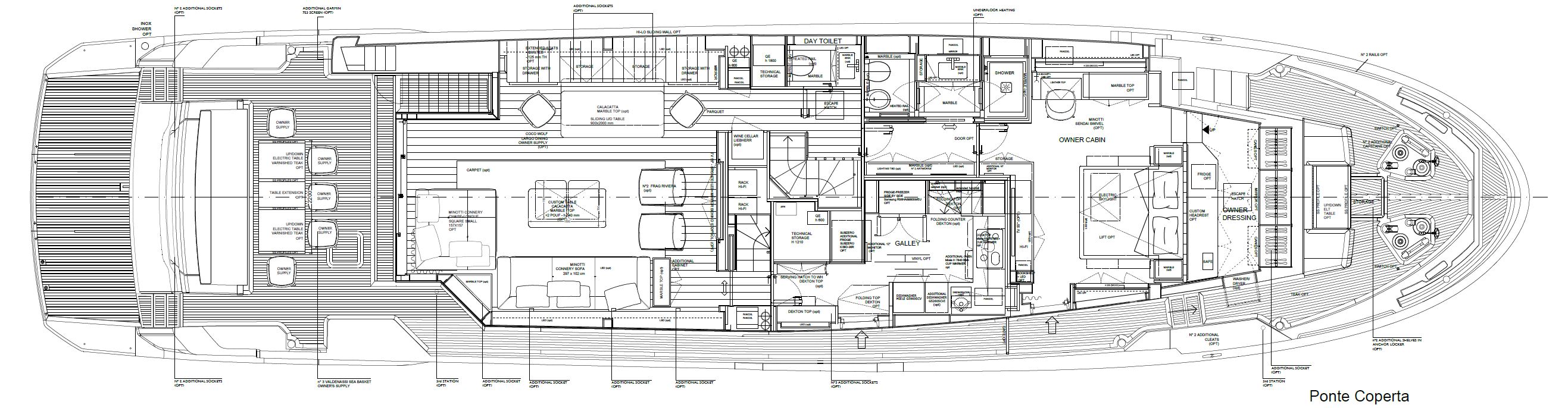

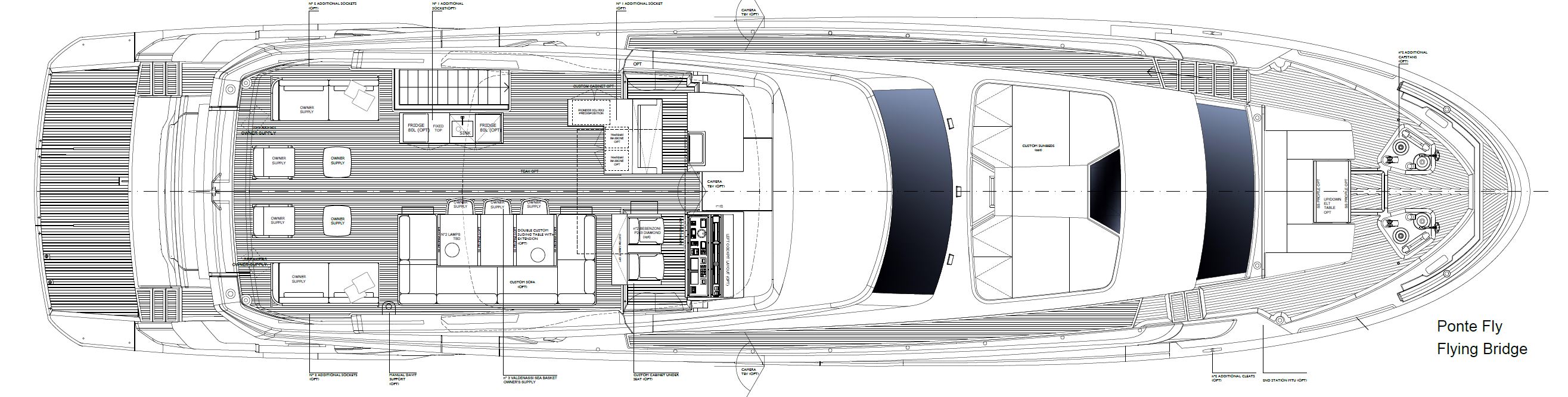

Next, here are GAs of my particular project.
It’s the standard 5 cabin layout but has some mods such as:
VIP cabin shower rooms made “part of cabins” with sliding doors and internal glass doors to WC and shower, so sliding doors can mostly be left open
3rd crew cabin and shower room right in the bow, instead of crew mess
Inner hallway to owner’s cabin
Custom dining table on fly with wrap around sofa
Plenty of salon furniture mods

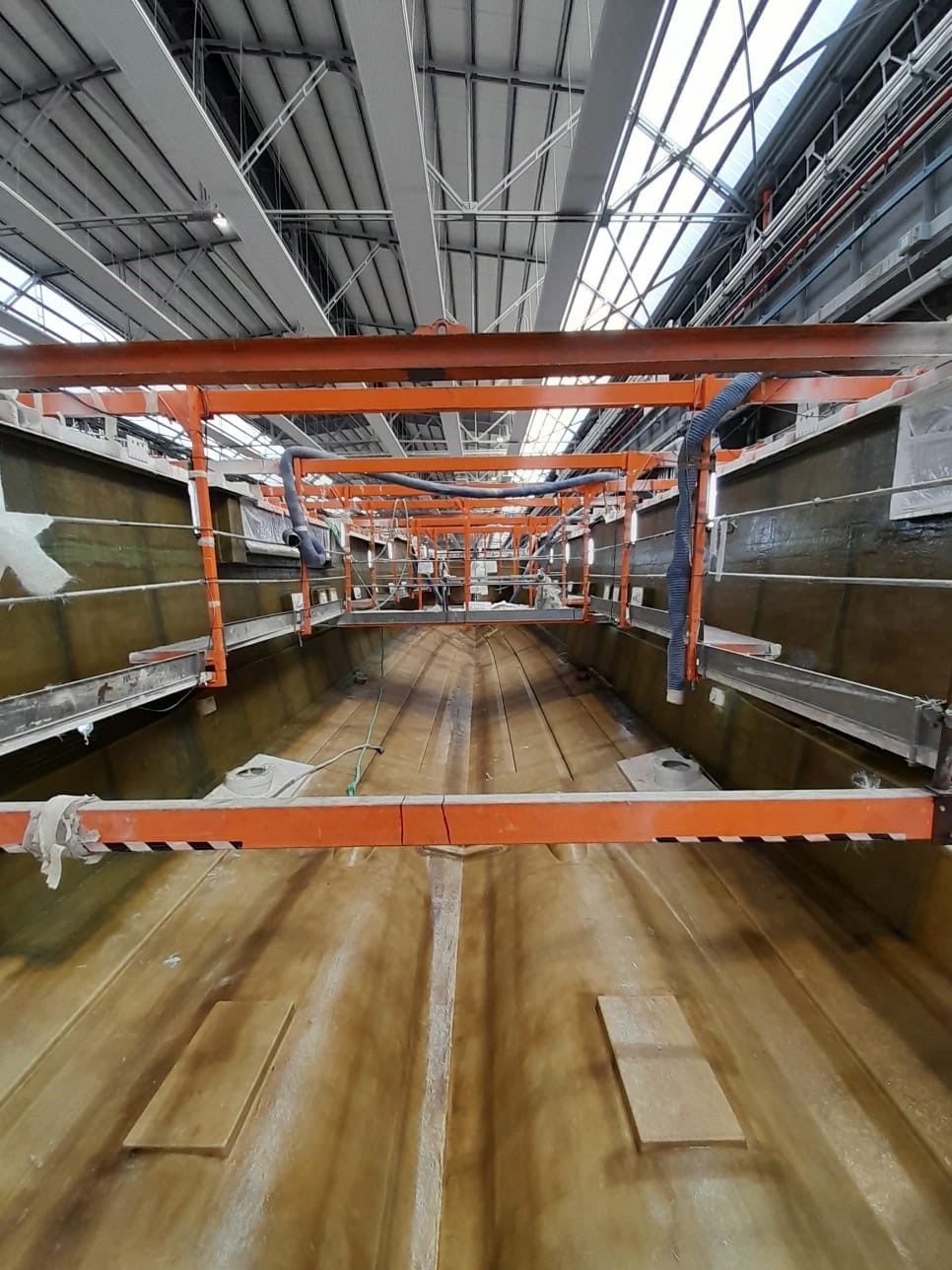

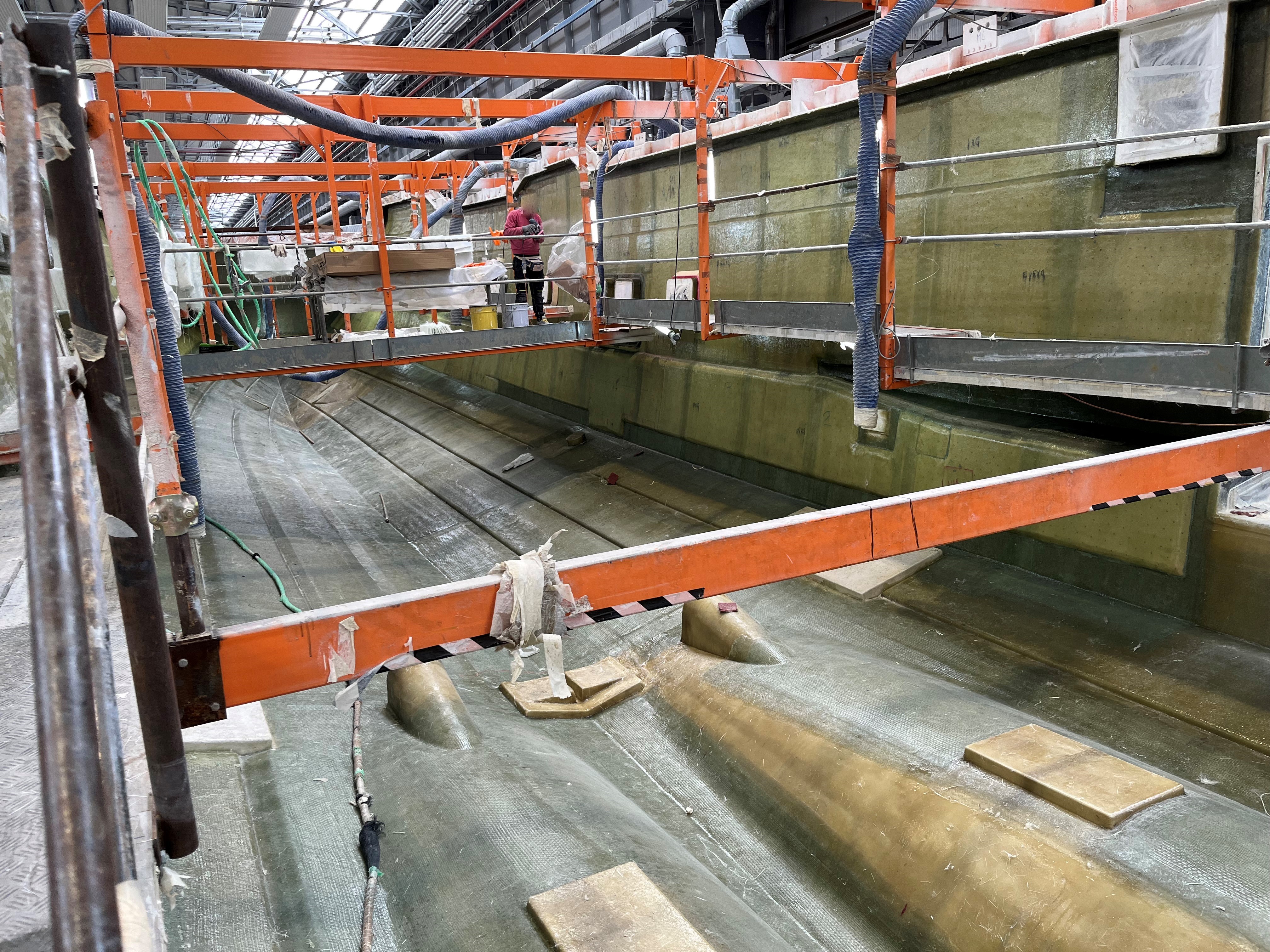

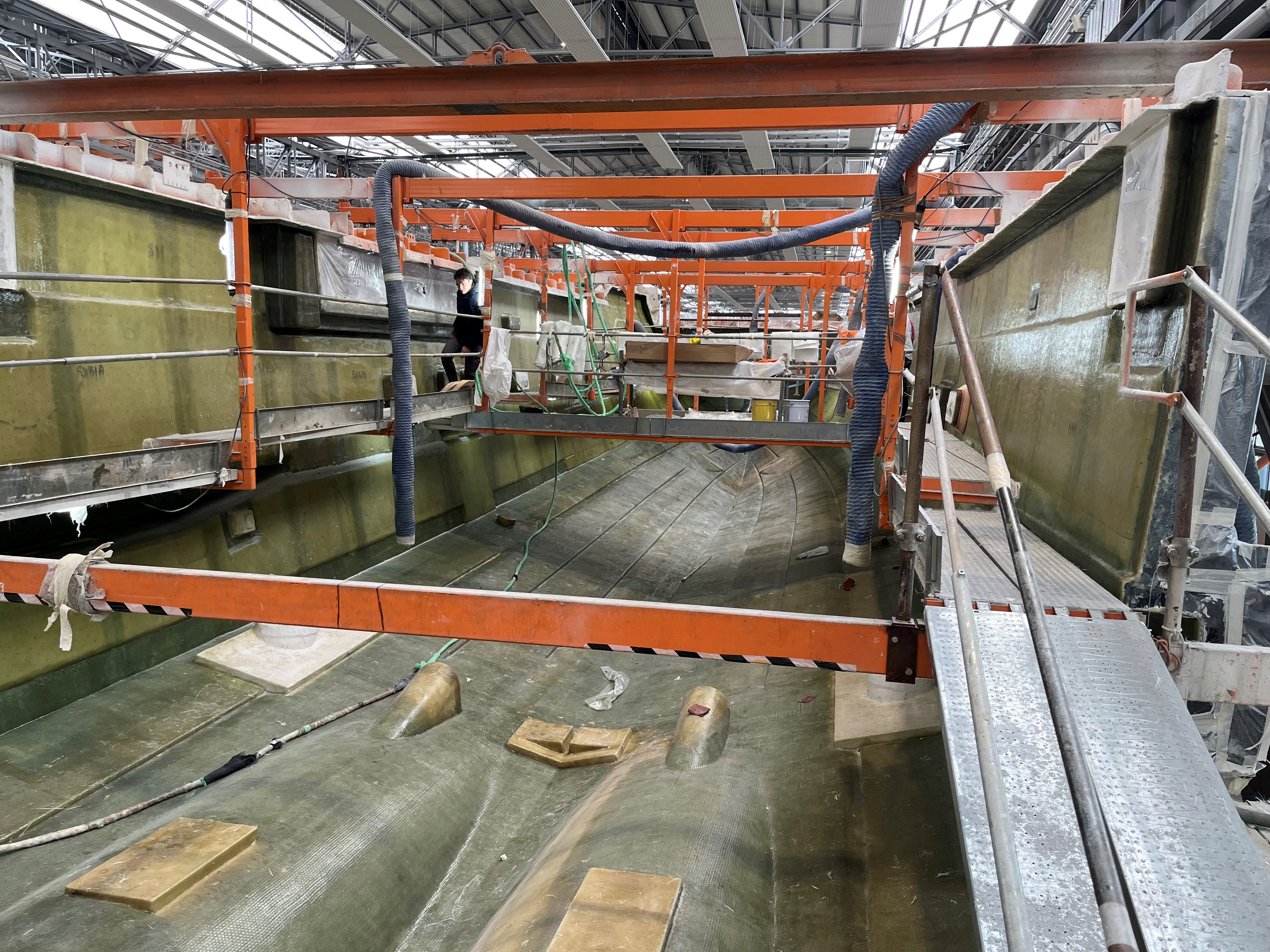

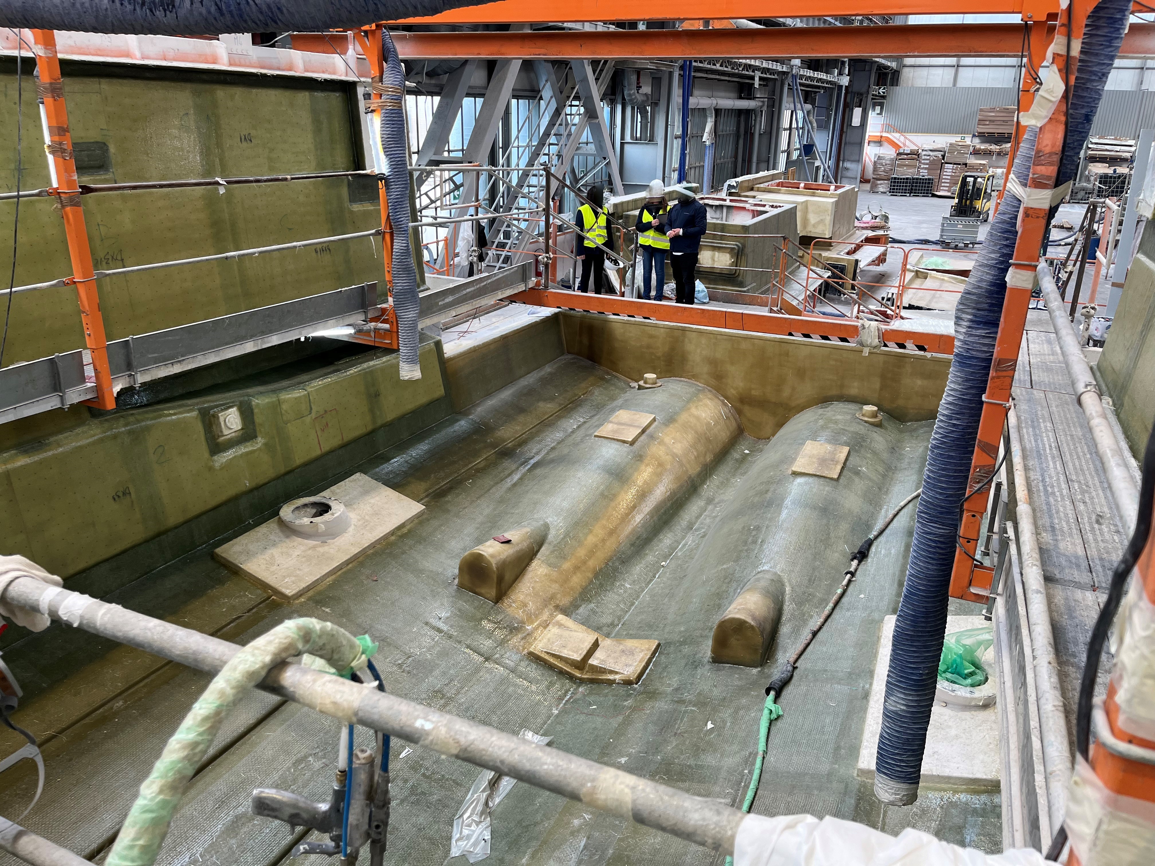

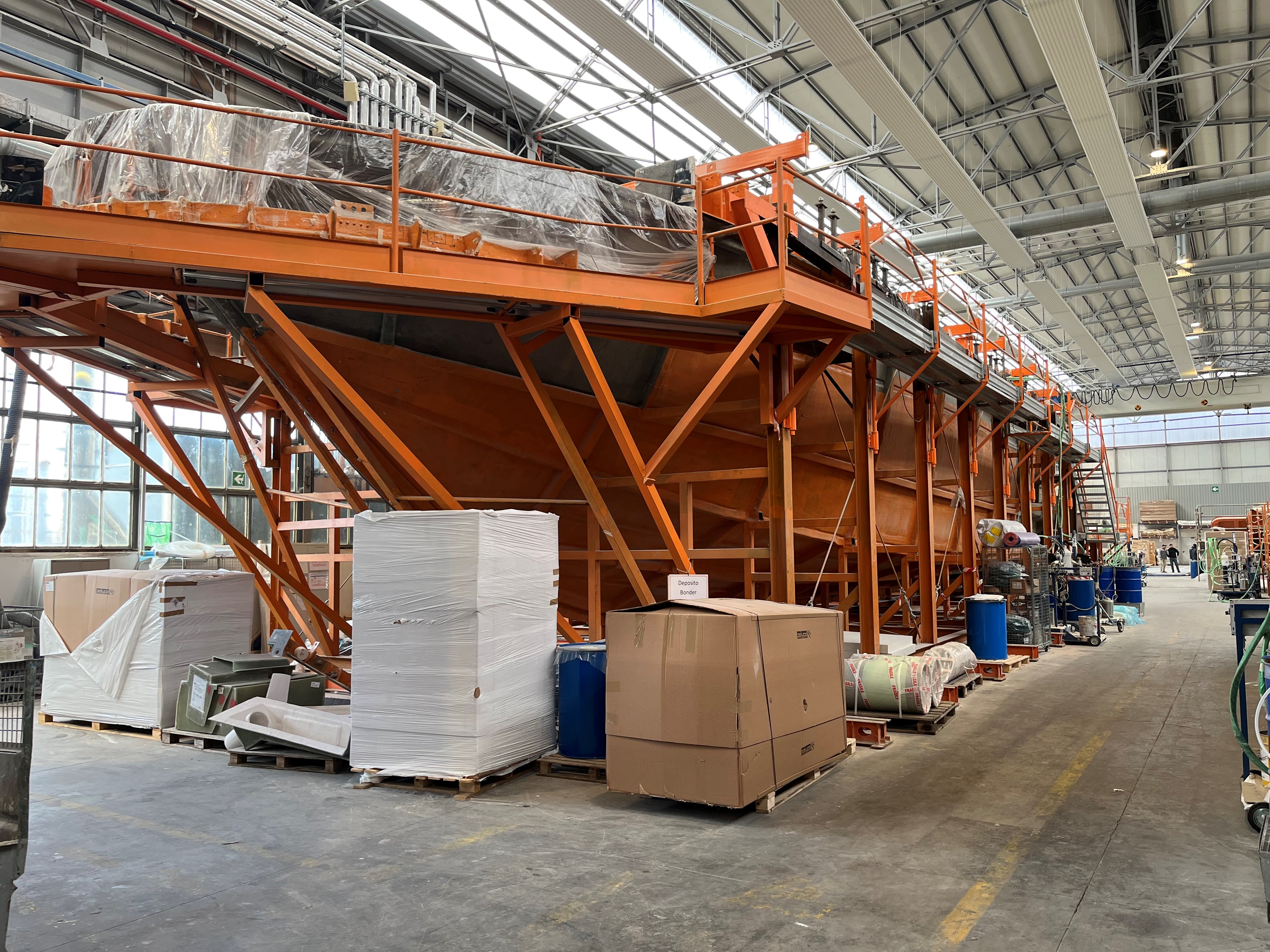

Next some pictures from the factory, all taken this month (March 2023). Hull in the mould obvs. It won’t come out of the mould till end April, partly because there is plenty more to do (stringers and frames) and partly because they like a long cure time. This mould is only making a few boats a year so the next boat isn’t rushing mine along.
