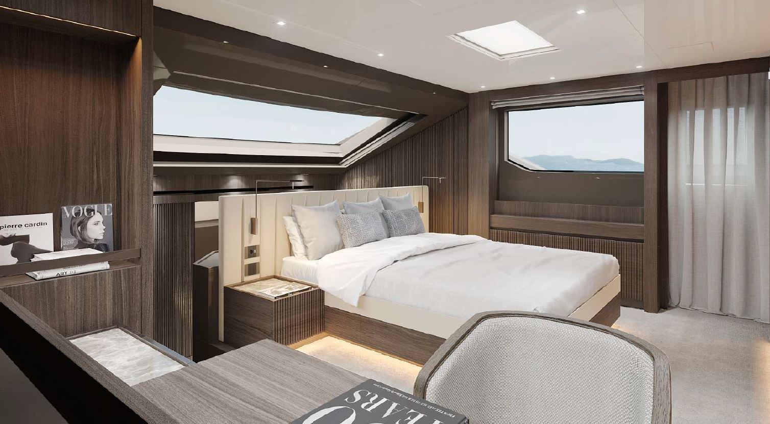

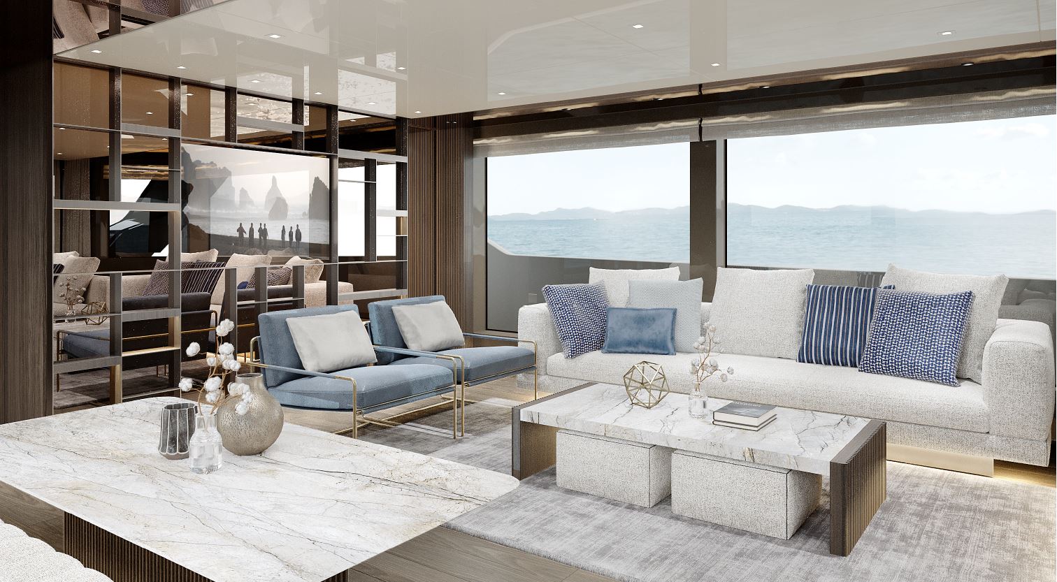

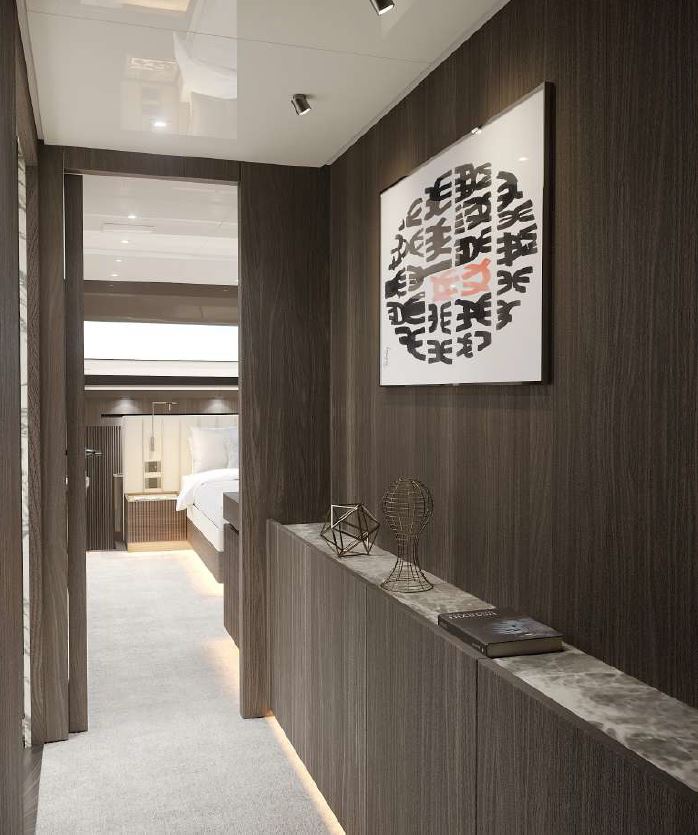

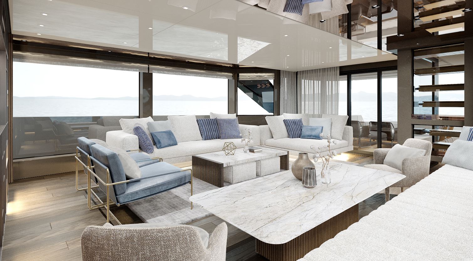

Finally some interior renders. This is all work in progress and there are plenty of changes in hand, but this gives a basic idea.

I noticed on some new boats that they have wood flooring around the outside and carpet in the middle but the carpet is set down in a recess so it is level with the wood. Are you going for this or are going for wooden floors wall to wall with rugs on top it?
worse - look! Bet it won't be that sloppy on the real thing.

I'm doing wooden floors wall to wall with rugs on top. I don't like the thing where carpet is set into a recess. No particular reason, but I just don't like it. Sanlorenzo would do it if I asked of course.
The wood floor is Cadorin, made in Italy, btw.

Haha - hope not! Those gaps must be in Cadorin's 3D model for their floor, I guess.
These interior renders are not final by the way - lots of details are being worked on. The saloon mood lighting has got a lot of attention and is going to be amazing at night - the pictures don't show that. There's also a decent AV system that I'll explain in a later post.

That’s in layman’s terms double click .It clicks on a long side ( all done correct) AND a short side ……not done correctly.There’s a knack , it’s to do with the angulation when you present the new piece to the layered floor .Get it wrong and ……..well you can see the gaps .
Don't ask me how I found this out :) .All fixable , you just have to be careful not to bust any tongue when you unclip it ….to redo it all .Lock down woes . :)

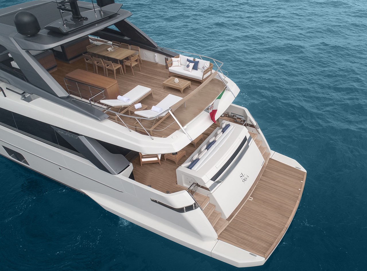

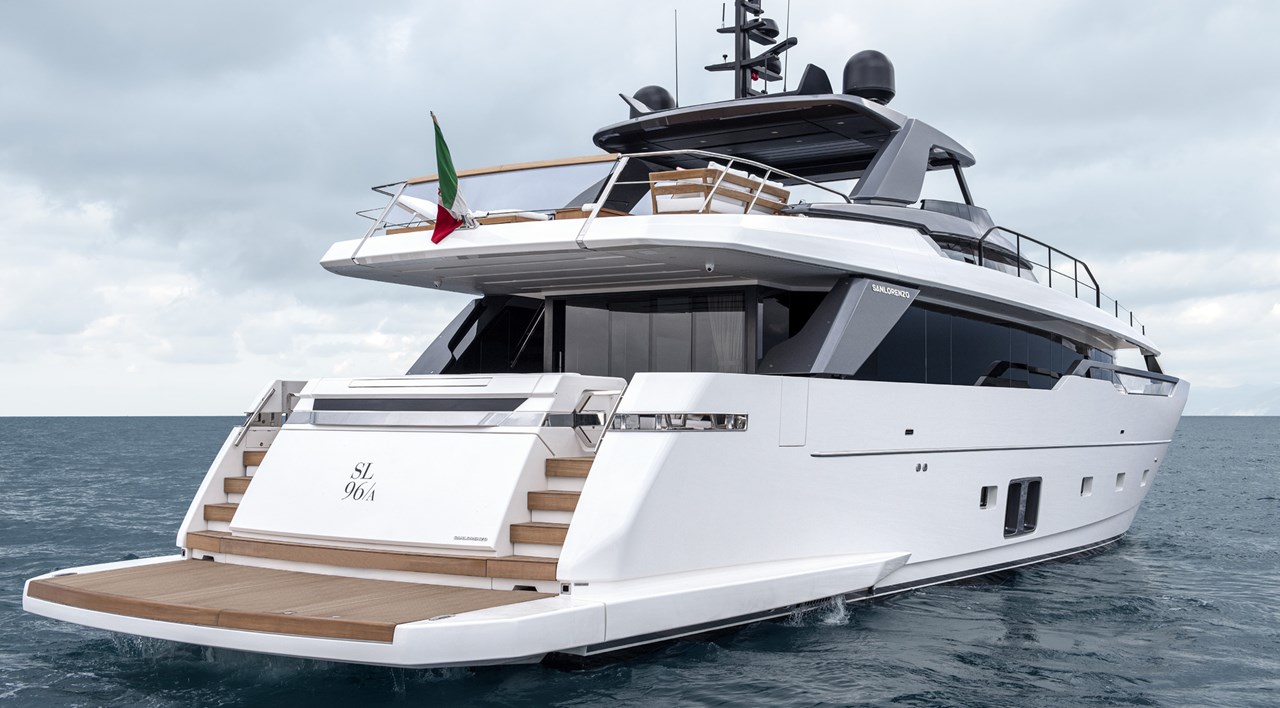

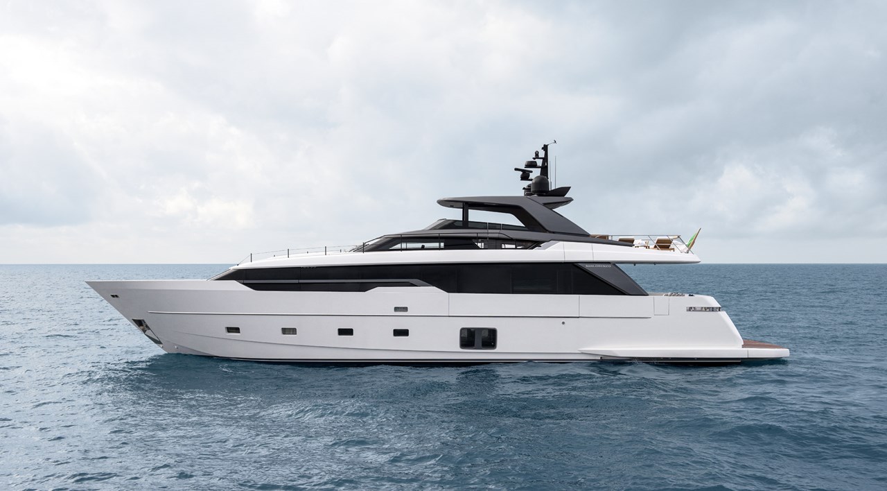

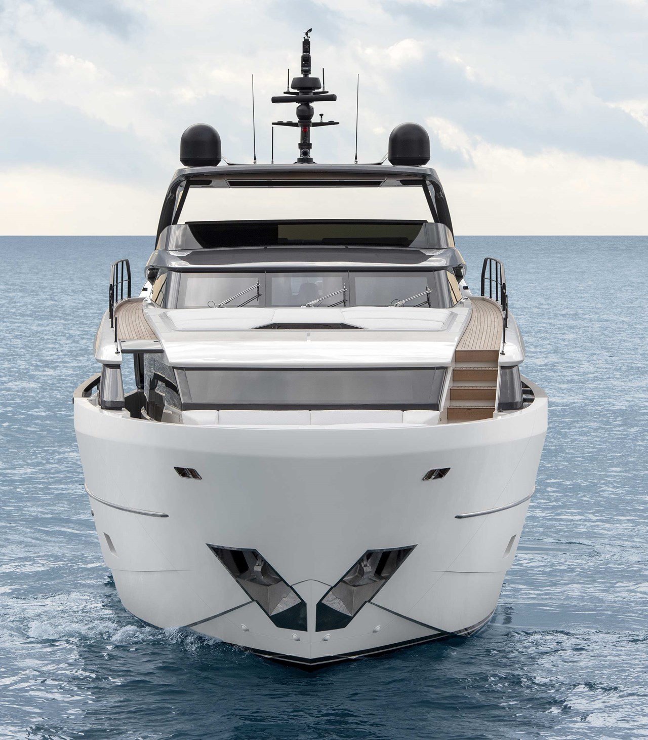

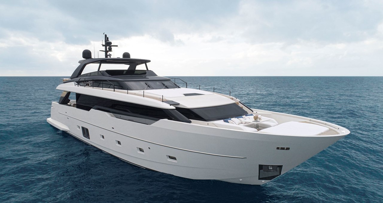

Evening all. I hope to document here highlights from this new project for anyone who likes to see under the skin of how boats like this are put together. This might go on for a while because as of today (March 2023) the hull is being moulded and the scheduled launch date is April 2024.
The basic boat spec is:
Sanlorenzo SL96A
Made in Ameglia, just south of La Spezia, in that prime yacht building territory of Tuscany Italy.
LOA 96 feet/29 metres
Displacement about 100 tonnes light, 110 heavy
Machinery: 2 x V16 MTU main engines, 2400hp each, and
2x 45kva Kohler Gensets with the John Deere 4045 4.5 litre diesel engines
Fuel 10,350 litres
Stabilisation = Sleipner 2nd generation curved vector fins, hydraulic, 1.65m sq fin size
Airco 145,000 btu/hr from triple Condaria chillers with inverter driven variable speed compressors
Cabins: 5 guest cabins, 3 crew cabins but one crew cabin can be borrowed for kids of guests, so it can function like a 6 cabin boat. All 8 cabins have ensuite shower rooms, and there's a day head too.
Here are some basic pictures (sistership brochure shots, obvs). The layout is slightly unusual – asymmetric. Side deck starboard side, widebody port side, but styled so it does not look widebody at first glance. Took me a while to digest, but having spent time on it I love it and think it will work really well. Also you can get from flybridge straight to foredeck without going down either fly staircase. And it has an internal staircase, via a beautiful raised pilothouse, which I need to write about later because the electronics/nav spec is interesting.

That’s not correct. This is cadorin, the best you can get, with absolutely no clicking.
That picture is just a 3D render, not a real floor. The gaps are fault of a code writer not a floor fitter.

I should have said “ appears to be “You get the same gaps as I said . The small side clicks with a gap but not quite flush as it can be deceiving the fitter to thinking it’s correct .It also clicks if know how with zero gap .It’s like it’s got two positions .
I don’t understand your “ fault code reader “ meaning .Let’s leave this tiny side show here .
I was offering up a plausible explanation from experience that’s all .
Mine was a lockdown spare room DIY effort .Got it right in the end .

You seem not to be getting that it’s a 3D render, not a real floor. Like a CGI movie. Your experience of real floors is therefore irrelevant. The gaps are the fault of a code writer- whoever put together the 3D code, not the fault of any actual floor fitter who fits real floors. There won’t be any such gaps in the actual boat they’re going to build.
