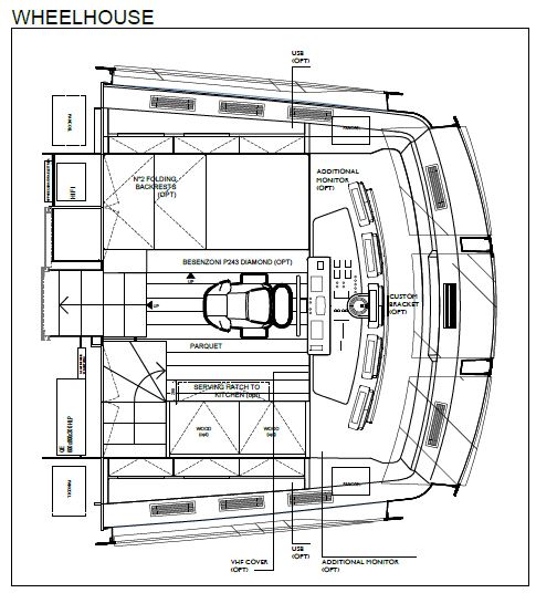

Here's a bit of information on dashboards and nav gear, with some pictures.
total of 11 big touchscreens (not counting the tender or chaseboat :) )
a couple of smaller 7 inch touchscreens
everything digitally switched using Empirbus
2 radars
A very high spec Flir camera
Autopilot control with touch screen and joysticks in armrests
Kahlenberg horns
Electric fly by wire steering (that I'll make a separate post about sometime)
Sanlorenzo offer "bronze/silver/gold/diamond" standardised hardware levels but my spec will be beyond that mainly because of the unique set up in the pilothouse. They are happy to install Raymarine, Garmin or anything else sensible. I'm a big fan of Garmin - the functionality is outstanding in my view, and their support is great generally and particularly from the folks I have got to know at Garmin UK. Also the CEO of Garmin marine in Kansas is a good friend and has been a guest with his wife on my last boat, and is boat-crazy himself, and he is taking a strong interest in this project. He discussed it with Sanlorenzo on his last trip to their factory a month ago, so I've got the best support and (Garmin) guidance anyone could get on this.

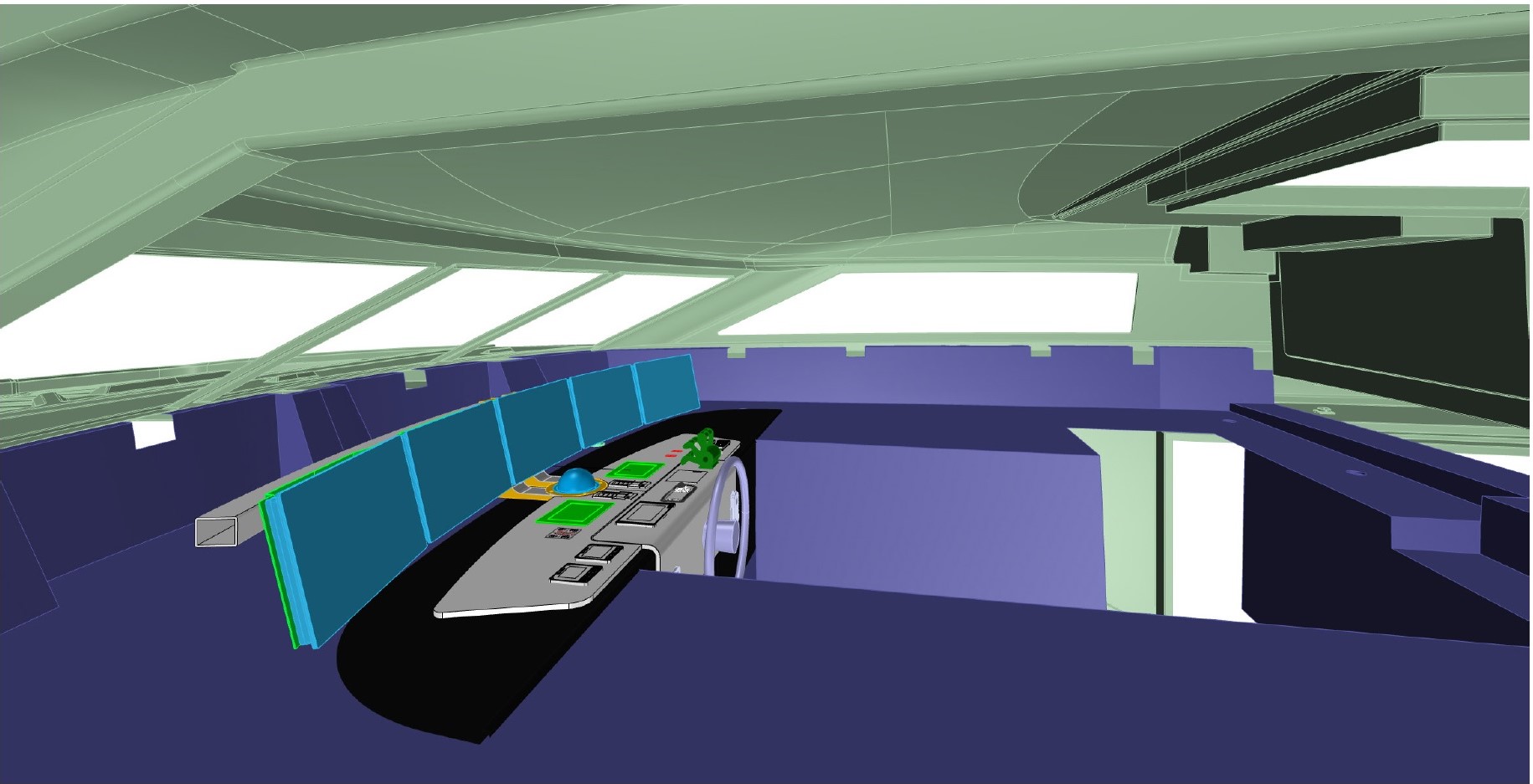

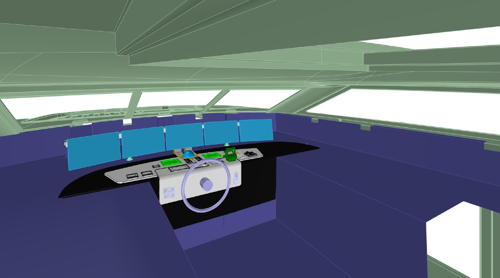

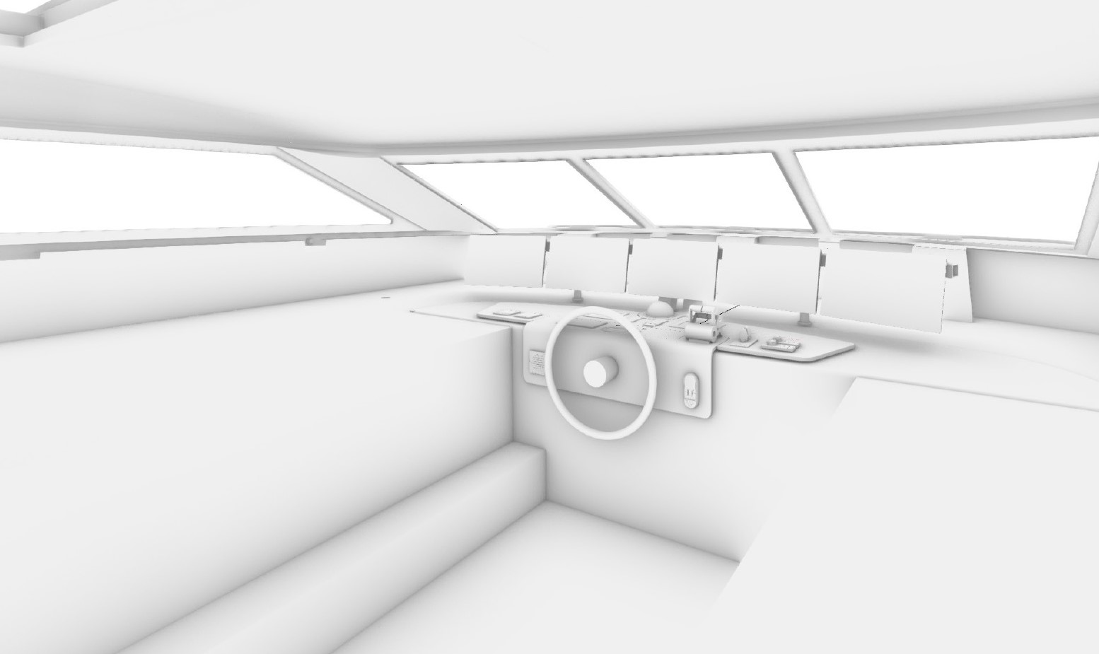

The best part is going to be a curved array of 5 x 22inch Garmin 8422 screens in the pilot house. This is totally custom and they have not done this before. One 22inch screen is a big thing and splits in to up to 6 windows, so 5 an array should look pretty badass.
Pictures:
Picture below is what Sanlorenzo fit in the wheelhouse if you get "Diamond" spec = 4 Raymarine 16inch Axiom XL screens (or Garmins) Quite nice.
I wanted to get more screen area and really didn't like the centre of their normal array, where you can see those chunky metal legs, so these next 3 pictures below show renders of what they have agreed to install for me in the wheelhouse. Five Garmin 22 inchers :) I'm really looking forward to playing with this.

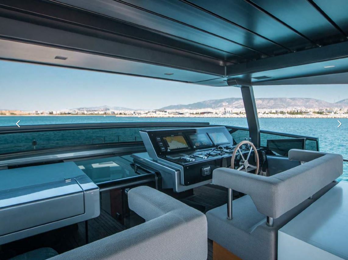

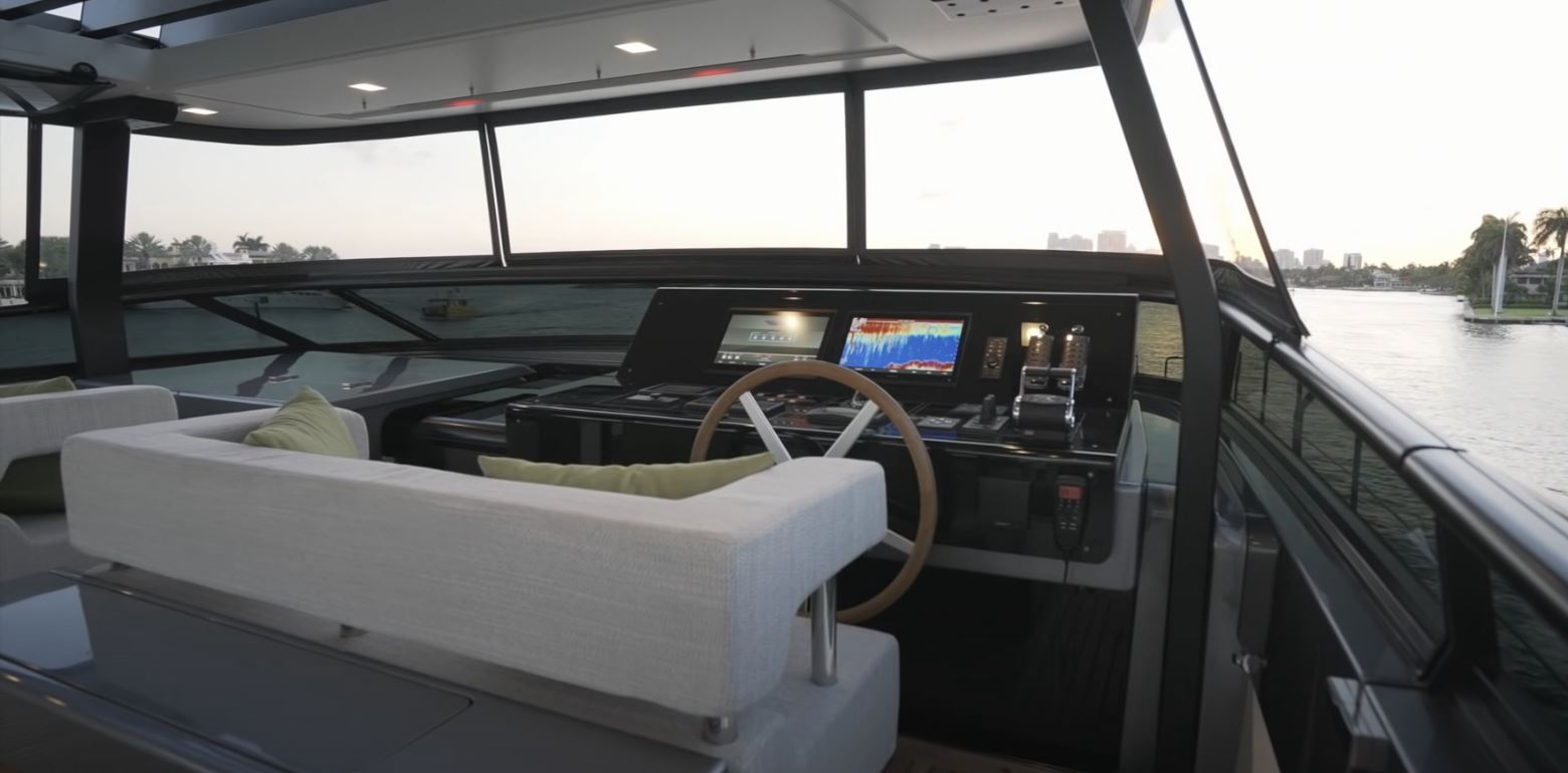

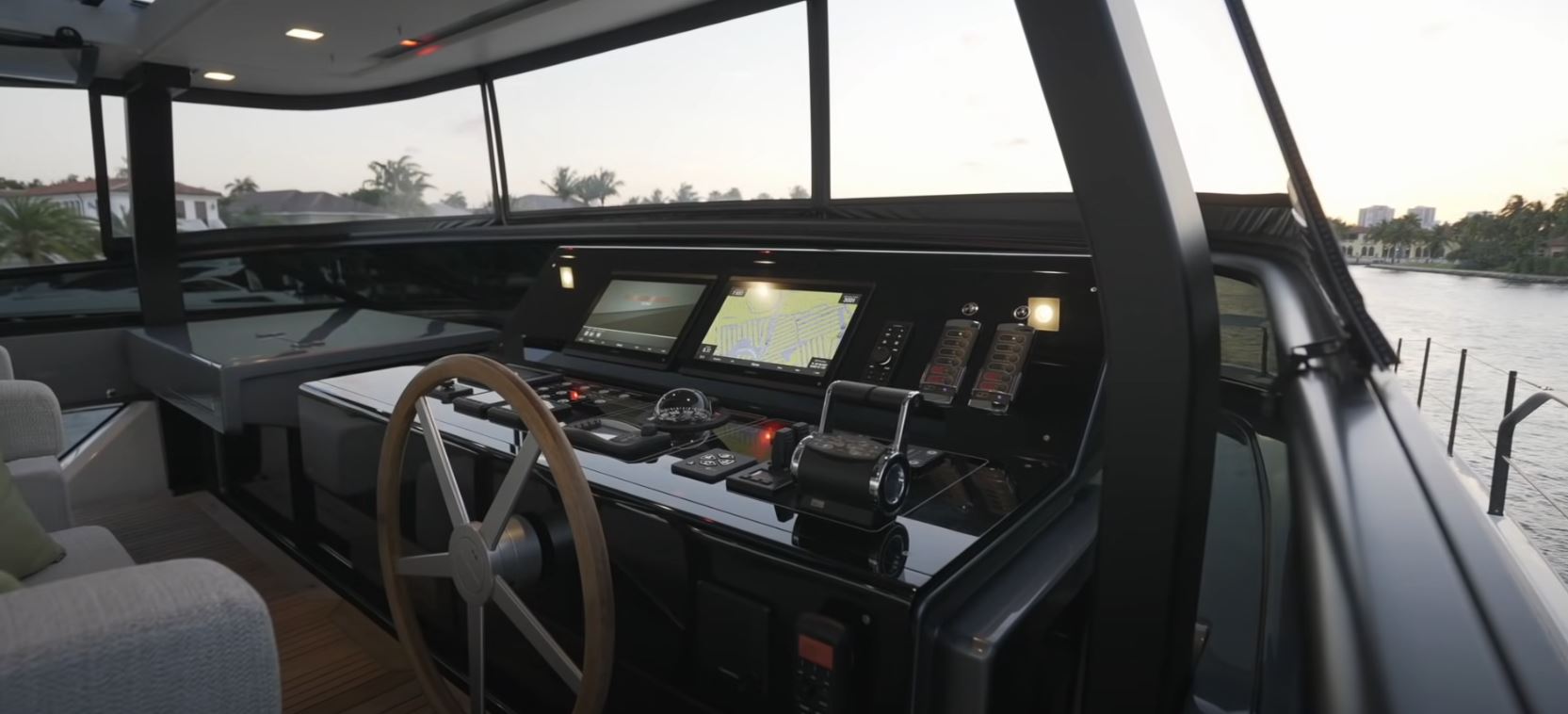

Next, the flybridge helm. First, below are 3 pictures of the standard fly helm. First one is "Diamond" with 3 screens, and next two are I think "Gold" or "Silver" with 2 screens

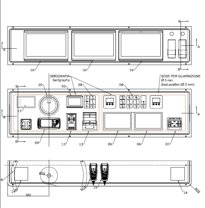

I don't have a proper render yet but my spec is to left-right invert the whole fly dashboard so the steering wheel is on the left, because I just prefer that. Plenty may disagree that - it's just a personal preference. There will be 3x Garmin 16 inch screens, properly flush mounted glass bridge style. Also I don't love the helm bench in the pictures above so will instead have 2 x Besenzoni seats diamond stitched with electric hi-lo and joystick in the armrest. I only have the line drawing and GA below:

Ok. One last try at this. With all the tech and controls in the armrest. Dump the steering wheel!
:) There's something comforting about a wheel, especially when letting others have a go, or when stand-up helming in pitchy seas. I will mainly joystick it but keep the wheels.
The steering is electric and the hub is a rotary encoder not a hydraulic pump. Using the centre screen just ahead of the wheel I can choose turns lock-to-lock and steering wheel resistance. I expect to select minimum turns LTL, so I won't have to spin the wheel for ages if using the wheel in close quarters manoeuvring.
I could easily add a third rotary encoder with a sort of "volume knob" on it, atop the dashboard or in the armrest, and steer by that when totally "manual steering".

PS: ref. the dashboards, WOW is the only thing that pops to mind.
Are you going to christen the boat as USS Enterprise? 😜
You're thinking to maneuver the boat from the cockpit while mooring stern-to, I suppose?
Because if and when you'd like to do that from the f/b, you might regret not having good visibility at least on one side, no matter how many cameras you've got. Other than that, I also prefer centered helm stations.

Have you considered making the the screen arrangement appear seamless? Rather than 5 separate screens……it looks like one continuous screen (but is 5 separate screens obviously) I think I’ve seen that on a few aquaholic videos and it looked trick! Pretty sure it was just 3 screens though….not a JFM mega setup 😂
benjenbav
12 Aug 2004
15,352
I was thinking how annoying it would be to gaze at a speck or two of dust in the seams. I’m sure jfm is waaaay ahead and has this covered tho’
