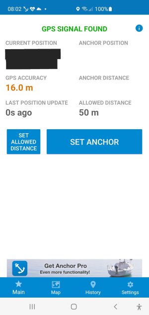

Just got it going now, but is it really using gps or just mobile data
Yes, it uses GPS, see home page. It would be very difficult to get an accurate mobile fix on the sea (worse triangulation between base stations).
Anchor Lite works without any mobile signal in my experience anchoring in bays in the Whitsundays.
I also use "set advanced distance" which allows you to set the actual anchor position as a bearing/distance after you've laid your scope so the alarm boundary is centred around the anchor, not the boat.
This means you get more sensitivity as it won't alarm as you swing normally around the anchor.
