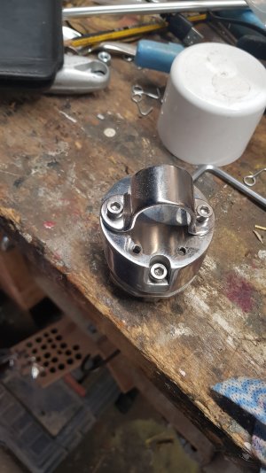

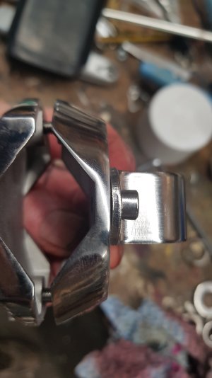

These tube clamps came with a liferaft cradle. Looks like the tapped holes are in the wrong side. It's impossible to reach the cap head screw once the cross tube is in place also the saddle clamps only have 2 threads engaged. Not very secure for a liferaft. Am I missing something 20250225_163640.jpg20250225_163615.jpg
Surely you clamp the lower bit to whatever first, torque up the cap screws, then add the tube section of another assembly, below the saddle clamp and tighten that.
The lower bit is designed to fit a range of tube sizes e.g. a stanchion, push pit, or whatever it being clamped to.
Easy enough for one. The liferaft cradle has 4. You need to line them up within a mm to fit 8 screws to 4 saddles the position of the saddles are determined by the frame. Pretty tricky whilst hanging off the stern. No way to tighten anything if it comes loose in service without removing the liferaft and dismantling the whole thing. Don't understand why it's designed that way. It would have been OK and cheaper to manufacture if all the tapped holes had been in the same half of the clamp. Suspect it wasn't designed for that application.
Presumably it will not come loose if you use red Loctite.
I also assume it was not designed to be assembled 'hanging off the transom' but was designed to be installed, possibly on the hard, with he who is installing using a step ladder.

"Presumably it will not come loose if you use red Loctite". Not sure I'd want to trust my liferaft to 2 threads engagement even with loctite.
Longer cap screws?
Or better still longer cap screws plus nuts - always assuming there is space?
Could you remove the threads, put longer cap heads in from the easier side and jam nuts where the cap heads are in your photo?
