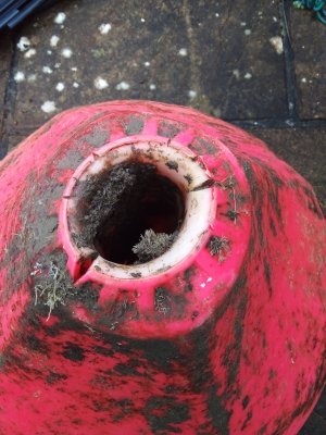

My mooring buoy is CC4 with a double through rod and large top ring. I sail a 36ft yacht single handed and don't use a pick up line so if I can secure to the buoy without mishap I expect a visitor to do likewise or find a buoy more suitable for their circumstances.
When a lasso is left on for any length of time in windy or fast tide conditions the whole weight of the boat is taken on the soft plastic at the bottom of the buoy which is then pulled up the rods and causes the plastic to split. The first sign this has happened is when the buoy sits lower in the water and or is only visible at slack water. I have had to replace the buoy 3 times in as many years at £120+ a go. The culprits are most likely because of heavy yachts (motor usually) lassoing the buoy when they come out of the local marina for lunch on a breezy afternoon.

Do you have experience of people doing this? I would have thought that it's very rare.
OK, lasso to arrest the buoy but the next step is to put a line (in my case, a rope and 6mm SS chain bridle) through the top ring and remove the lasso.
Oh yes!
On one occasion, on someone else's mooring, it took 20 minutes of "discussion" to get a Yachtmaster Instructor to rig a bridle and remove the lasso. His first response was to stay below, second to rig a small line through the top ring "to back up the lasso" and finally after much badgering he eventually rigged a more appropriate bridle and removed the lasso. His organisation has 6+ training yachts and he is the senior instructor so how many trainees per year have gained qualifications believing it's OK to swing around a mooring just on a lasso?
I could name many local boats that use the technique for convenience, particularly in breezy conditions, and the attached photo shows the result.20231227_103431.jpg
