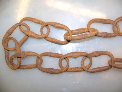

This is why you don't want to use an unknown mooring when the wind gets up
And, believe me, I've seen worse.
OTOH, in calm weather, I reckon it's fine as long as you're ready and able to move at a moment's notice if the owner comes back.
If you can lift the buoy a bit to see the swivel and the top few links of the chain, that'll give you an idea of the state of the rest of it, as that's the bit that tends to wear quickest.
