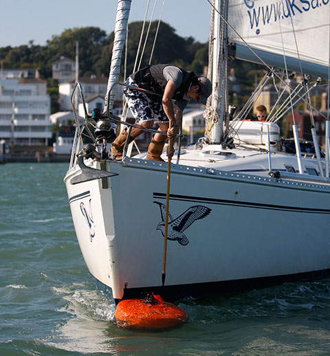

Perhaps contributors who feel that lassoing a mooring buoy with no pick-up line is bad practice would say how they do it, especially if when laying on the foredeck, the buoy cant be reached and solo.
I would love to know how this guy hooks that buoy, lifts it and gets a line onto it.
Hook and Moor pole.
Loads of moorings in Scotland have no pick up rope, just a shackle on top. Regularly pick up solo.
Never lassoed
You should equip with the right tools and trchniques so as not to damage other people's property
Pick up from the beam if too high. I have an old hull shape, over hanging bow, high, flared bow, a lot easier just in front of the shrouds. I use Moorfast type of boat hook to thread the mooring strop.
Reverse up to it, attach a long rope led from the bow, haul in.
I would either have to launch the dinghy or if already launched astern get into and take a line from the boat through the mooring and back to the boat. Five minutes work.
That is so obvious that it shouldn’t need saying. It has been our practice for as long as I can remember. Not only does the picker-up have an easier job but the helm can keep the buoy in view until the last few seconds. Until her knees got the better of her, my wife would lie along the side deck to loop our line through the ring if there was no pick-up line.
Select a mooring you feel you can cope with.
Every hull form and rig handles differently so for my 36" long keel 10 ton centre cockpit yacht with high topsides;-
I make a judgment on which wind/tide elements will allow a safe and slow approach bringing the buoy alongside the leeward bow - this to allow me time to walk forward, pick up a boat hook if a pickup line is available otherwise a Moor Fast Hook if attaching to a large top ring and for the bow to drift down towards the buoy.
If the tide is running at pace then holding position by maintaining way at slow ahead may be required - again a judgement call that comes with experience.
Approaching down tide is usually avoided as there will be no water flow over the rudder when closing to the buoy - better to balance the wind and tide effects on the final approach and go round again if the first attempt isn't quite right. Moorings out of the main stream may actually be in a back eddy!
Rope eyes through heavy buoys are usually avoided due to the time taken to thread the eye also the weight of the buoy and riser when the rope is too short to haul up to deck level can introduce all sorts of dilemmas.
Bare pole sailing down wind in a blow works well.
Picking up from a quarter is OK if the bow line is long enough and your confident which way the boat will swing once the bowline starts to take the load.
I say again - Select a mooring you feel you can cope with.
If you are a marina dweller, practice makes perfect but please don't blame the mooring owner when things don't work out the way you had hoped.
Getting into the dinghy whilst the boat drifts around some moorings unmanned in anything but benign conditions would be pause for thought.
Just drift it down to the lowest point of the deck?
