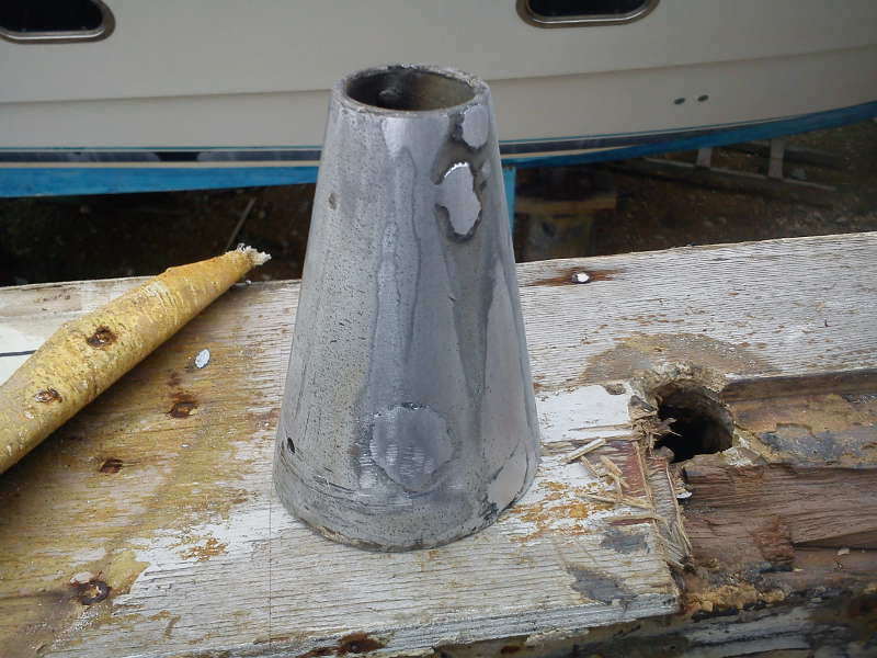

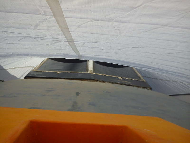

And a bit of progress although we are unfortunately now down to winter (with a chilly NW wind aligned to the aft deck) and temps down to 2-9C

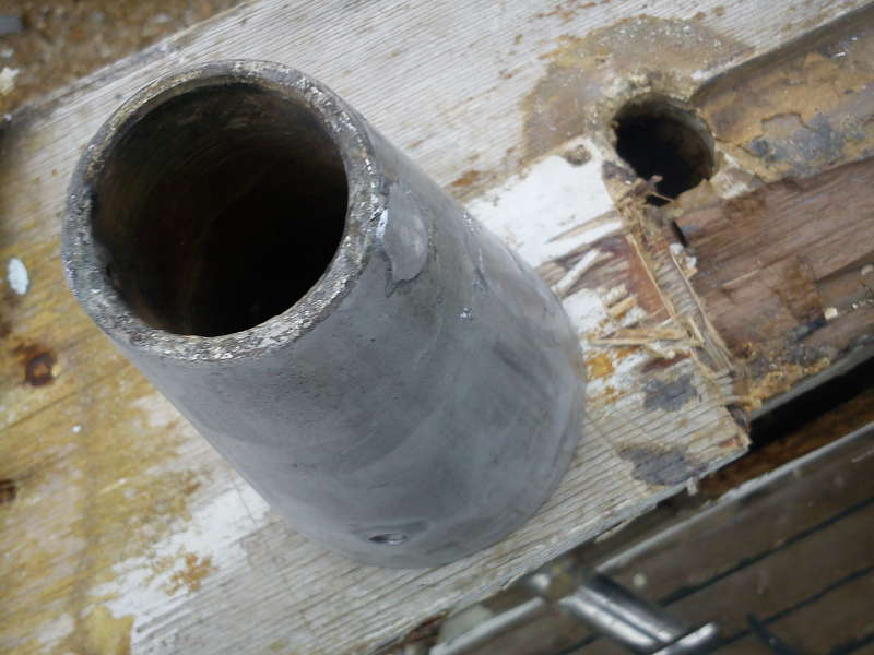

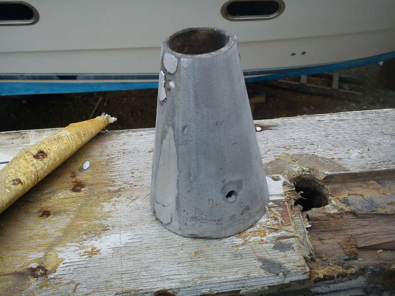

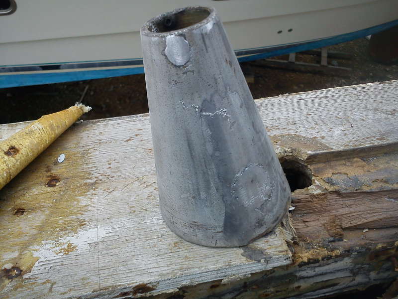

Took the stanchion supports to the welder and after an hour or so with a file and 80grit paper I sort of smoothed ONE of the 40 odd welds. Took it in Athens to the guy that did all my chrome plating, but he immediately stopped me. He argues (v.reasonably) that no matter what you do, tig welding will leave small heat/gas related imperfections at the borders of new/old material. That means that no matter what I do, I wont be able to get a smooth finish non porous and good enough for anodizing.
So anodizing out of the question and according to him only decent option is powder coating. It comes with the danger of paint flaking where the stanchion enters the conical support, but not much one can do about that...

Vas, I worry about the time you're taking on the Stanchion bases. I understand you're on a budget and want to keep the boat as original as possible.
If there the end result of refurbishing them was going to be perfect it might be worth the effort. It doesn't even seem like they are that well designed. Wouldn't it be better replacing them with some nice new ones and use the time saved to move the rest of the project on?
Sorry, if this sounds negative - it's not meant to be.

Pete, I tend to agree on this. Huge mission to get the old stanchion bases perfect. Do they need to be perfect? If yes, buy new ones. I think this will be cheaper.

Pete, I tend to agree on this. Huge mission to get the old stanchion bases perfoect. Do they need to be perfect? If yes, buy new ones. I think this will be cheaper.
+1
and more flexibility in choosing the right fit for your app.
new ss stanchions and fittings and railing, will give the boat a totally "new" look

hm, I could possibly agree with the three of you gents, BUT,
  • I really like these conical stanchion supports!
  • I find them exceptionally clever
  • I like the fact that with the three headless_whatever_JFM_called_them_screws I can regulate and tilt/roll/pan (ok, not quite :D) the whole railing and get it properly aligned.
  • I've only spent 60euro on the whole stanchion rebuilt and 5h and that's mainly checking options and thinking/testing methods
  • A new whole set of stanchions/railings in ss for MiToS would be close to 3K I'm told and no way I'm spending that right now
Once I test clean/polish the actual stanchions and a bit of railing and establish how much effort is needed and aproximate result quality I'll be able to judge.
Mind have only spent 2h on MiToS over the last 6 days and another 2h at home working on the supports ;)

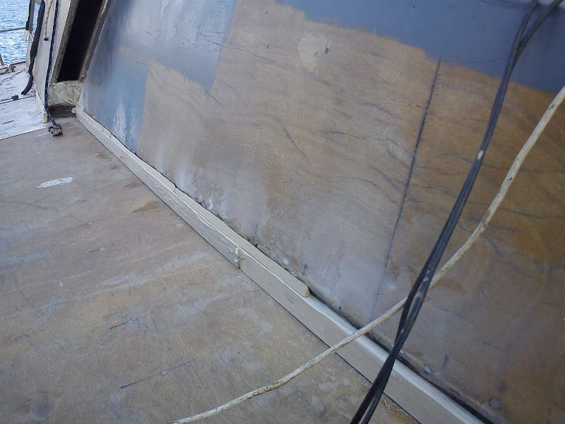

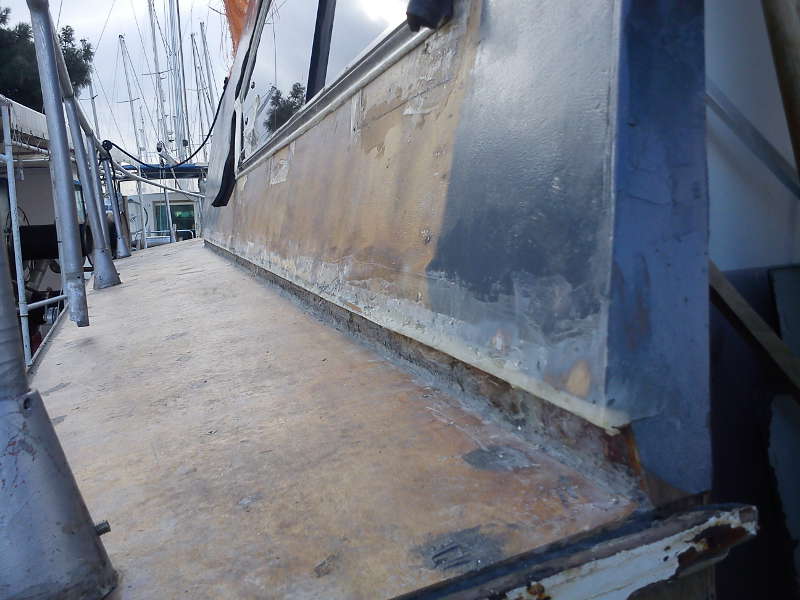

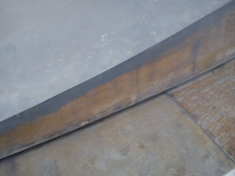

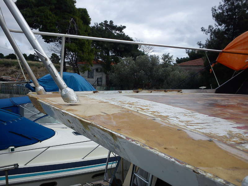

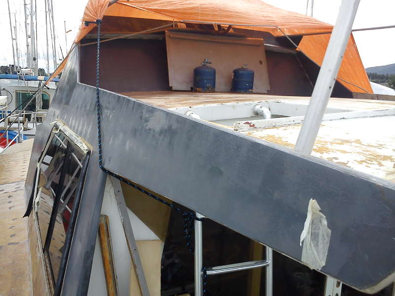

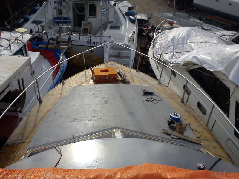

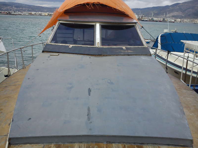

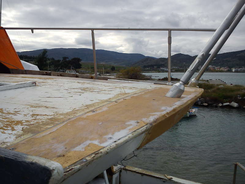

not much happened over the last week due to the lovely weather, not! and me having an awful lot of real work to deal with :(
Two things to report before I dash off to Athens for a couple of days:

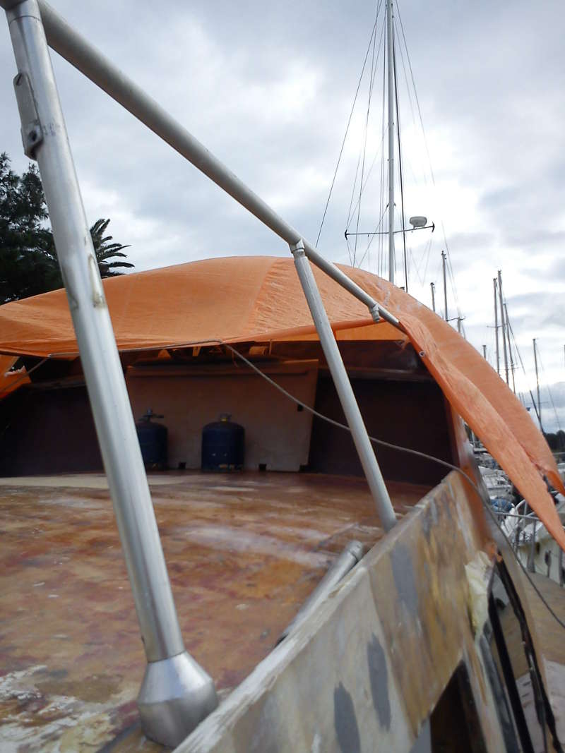

all railings back in place, not all stanchions in place yet. All f/b ones will be on Monday as I failled miserably in removing the M8 bolts out of the alloy supports, all bar one were solid as a rock and no matter how much hammering/wd40/heating I treated them with, wouldn't release. So off to the machinist to be redrilled on the lathe ;)
you can also see the repairs on the f/b deck all complete, just need a bit more sanding, a few more coats of epoxy and then the final layer of teak in June...

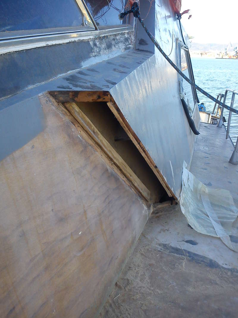

George did the edging of the superstructure over the deck which was carp and on the port side was done using insets of teak on the stbrd side decided to go for the "proper" job of making shapes as needed to fit the gaps and fill them with epoxy. Took me on Wed something like 2.5h to sand (40-60grit) the sundeck ending to the deck down to a reasonable finish (you can see that better on the last pic in this post).
Cut and cleaned the port engine intake. Was a real mess with lots of glue stuck on rotted ply, screws all over the place, awful. Now down to clean/replaced ply waiting for an endplate to be fitted.
This the salon outside wall on the port side, not sanded that yet. Winds are N, NW and that's where all the cold stuff come down, so bleeding freezing!

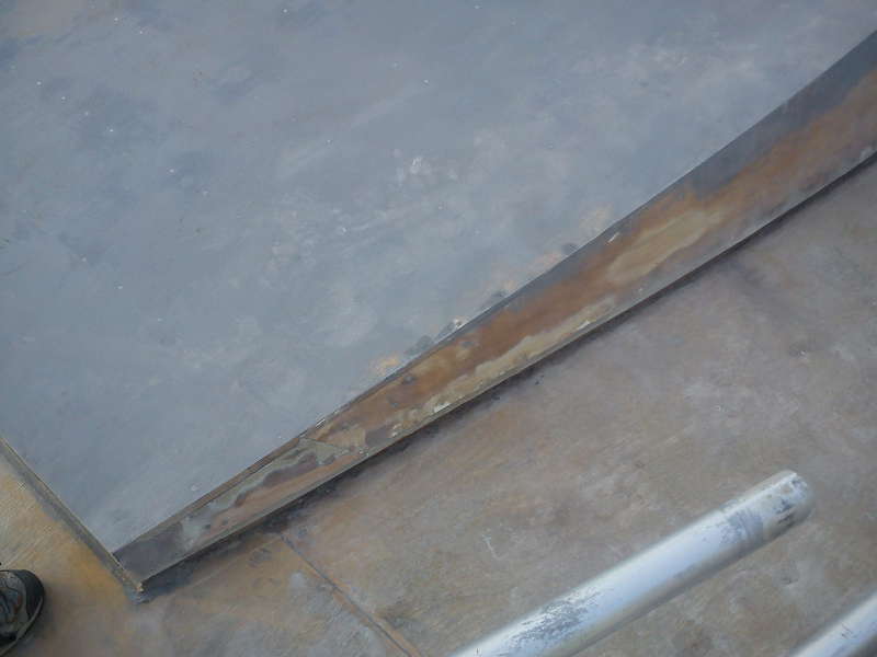

all bow railings are in. There's an issue with the modified by the PO bow roller mounted support for the central railing, probably has to be redone but will think about it. Also at the anchor light it's obvious that the railing is bent so need to straighten it somehow (a log across and a rope with a bloke on the ground pulling and another on the bow sitting on the stbrd frontmost railing seems to be the best idea up to now...)
the stbrd sundeck ending being prepared, note the triangular in section piece of ply in place.
OK, got to leave, next update on xmass eve ;)

Divemaster1
15 Jan 2002
4,450
Aberdeenshire, Scotland
Vas,
Looking at this picture, the only real difference between MiTos and Navigator bow railing setup is that our two forward stanchions are angled forwards and provide support further forwards than when they stand up straight like yours.... this in turn removes the need for the central support at the bow which you have....

temps are indeed low (2~5C), came back from a week in Istanbul yesterday late at night after an 10h drive and spent the day sorting out things at home.
Not much will be happening over the next week as I'm up to my neck with real work stuff and they're expecting snow over the w/e.
will be working outside stripping paint off the hull and inside cleaning hull, frames on the cabins testing integrity and preparing for reconstructing the whole lot.
Too cold to touch engines (planning to remove and clean all heat exchangers) so that is postponed for March :D
The 8X14m cover I fitted on the 27th survived some serious wind on the 29th (50-60kph W) and a 24+h downpour so I'm happy.

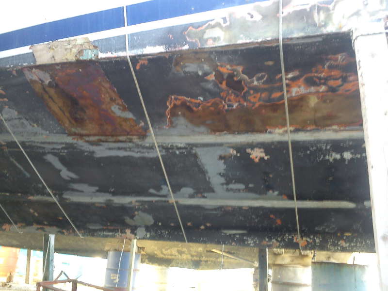

spend sometime checking securing and retightening the tarpaulin which survived some 50kph gusts on the 29th and couple of days ago, so happy with it.

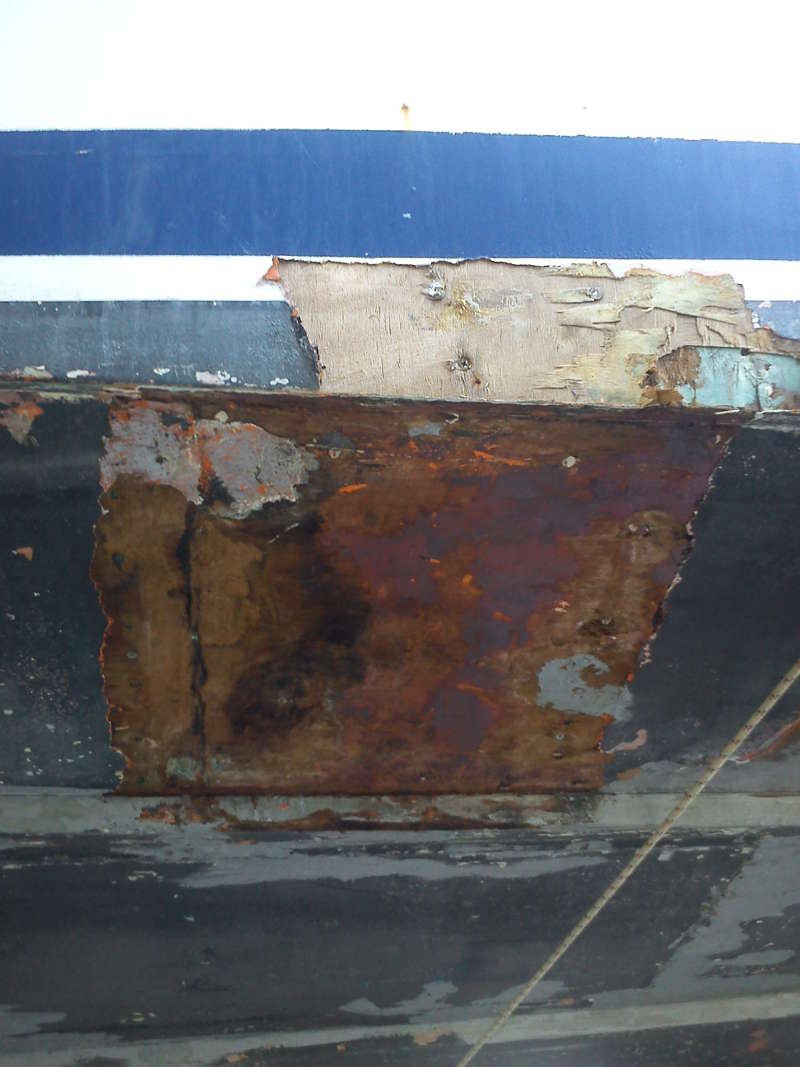

then spend an hour scrapping antifoul, primer and various carp off the hull on port side, continuing on work I've done back in June (iirc) whilst chatting with next boat neighbour that came around to check how things are...
Don't expect much progress, it was mainly the warm up for the year ;)
I reckon I can do 1sqm per 2h, but we shall see. Chines are costing me lots of time :rolleyes:

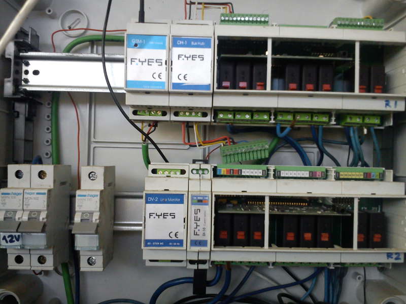

Finally, a good thing running the same BMS @ home and boat is that following a major cockup i managed at home that fried one controller that's now back at the factory for repair, I removed one from MiToS and took it home for reprogramming and fitting there :D

Thanks for the update Vas. The a/f looks like another mission. Is this not a job for a rotary sander? I understand the toxicity of the dust, so how about a project for a couple of your students? :)
:D
nah, got to find students that really like me too much and I hate them immensely. Not easy to find either I think :rolleyes:
In the past I 've tried scrapping, just hurts the arms and progress is not blindly fast tbh...
Sanding OTOH with a 40grit 125mm scratch on on a small angle grinder was a disaster with me coughing and eyes hurting for a couple of days although I used secure safety googles and breathing mask. So never again! (and was only for an hour as well...)
so I see it as an exercise for the cervix syndrome I'm suffering a bit. A way to break away all salt deposits and work out the poor body after siting so many hours working in front of a screen ;) Maybe should design a scrapping helmet so the neck muscles do a bit more work :cool:
