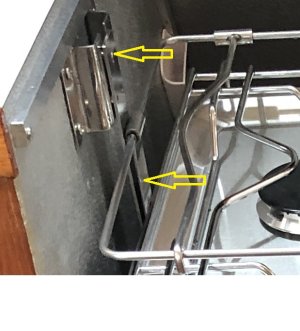

Are both units double hob and grill only, in other words no oven? If so they have a different gimbal position to the oven variety. Top arrow in the image is the position for a hob and grill. Bottom arrow is the position for hob, grill and oven. The greater drop being needed because there isn't 14kg of oven hanging below the hob grill option.
I measured the difference carefully when swopping from hob, oven, grill, to just hob and grill so that the lid would still close over the hobs when not needed. Even more so when we changed to double induction instead.
Keep the old pan holders/rails, they are stainless steel. New ones are chromed steel.
