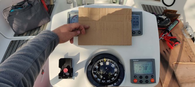

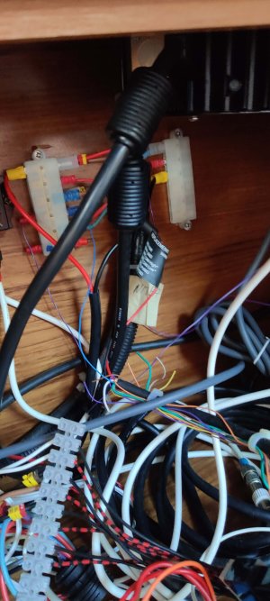

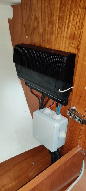

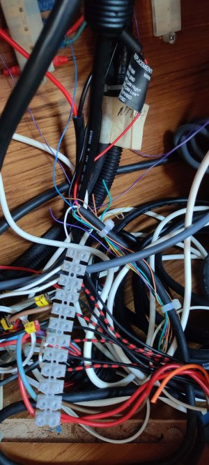

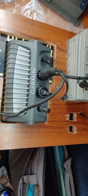

Hi,
i am looking for some help on the seatalk, nmea 0183 & 2000.
The current setup i have:
St60+ wind
ST60 tri
ST6000+ autopilot
Garmin GPSMAP 750s
I want to add:
NAIS- 300 https://softwaredownloads.navico.com/Simrad/SimradYachting_Software - Copy/Downloads/documents/NAIS300_User_Manual_Iss_1_0_Dec_07.pdf - i have bought this.
B&G Vulcan 9 Chartplotter for outside. NMEA 2000 - will be buying shortly
Standard Horizon GX1400 GPS to replace the main VHF. (NMEA 0183) - will be buying shortly

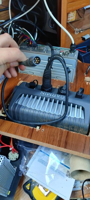

Im trying to figure out the best way to do this. The STs are using seatalk but it looks like the Garmin is using nmea0183 (I think).
My understanding is that seatalk is daisy-chained. So the data comes into one ST unit then into the next. Im assuming im missing the switchover as i can't see how this data is showing on my garmin as i can see the cable is NMEA. Im assuming there will be a converter of some sort?
the AIS looks to be NMEA0183 i think, this has come with a separate GPS. I want this to show on both chart plotters.

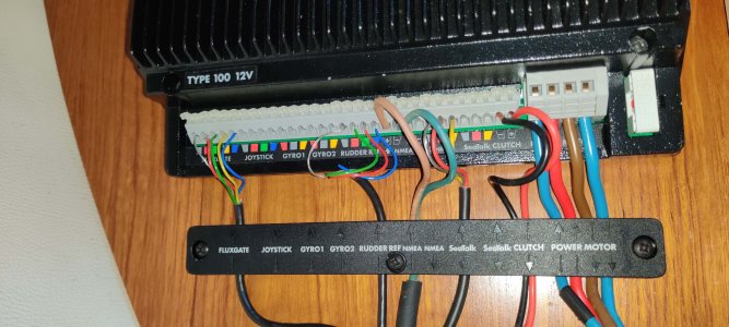

The autopilot has "raytheon type 100" which has SeaTalk & NMEA is this the "Converter" or is this solely for the autopilot.
The Vulcan 9 will be mounted outside. next to the STs (i know i will have repeated data but im thinking redundancy).
If I get the NMEA 2000 backbone and link this in with the NMEA 0183 with a converter, will all the data from the STs come through? as this is seatalk > nmea 0183 > nmea 2000
My thinking is if this is the case, then I would just need to connect the AIS to the backbone and the Vulcan 9.
Im new to all this if you can guess.
Ive attached some pictures of the set-up so far.
I want to make sure they all talk to each other before i buy them.

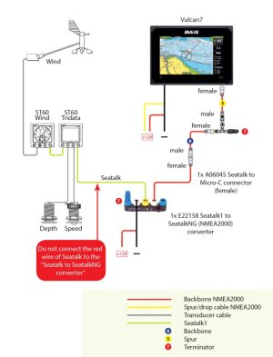

I have seen this converter - Raymarine Seatalk ST1 to STNG Adaptor Kit
"Everything you need to convert Raymarine Seatalk1 to SeatalkNG and create a backbone." is this NMEA 2000?
Yes.
SeaTalk is similar to NMEA 0183, but incompatible - they're both like 80's or 90's style serial data protocols, but they effectively talk different languages.
SeaTalkNG is NMEA 2000 with a different connector on the end - you can just cut the end off a SeaTalkNG cable and wire up an NMEA 2000 connector instead. The connectors are often sold as "field installable" NMEA 2000 connectors, but pricey. You might find Farnell cheaper.
So if you use the Raymarine Seatalk1 - SeatalkNG converter the data from those instruments will be available to everything on the SeatalkNG / NMEA 2000 network.
A NMEA 2000 network must always be arranged in a backbone configuration - see the pics in post #3 of this thread.

The Garmin can only use NMEA 0183. Pretty sure it is getting the ST60 data from the ST6000 vis 0183
No converter, see above.

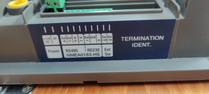

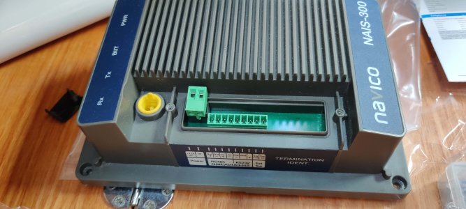

Do you have the 300N or 300L ?
Again, see above.
If you fit a Raymarine ST to STNG converter the Seatalk data will then be converted to STNG, which is N2K with stupid Raymarine connectors. You then build a N2K network and connect that with a STNG to N2K backbone converter cable. You can then connect the Vulcan to the N2K part of the network. If the AIS is a 300-L you can also connect that to N2K.
You can connect the AIS to the second Garmin 0183 port.
The Standard Horizon VHF, with its internal GPS will be stand alone.
Only if it's the 300-L. If it is the 300-N, you're a little bit screwed.

This is a mish-mash of various makes and protocols and has the potential to be a nightmare, especially if the AIS is the 300-N model.

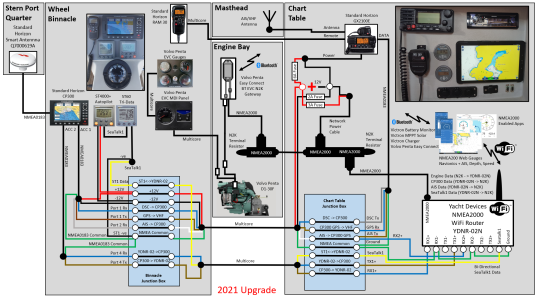

Try this ....
I used a NMEA2000 WiFi Router from Yacht Devices to network a mess of ST1, NMEA1830 and NMEA2000 .... with both AIS and normal NMEA Baud rates.
Be very careful what gets forwarded onto the old Seatalk1 network, in my setup the Gateway routed everything everywhere, which sounds great except that the ST1 link got overloaded and resulted in the Autopilot being unable to hold a course. It took me an entire afternoon of sea-trials to get to the bottom of it and a change in the routing table on the WiFi router fixed the problem.
