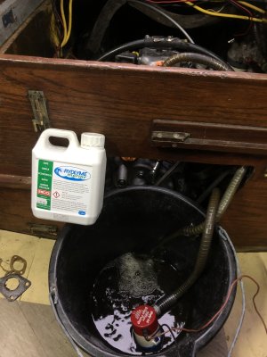

This is method I used on my Yanmar 1gm10, but the principle is the same.
Remove the engine block internal anode and seal the hole with the plate (I reversed it)
Clamp the thermostat bypass hose (with a small g clamp)
Remove the thermostat and refit the cover.
Take the hose from the water pump output and connect it to an old bilge pump.
Put 1litre Rydlyme and 1 litre freshwater in a bucket with the bilge pump (and the thermostat)
Take the water hose off the exhaust mixing elbow and put in the bucket
Pump the Rydlyme mix around the engine, in bursts and rests for a couple of hours.
Flush it with freshwater for 10mins using the same setup
Put the engine back together

I used this method on my Bukh DV 24 4 years ago and can recommend it. Rydlyme is the right stuff to use and is very unlikely to do damage that more concentrated acids could do. I can confirm that there was a fair amount of foaming up at the begining and that it is really important to take out the thermostat which is not difficult on the Bukh's.
I used a caravan water pump, the type that goes in the water tank avaliable for under £20 eg.
12V Submersible Water Pump Camper For Caravan Motorhome High Flow Whale Pump | eBay
I used Proflush on my old DV10. I set up a circuit around the engine with a connection to the raw water inlet pipe to the engine that is normally fed by the water pump. I connected the pipe from the thermostat cover back into the bucket containing the Proflush and had an old central heating pump to pump the whole lot round. I had removed the thermostat itself and the pencil anode which I feared would disappear anyway. It worked really well. You get a colour change in the Proflush fluid as the salt and lime dissolves. It also fizzes well at first! A bit of a faff but the cooling water quantity increased noticeably after the process.

I have managed to remove the thermostat so will try your method or simply pour the mixture in and leave it for a few hours before pumping it out.
I Suggest you arrange a pump around the system as I understand from previous threads the Bukh often builds up scale on the injection pipe going into the engine block, just behind the flywheel IIRC. Secondly you have no way of knowing where the poured in fluid will reach unless you pump it around.
If you cant get a pump rigged up then rig up an in and an out so you can flush a few litre's repeatedly though the engine. High level funnel into the pipe as it exits the water pump and drain from the pipe to the exhaust elbow into a bucket?
PS remember to leave the thermostat in the bucket to clean it as well.
