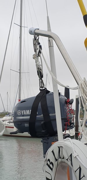

The advantage of proper davits over snap davits is that you don’t need to remove the outboard every time you stow the dinghy. Our Westerly is 39’ long by the way so very comparable.
Indeed... Had to add a crane when we got the 6hp 4stroke..
Trouble is the two smaller outboards got stored elsewhere on board... and they're still there "just in case".
Proper Davits would be the ultimate, as you say to save taking the Outboard off everetime, however I’m sure cost would be massive, but might be worth enquiring.
Which companies would I approach to make enquiries for proper Davits?
Cheers.
Our davits are by Whittall but their company/name was bought by Simpson Davits | Cooney Marine
They seem to be one of the main manufacturers nowadays.
