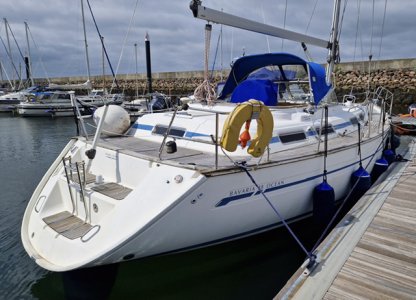

How do you store your dinghy when out sailing, we are in the process of purchasing a 38 Bavaria, and I want to buy a new dinghy for it, on the list is the Zodiac Cadet Alu floor either 270 or 310, we want to have it easily available.
Beam is 4m, however stern narrows a bit at the rear, would like to mount dinghy is some way across transom, had wondered if snap davits were a possibility, do they work on yachts, also if dinghy to wide, would the lower tube drag in the water if heeled over?

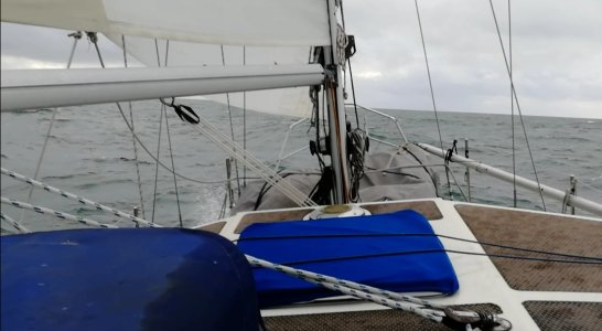

Part deflated in front of the mast, using a halyard to lift on and off. Inflated is possible but takes up too much space. Obviously a bit of messing around to launch/retrieve. Screenshot_20230530_171355.jpg

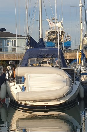

On my 37 a 2.4m rigid transom fitted comfortably upside down forward of the mast. hoisted by the spinny halyard. pretty sure there is room on yours, strapped down to the guards round the dorades. Some boats. like my later 33 have folding Wichard D rings for hold down. Yes, restricts access forward but does allow sailing with the forehatch open which we found useful in the Med. Half deflated behind the mast might just work but bad for visibility. Completely deflated on top of the aft cabin would also work. The transom is too near the water and too narrow to use snap davits. Ends of dinghy dip in water when sailing - as in Stuarts boat which is a similar Moody. standalone davits are a bit OTT as you really need the extendable ones because of the overhang of the stern, but many have built gantries with davit arms, solar radar etc.

On our 40 footer, upside down on the foredeck for short trips but it covered the main forward hatch. The bows were tied to the eye for the spinnaker downhaul and the stern to the forward end of the genoa tracks.
The dinghy was an XM265 which was light enough for the two of us to haul it up over the rail using the painter and bridle. Outboard was removed before lifting.

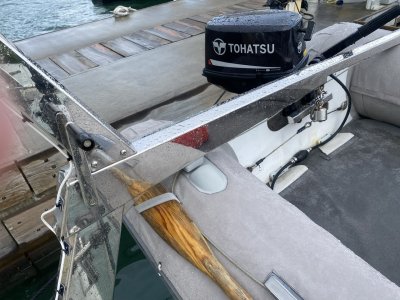

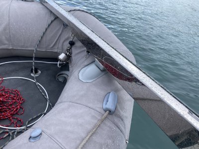

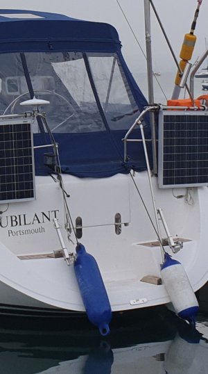

This is how a Zodiac Rib Compact 250 (apparently equivalent to the Avon RibLite 260) sits on Weaver "snap up" davits on a Moody S38.
I did measure and stick the pads on so that the dinghy would end up central.
Looking at it afterwards I think it would have been better sitting just off centre (slightly towards it's bow).. but only maybe by an inch or two.
It's on these "snap up" snap davits in their lower position.. Picture below shows the davits in their upper position but being a true hard bottomed rib, it's a bit heavy to lift the davits to their upper position by hand once the dinghy is on them so they've remained down whilst in use.
I mounted them on angled blocks of wood so that they would just clear the lower transom in their down position.
In their down position they are just right for clipping into the dinghy.

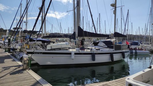

41” Bermudan sloop. I changed from a hard stern inflatable to a round tail inflatable. Hard tail was stored deflated, folded in its bag, lashed to the coachroof in front of the mast, aft of the inner forestay. That was a secure position, quite low profile, but used up useful deck space for lounging on. When I bought the boat, previous owner stored on aft cabin roof, but I didn’t like that as aft cabin roof was another place folks liked to sit, lounge on.
Changed to a round tail that I now deflate, roll up and store in the cockpit locker. The round tail is smaller as a result.
Usually it is just two up, maybe 4 up. So the smaller dingy is not an issue.
Inflating and deflating, folding away is not that big a deal, 15 minutes.
I am considering davits but narrow stern might be an issue. Round tail can take ply floor boards, so would be stiff enough, but no drain on stern, hence would require cover. Feels like too much hassle. Larger hard tail would probably stick out too much, in my case.
I occasionally tow dinghy with bow pulled up, out the water.

To summarise... It's not cheap using snap davits and as RunAgroundHard says, it's usually only a ten to fifteen minute job to get the dinghy out of the locker, inflated and dropped over the side anyway.

We store ours on the foredeck and use a halyard to launch. It's a little bit of faff but much better than towing etc. I made a 4 point harness using the lifting eyes in the bow of the tender plus some metal eye bolts installed on the transom, the holes for which are pre-drilled on the Cadet but not waterproofed in any way so put some gunk in there to seal.

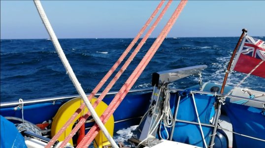

On davits on the stern with outboard on. Always ready to go at a few moments notice.
We have these rubber block things glued on that stop the dinghy from swinging around.
We crossed the Atlantic with the dinghy on its davits. One or two heart in mouth moments when extra big rolls dipped the transom of the dinghy nearly in the water but no real problems. In normal sailing the dinghy is perfect up on its davits. I’d not want to go back to any other system.

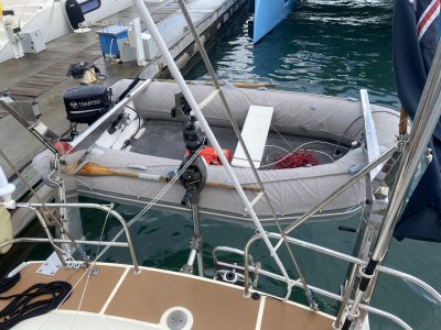

View attachment 157431View attachment 157432
Friends had their rib fill with water on an Atlantic crossing. They now remove it and deflate and lash to the foredeck. It didn't do any damage luckily
