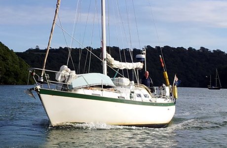

What's wrong with this? Boat is 27ft (photo was 2012, topsides since resprayed), tender was 8ft (rotted eventually as was already old and of cheap ply), currently using a 2.4m inflatable with hard transom but still kept capsized on foredeck when cruising.
Inflatable can easily be launched/recovered by hand over the guard-rails, but the hard tender used a simple rope-cradle and a block-and-tackle (1:8 advantage) clipped to the spinnaker halyard.

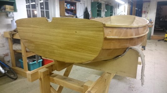

One day I'll finish this Iain Oughtred Humble Bee pram:
