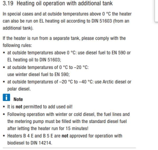

so i can use kerosene with the Planar 4D i ordered? Can i Use diesel first before i receive any kerosene and then change from diesel to kerosene
Not according to post #74

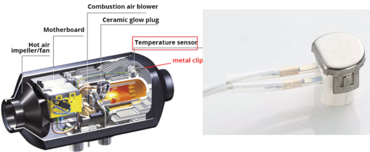

It has been reported on here, by a marine electrician that i know, that (as a test in the workshop) covered up the air intake and the heater got so hot the casing melted. There should be a safety cut out to stop that happening, obviously.
The Chinese heaters I've had in hand all had a thermo sensor and all reported it ON by an icon and the °C value to the display.
About so:
1700755318321.png If is was defective, not fitted right or tampered with, it of course would't work
I would think so but I am not an expert, only repeating what I was told a long time ago.
Edit: yes, all in the installation manual on the website. The heater shuts down on overheat. It also states that only diesel fuel can be used, not bio.
So far, all my personal experience of this type of heater has been with Eberspachers. My present one runs exclusively on kerosene, approximately 100 litres per annum, and has done for several years now. I have a 20 litre separate tank for it, but with a two-way cock, so that if I wanted, I could revert to diesel from one of my main tanks.
Kerosene is about half the price of red diesel.

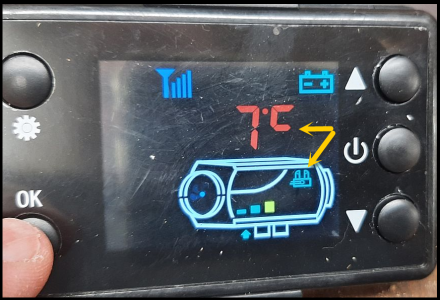

About so:
View attachment 168090 If is was defective, not fitted right or tampered with, it of course would't work
Isn’t the C value the temperature measured by the sensor in the control unit (so, your “room temperature”)? That’s the one used for the thermostat. The heater temperature is generally reported by the bars (in your picture, two blue, one green) in the heater icon. Not sure if there was a place to also see it in numbers.
No. The Display shows the room temperature (measured at the display itself), the heat exchanger temperature as measured by the sensor and the user set (desired) temperature.
The bars show which of the heating steps (1 to 5 or 6) it is running at. Manually (showing a P or H value, automatically by showing °C.)
Manual/automatic modes can be selected by a button on the display.
