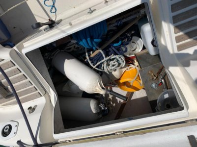

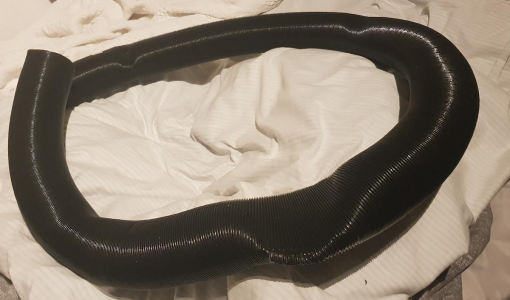

I have fitted them in such lockers, no problem. The heater ducting gets fairly hot close to the heater, but you'll want to lag that or most of the heat will be lost in the locker, it's often best not to lag the first foot or two, or the heater can get hot. The exhaust will get very hot, again, this needs to be well lagged.its it ok to install the planar in the cockpit locker where the boats steel 25l diesel tank is too? thanks
(like this one)
Thank you. Can i get the lagging off ebay?I have fitted them in such lockers, no problem. The heater ducting gets fairly hot close to the heater, but you'll want to lag that or most of the heat will be lost in the locker, it's often best not to lag the first foot or two, or the heater can get hot. The exhaust will get very hot, again, this needs to be well lagged.

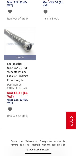

Genuine Eberspacher exhaust hose is at £8.43 per M right now from the biggest UK seller! If you're talking about the through hull then £50 is about right but these are not included with most Eber or Webasto kits anyway so its always an extra cost .I’ve found the cheapest “proper” marine exhausts are £100+vat. There’s an awful lot more to replace than a few clamps. A “decent” Chinese 2kw is more like £150 before you start replacing anything.
Disappointingly, I’ve found the savings are not as great as they once were, especially if the install is by the book, using quality parts.
Sure, but who fits just bare exhaust hose in a boat?Genuine Eberspacher exhaust hose is at £8.43 per M right now from the biggest UK seller! If you're talking about the through hull then £50 is about right but these are not included with most Eber or Webasto kits anyway so its always an extra cost .
