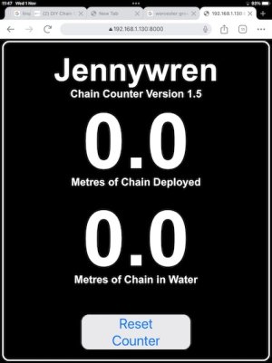

Just tried your suggestion re creating programs using ChatGPT, with your chain counter as an example, and sure enough it responded in seconds, proposing a suitable hardware and software build - love it :).
FYI I am in the process of assembling the components on the breadboard for your "Opto Isolator Hat", that began this whole thread, then I guess its onto testing the full functionality.
One point to note, for others thinking of running with this project, is I purchased a Raspberry Pi 4 2Mb, and this uses a USB C connector for power, so ensure whatever Voltage Converter is selected supports a USB C connector, otherwise they will need an adaptor.

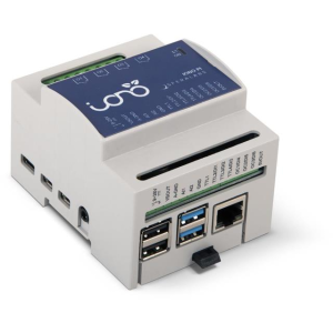

I think I posted this before but it's a really nice solution for a 'PLC' type device, already has a bunch of ruggedised inputs and outputs as well as an onboard dc/dc converter so you can feed it raw 12v.
It's just a Raspberry Pi with a hat on it inside.
Iono Pi - Industrial Raspberry Pi PLC - digital/analog I/O Relays CE FCC

Hi, thanks for the update, and the "alternate process for skinning the cat" much appreciated.
Current setup
I'm running Terminal through a MacBook Air on Monteray, and I am using the Mac as the "Master" connected to the RPI via console.
On the RPI, which is a Pi4 2MB, I have loaded a full version of Linux, incl desktop, I have a monitor, keyboard and mouse attached to the RPI, connected to my network over WiFi - addr 192.168.1.130. I have Terminal running on the RPI so I can see the directory structure etc.from both the Mac and the RPI
From your notes got as far as.
Running ls (Linux's command to list directory) should produce this output:-
node_modules package.json package-lock.json
These files/directories are the node addons (in this case just the onoff library)
The issue appears to be connecting to your server for the download part. When I run the command
scp *.* mike@10.0.20.128:/home/mike
I get Time Out errors and then disconnected, so I think I am trying to get to your RPI, which as I now appreciate, I cant.
From Terminal on my Mac I have just successfully run the line
sudo wget https://www.maidencombe.com/chaincounter/CodeVersion1.5/boatname.conf
and it has saved the file, which I can confirm on the RPI setup using Terminal and Filemanager - so its looking very positive, and I think you may have provided the answer to my problem.
I will now follow the rest of your commands, and hopefully report back success on completion.
Despite the problems I am really enjoying getting my hands 'dirty' again, my background goes back to DOS , so I do see the similarity in a lot of the commands, and I do appreciate your assitsance and help. I'm hoping the learning curve wont be too steep, and looking forward to getting into the world of Linux and Raspberry's. PS FYI following your other comments re Linux, I have installed it on an old Macbook Pro, and I'm very impressed by the performance improvements, so more fun times ahead I think.
I'll let you know how I get on - Cheers Garry

and VOILA - big smiles here, now I can modify and personalise the screen - many thanks again
Hurricane
11 Nov 2005
9,587
Sant Carles de la Ràpita
Well done.
I bet that is satisfying.
You will need to make some hardware to read the windlass reed switch and the "Up" button.

Yes I am very pleased with the result.
I followed your guidance and 'created' and fitted the hat for isolating the inputs from the reed switch and emulating the UP switch on the windlass - I actually fitted a reed switch and used a small magnet to simulate the windlass operation. Its functionality is exactly what I wanted. My anchorman commented that 'that will make life so much easier now' so I have to thank you also on her behalf ;-).
Re the Linux on the Mac, it wasn't that difficult, I have tried two flavours so far, Zorin 64 bit, and ubuntu 64. At the moment my preference is for Zorin, it has a more rounded interface, however I intend to install a couple more flavours before I make my final decision, so I will definitely checkout your suggestions.
I would also endorse your earlier comments about using free software whenever possible, I currently use Google Docs, Slides and Sheets for all my office work, but also in the past I used Open Office - the predecessor to LibreOffice I believe, and all achieve the same results for a lot less financial outlay.
Finally I have to thank you again for your project, which was fun to build, and I would highly recommend it to any boaters out there who wants/needs a chain counter. Note fyi it has actually broken the ice for me re getting into scripting, something I have wanted to do for some time now - I now intend to step through the code and hopefully understand what it is actually doing. Fingers crossed, I may then be in a position to delve further into, and take advantage of, the huge amount of scripts and programs currently freely available on the net.
Cheers Garry

How will it work on your boat?
I have a ships LAN and my RPi chain counter can be accessed by anything on the LAN.
One option I have is an old Android phone set up for this job.
I specifically designed it so that any web device can connect to it.
You could use the RPi as an access point - or even simpler with a monitor connected to the RPi.
I really only built it for myself so it is great that someone else can enjoy the work.
I don't have any formal training so don't expect anything special in the code - just what I've picked up over the last 45 years of being an enthusiast (even before the days of the IBM PC and the BBC Micro).
GarryF
6 Nov 2020
12
The boat is an old 40ft yacht which I am slowly renovating. It has a legacy Seatalk / NMEA 183 network to which I have added NMEA 2K and a TalkTalk router providing me with my own WiFi, so I am hoping I can connect the RPI over WiFi. If not the router is also connected via ethernet to a Ubiquiti Bullet for connection to local networks, so I could also run an ethernet cable to the RPI.
And yes, so far, it works across all my devices, I have tested on my iPad, iPhone and Macbook Air without a problem so far, so I think it should be good. Obviously I have yet to rig up the "chaincounter box' to the windlass sometime early next year, ensure there is a magnet fitted to the gipsy, plus I intend to position the box in the front of the boat, so I need to check on the cable lengths for the reed switch etc. But I am pretty confident now I have the 'hard part' ,ie your coding, functioning.
My boat is 20m long and my router is about two thirds from the bow to the stern.
WiFi worked but was a bit flakey.
So I use a wired connection to my router - I had one near the bow anyway (for the Anchor Camera).
I understand that the RPi's WiFi isn't very strong so you might have problems with the connection.
That said, all the important detection and counting is done, locally, on the RPi so it shouldn't loose count but the web connection to it may get a bit flakey.
As with all projects like this (and fault finding) the key is to start with something that works and make changes accordingly.
I use that process all the time.
