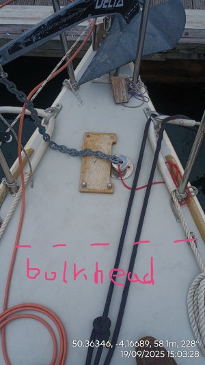

This is a standard early Fulmar foredeck apolloduck.co.uk/boat/westerly-fulmar-for-sale/784930 and as you will see it is going to be a challenge to fit a windlass and a self stowing anchor, never mind room for a boomerang. Others have a more substantial double bow roller like this apolloduck.co.uk/boat/westerly-fulmar-for-sale/805976 on which an NG 10kg (but maybe not a 15kg) might self stow. However when you look aat the space available and the location of the naval pipe down into the chain locker space for the stock and any swivel will be at a premium. The Op will need to do a lot of measuring and thinking - and then probably some structural work to install an efficient system. a pivoting self stowing roller may well be part of the solution.
This is what we've inherited. The old, manual windlass was dead and removed prior to selling.
I'm prepared to do an amount of structural work, certainly minor works like moving the spurling/navel/naval/chain pipe. Ours is now aft of the original spurling pipe position (which is where I thought it was when I saw this Maxwell windlass, and would work for that). I could reinstate it...
However, there's more height for the chain to fall where it is now, so it has that in it's favour, although possibly the chain originally slid down the bow to the locker case and heaped up from there.
We have a double roller, but it's got the forestay integrated, so I'm not sure how far I'd want to go with alterations there. IDK about anchors self stowing - something I'll have to look into and see if it motivates me to make possibly significant structural changes.
I've got all winter to get this right and won't be rushing into anything.

You are part way there. You may have to mount the windlass further back than the current position to get enough distance from the bow roller to enable the anchor to sit in the deck when fully in. The double bow roller should effectively stow the anchor - the forestay fitting is not an issue, it is very common with double rollers. The critical bit is the clearance below the roller before the fluke hits the bow. The further back the windlass the greater the fall giving the chain a chance to drop cleanly without piling. Smaller chain helps with this as well. With most windlasses you don't need a separate pipe, just a hole in the deck in the right place to take the fall from the gypsy.
Thanks . We had the fluke situation on our Centaur and just kept it lashed on the foredeck for years (with a mind to improve things, mañana). However, we want to start out a bit better now and if we can get it to work over the bow, that'd be good.
I feel like there could be diminishing returns moving the windlass-chain fall too far back, as the chain locker bulkhead would impinge on the chain cone footprint - worst case, there could be only space for half a cone pile if it was right back.
WRT the hole, would there be no short pipe/upstand to prevent sheet water entering, or is that built into the windlass form?
