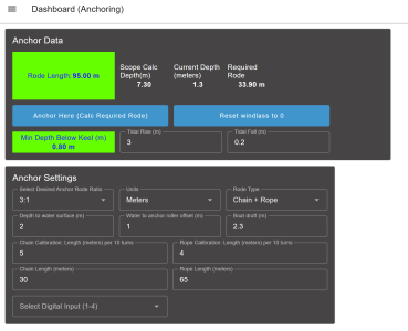

DIY Chain Counter - Again!!!
The Admiral pointed out that in my rush, I omitted to consider the tidal changes! Version 2 has user inputs for tidal rise and tidal drop.... scope is calculated for the highest tide, min depth below keel uses current depth (from the transducer, corrected for placement) minus the tidal drop. I'll need to be at the boat to enable the connection to Victron Cerbo GX (rode counter trigger) and SignalK (depth).
