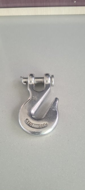

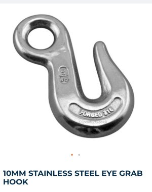

I've just replaced the anchor chain on my 13M powercat. The chain is 10mm galvanised DIN766. The old setup had a 10mm snap hook attached to the bridle which clipped onto the chain - it did the job but I was never entirely happy with it and put a replacement on a long finger list of things to do. Anyway my hand has been forced now. The snap hook won't actually fit into the links of the new chain. So what to buy? I want something that will be easy for my wife and daughter to attach and unattach. So what do others recommend?

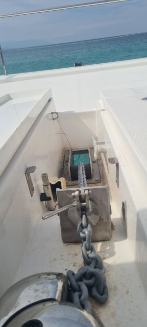

As I'm sure most of you will appreciate deploying a bridle or a snubber on a catamaran is a bit different and more tricky than on a monohull with a bow roller. The anchor chain roller on mine is below deck and a full 3M aft of the bow. I took this photo just now.

Lucky you. Having the roller so far back is an absolute pain. If I want to attach a snubber to the deck cleats I either have to get in the water or try fishing from the bow to grab the chain in the water.

It looks like the issue of getting the chain, potential under load, accessible near the bows which seems to be the issue, not the hook type.
Could you put a large tough metal pulley on the chain, attached by a rope to an accessible place at the bows, and lower through that - then use this to pull the chain forward to attach the bridle?

The type shown in #2 is not optimal for multihulls. Multihulls need hooks that positively lock onto the chain and will not drop off when unloaded. The reason for this need on multihulls is 1) They tend to anchor in shallower water and 2) the bridle is long when attached to the bows of the outer hulls. It is common for the hook to end up on the seabed because of these reasons and if not locked on will soon drop off. I use a Mantus M2 for these reasons. I don't know if you can use a bridle with your arrangement but reason 1 still applies.
