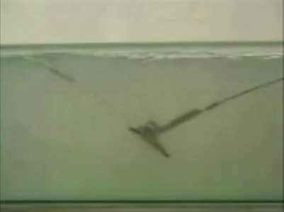

Bruce, the man and the anchor company he founded used scale model anchors and artificial seabeds. This is a screen shot from one of their videos of how one of their anchors with a hinged 'crown' could be used to retrieve the anchor. A but was designed to fail at specific tension and when the bolt failed the shank rotated allowing easier retrieval
The medium is a synthetic and transparent clay in water. It coincidentally shows the reverse catenary of the buried rode, the scope is NOT the tension angle. 3d printing makes such tests so much easier
The scope used to test does not actually matter as the relationship between scope and tension is well known - as long as the scope and rode are defined. Because the hold of an anchor is quite high, 2t for a decent 15kg anchor under water, in sand, then testing anything larger is, very, problematic. Tractors make a good and cheap workhorse as do Bruce' synthetic seabeds (especially as anchors the size that Bruce made are that little bit bigger than ours).

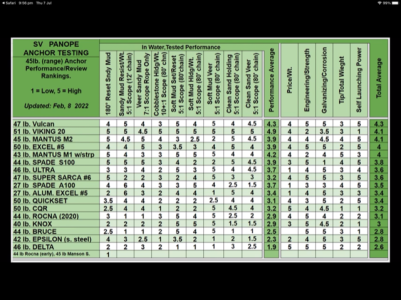

Comment was passed about 'tip weight' with the implication that this is important. The only detailed list of tip/total weight that I can think of is the Panope spreadsheets and there is no indication that a high tip weight is advantageous, or other factors are more important. Vulcan and Viking have 'average' tip weight and are rated highly, the Excel has a poor tip weight and is rated not much different to the Vulcan and Viking.

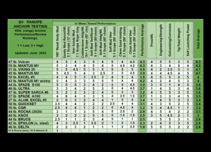

I am not sure why an older version of Panope’s results have been posted. This the current version. While no testing protocol is perfect, in both versions the Delta anchor is not doing very well. This agrees with my photographic results of Delta anchors.
This does not mean the Delta anchor has no value. In good substrates it can still work well, but in more challenging substrates the performance can be poor, as the OP has experienced.
Does it matter.
The point being made was that tip weight in either has no or little relevance to the ratings.
If you want to be picky:
There is another spreadsheet dated Sept '22. :) - reasons....? and another in Nov 23
The date of the spread sheets is irrelevant tip anchor weight has no relevance to the Panope conclusion of 'excellence'. The most popular anchor (Rocna) in this forum (YBW) and many forum is shown at the bottom of your and my spread sheets in the early spreadsheets - without any comment nor qualification - which might lead owners of a Rocna and many who have tested a Rocna, for example Yachting Monthly, to question the results and the test protocols. If the author had reservations, and rating a Rocna below a CQR should have raised more than alarms bells for both spread sheets, - Rocna should have been completely omitted. If the data for Rocna is questionable then the data for other anchors might also be questioned, including the tip weight comparisons.
I accept that linking my spread sheet could be deemed inappropriate - but the only comparison of tip weight I could find (and personally I think tip weight is a complete red herring - but it was raised and must merit a comment). It does not matter which spread sheets - tip weight is irrelevant in the Panope conclusions.
Additionally if you are like Noelex. :) , or me, and are lazy - then historic spread sheets show some questionable results.
But tip weight is consistently irrelevant (which was my point) other factors were also not relevant until Noelex questioned my choice of spread sheet - which opened another can of worms (of which we have not reached the bottom :( ).

All the guidance is pretty clear about when a larger size anchor might be considered which includes exactly the point you are raising. Read the links in post#113
However (like the other situations - marginal cases, high windage, multihulls, extra heavy displacement) this only applies to a minority. It is not difficult to decide if your situation is one of those, but there are some here who state categorically that everybody should have a bigger anchor, when for the vast majority of people this is totally unnecessary.
This thread is an excellent example. The OPs situation is quite normal. He has an ordinary boat with an appropriate size anchor and is having difficulty getting it to set in seabeds that are known to be difficult. The answer is partly technique and partly to replace the anchor with one that is proven to be better in these conditions. A larger anchor of the same type will not help, and the recommended size of the better anchor will work just as well as a larger size of the same anchor.
