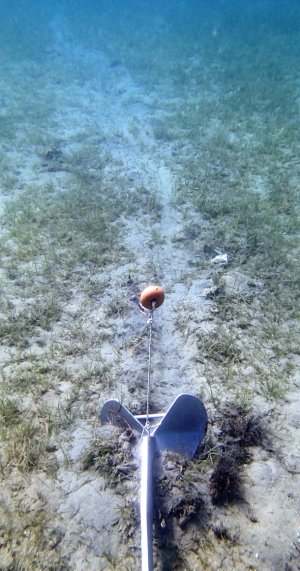

A "better" anchor might help in the sense that it should dig in more easily and have better holding power, giving one more margin for error. So if you then back down on it harder or faster or with less scope than ideal - or it's non-ideal anchoring substrate - it may still bite where the "worse" anchor would have skipped merrily along the bottom.
Different anchors work better in different seabeds for sure. Others here have more experience in the Med, I've only ever used whatever came with various charter boats out there... can't remember but yes most probably a Delta. They do seem to be the default anchor with a lot of production boats, possibly to do with cost and/or bow roller storage convenience.
As liveaboards doing an Atlantic circuit 20 years ago we struggled with a bit over-size CQR, and never looked back after swapping one day to what had been our kedge Fortress (surprisingly light but massive fluke area). The Fortress was a comparative delight to haul up too, no windlass (we were young!). As a result of promoting the Fortress forward we also found out we quite liked what had been the back-up kedge, a tiny old Bruce - which you could physically throw (again, we were young!) quite a long way. So we relegated the CQR to the bilges but were glad we'd kept it when eventually one of the Fortress flukes bent (which to be fair they replaced at no cost, as per their warranty) off Venezuela somewhere...
More recently in the Solent, after occasional mixed results with a Delta, and losing that to internal corrosion on a (inherited-with-that-boat) swivel (of the type I now know never to fit) we found its replacement - a similar-weight Rocna - was better. But still absolutely useless with a Coke can stuck on the end of it!

On the thread below I posted a photo of every anchor I observed over an 18 month period. There was no selective editing. There are hundreds of images with contributions from many cruisers. Very few show convex plough anchors, such as the Delta, performing anywhere near as well as new generation models in the same anchorage.
This is not some conspiracy. The Delta struggles in some difficult substrates such as hard sand. The difference is not subtle.
