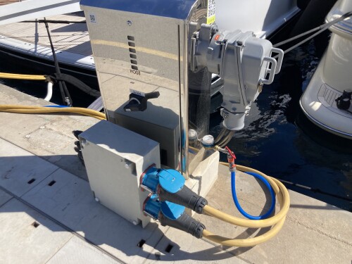

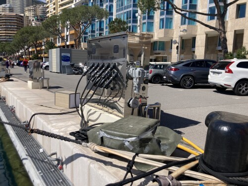

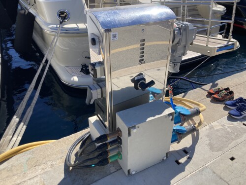

Being a total nerd I couldn't help but looking at how the superyachts in Monaco were plugged in yesterday (much to my gf's annoyance)
You know you've made it when your boat requires 660A powerlocks to light it up
In this photo you can see three phase and earth powerlocks being fed into a converter box which is changing it into 2 x 125A three phase and earth ceeform style sockets.
Presumably the boat has two totally separate systems internally for situations when the biggest socket it can find is 125A.
Note how there is no neutral, so they must have big transformers on board to drop it down to 230V / 110V for domestic style appliances.
But then you look across at your neighbour and realise he's made it even bigger time than you, as his boat requires these monsters. Anyone know what sort of connectors they are?
