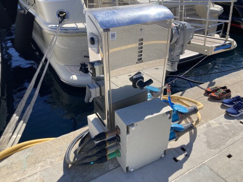

Being a total nerd I couldn't help but looking at how the superyachts in Monaco were plugged in yesterday (much to my gf's annoyance)
In this photo you can see three phase and earth powerlocks being fed into a converter box which is changing it into 2 x 125A three phase and earth ceeform style sockets.
As you have admitted to being a nerd, I hope you won't mind me pointing put the the ones you say are Ceeform are in fact Marechal, not Ceeform. That's a pair of Marechal DS9s, 150 amps per phase not 125. These are what I use in Antibes.

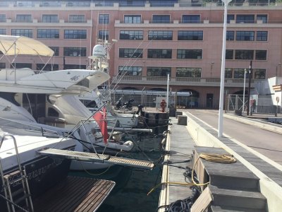

DE976C7B-7366-4D11-8670-6C9142DFBDBA.jpegIf you look carefully they were setting up the paddock for the classic GP .Twas a good week .Cars turned out we’re more interesting than the boats if i am honest . No one seems to give a 8hit about flags in this town btw FWIW ?? As you can clearly see.
A single shore 32 A is power lead ….keeping on thread 😀.

Nice berth for watching the Historique - close to the pits/prep area zone. The Azimut 46 is Monaco flagged so doesn't need/should not have any courtesy flag. From your pics I can't see the situ on the other nearby boats. Mr Green's Malta reg ship is flying the correct flag.
