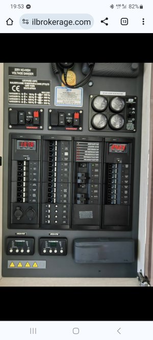

Boat is in Croatia and I won't be seeing it until mid April. I got an owners manual online but it doesn't say. It may be obvious when I actually lookat it properly but I do recall seeing the 2 shore supplies showing separately on the electric panel and both showing 32A - photo not clear enough to be sure.Screenshot_20240330_195343_Chrome.jpg

BTW, also your photo above doesn't help a lot, because as you said it's not clear enough.
It's unusual to see only one AC Vmeter in a boat with two AC power cables, anyway.
Or is the small switch under the display a plug1/plug2 selector, maybe?

nice boat IR, I guess you'll be jamming the bow facing door open (and the aft salon one) and no need for aircon.
Curious, the single salon port side seat looks like it could have engine controls hidden under the small table in front of it?
Or you have to be up on the f/b to operate the boat at all times?
Back to your Q, I feel that from the symmetry of the el.panel, the fact that there are 3small buttons under each led gauge (and the fact that in another photo I found on the web the port side shows voltage and not Amps as your does) I'd go with the each hull one shore power. Which means that you'll be most likely using the stbrd one as that's where the galley and the master cabin is!

Thank you. Flybridge operation only. Salon controls are an option but not fitted on mine. Mine is a 4 cabin version and, while the galley is stb, as you say, the grill on the flybridge is port side.

Just a guess, but the panel says 220v high voltage...this could indicate 2 or 3 phase supply at 110v.
