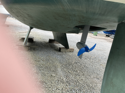

This is a subject we are keenly researching. A 2 ton fairly racy trimaran, could up our solar output to 400w. Currently running a Honda 15 outboard, still in good nick so not in a rush. We have no shore power. But then, we very rarely motor any distance. Normally it’s from the mooring, through the bridge and the marina, dodge the ferry and put the sails up. Bucklers Hard is probably the toughest challenge, you really don’t want to sail a DF 920 though moorings, with other traffic. The locals would die of heart failure, my wife would be very silent and white as a sheet. But, the boat is easily driven, and the weight not all being hung from the transom would be great. Integration with new LiPO4 house batteries is part of the plan. Would the 6kw ones push us along ok?.
At 2 tons, and for the purposes you describe, a 3kW motor would be enough... but as the price difference is not that significant, in the context of total system cost, then a lot of people buy the 6kW. You can use either of the dominant makes - ePropulsion and Torqeedo - with other-make batteries but lose some communication functionality and features such as regenerative charging (which has the potential to work well at Dragonfly speeds).

I didn’t realize that it regenerates....on my Tesla that is significant source of power.....so you leave the propeller dragging in the water ?....if the day was windy enough, could you turn the Torqeedo upside down and let the prop catch the wind🤷‍♂️🤔😂🤣
I didn't know that was a thing, what a superb feature. Would a knot or two of tide on a mooring be enough?
sadly not on it's own - I think the ePropulsion starts to regen above 4 knots but had heard it's not too much - it's more 6 knots where it starts to do better and I think our hull spead is 7knots. But for a cat/trimaran I think it could be a nice extra as it gets stronger towards 10knots
Shame, as having something trickle charge over a week at 2-3 knots would be so useful on our mooring on the Strait :)

As Marceline says, no, it's really only useful from 6 knots plus. And you have to bear in mind that it creates drag (you can't get something for nothing!), and the amount of drag is the same regardless of boat size, so that drag has proportionately more effect on smaller boats (which are less likely to get to 6 knots in the first place). But great potential for multihulls yes.
