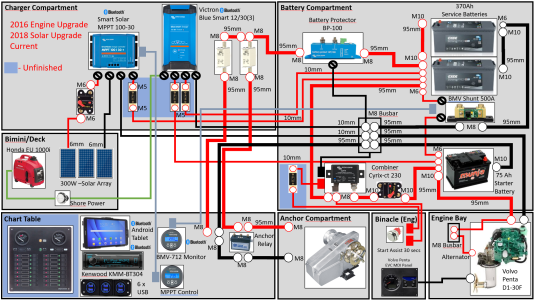

Ha! I can see how what I wrote could be misinterpreted. So far as fusing and cabling go, 60amp 10ka mrbf fuses direct to battery terminals with 25mm cable to bus bar followed by a 110 amp t-class up to the isolator switch.
