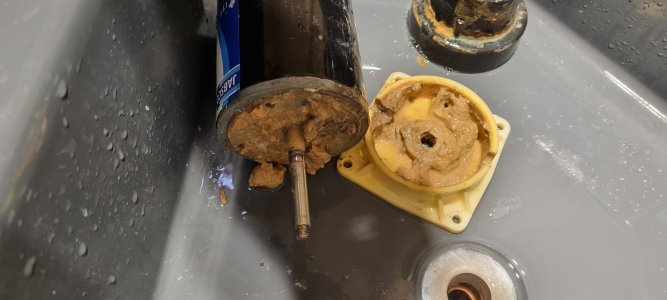

I used to have 2 of these on boat. Unfortunately as you have seen the motor being right at the bottom makes it difficult to see the leak. One leaked and soaked the bilge. I ripped it out and fitted a Tecma and cleaned and disinfected. I then look it apart and could see that it’s a seal between the motor and pump section that leaks. I stripped off the other motor/ pump and used a new seal kit in case that one started leaking. It’s very easy, less than an hour start to finish. I’ll replace the other pan in time. My only issue with the Jabsco is it is difficult to see when they start leaking.

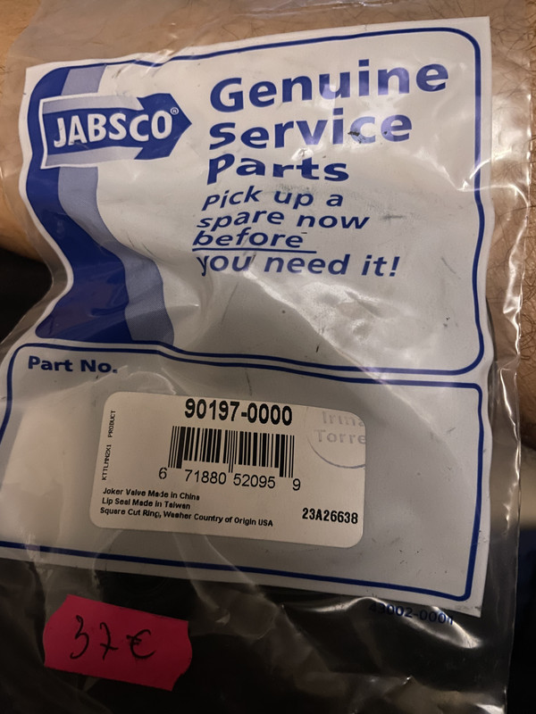

The leak is small (so far) and only when it is flushed. Because it is a wet room shower/toilet all leaks are safely contained in the shower tray. I have the kit (I hope it’s the right one….the O ring is so fine)

It’s part no 19 on the exploded diagram posted earlier. It’s a lip seal with an internal spring that is pushed into the pump body. About 20mm diameter with internal spring, it’s not an o ring

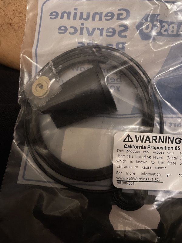

As carefully as I possibly could I removed everything, cleaned it thoroughly and replaced the seals….and now it leaks worse than ever 😳😧
The very small spring loaded O ring that goes on the motor shaft was impossible to fit..but I thought I had it in enough…when I gather enough energy I will try again…perhaps take it to my workshop and press it on…
Any suggestions??? and please remember this is not the gag forum 😡

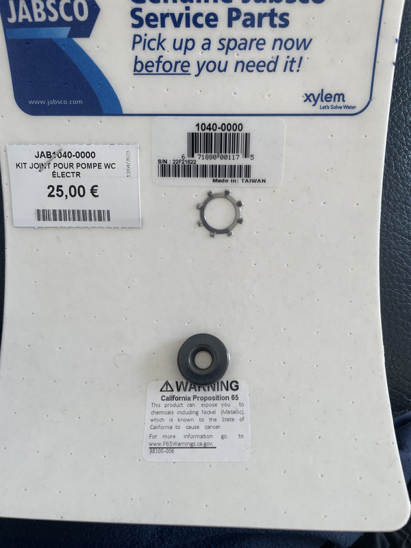

So I bought a new seal..this one definitely matches the serial number although it looks identical to the one I fitted this morning.
But what is that other part ? It’s not in the original set up, nor is it in the parts diagram
I can only assume it is to fix a problem …but where would it go?

Ok…I’ve solved the mystery of the extra part..it’s for the standard electric toilet not the quiet flush model that I have
